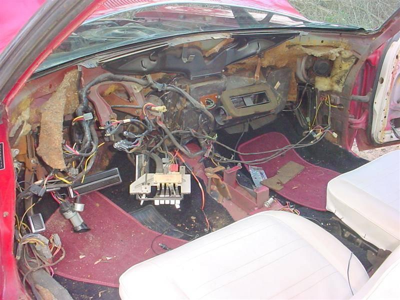

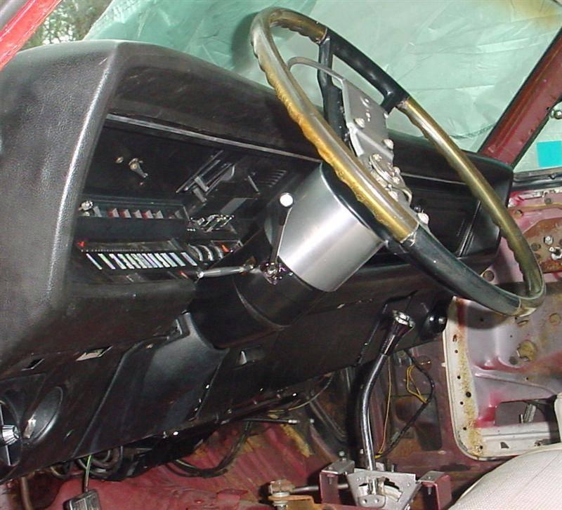

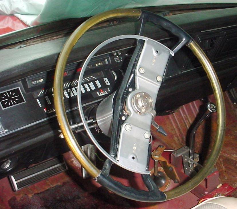

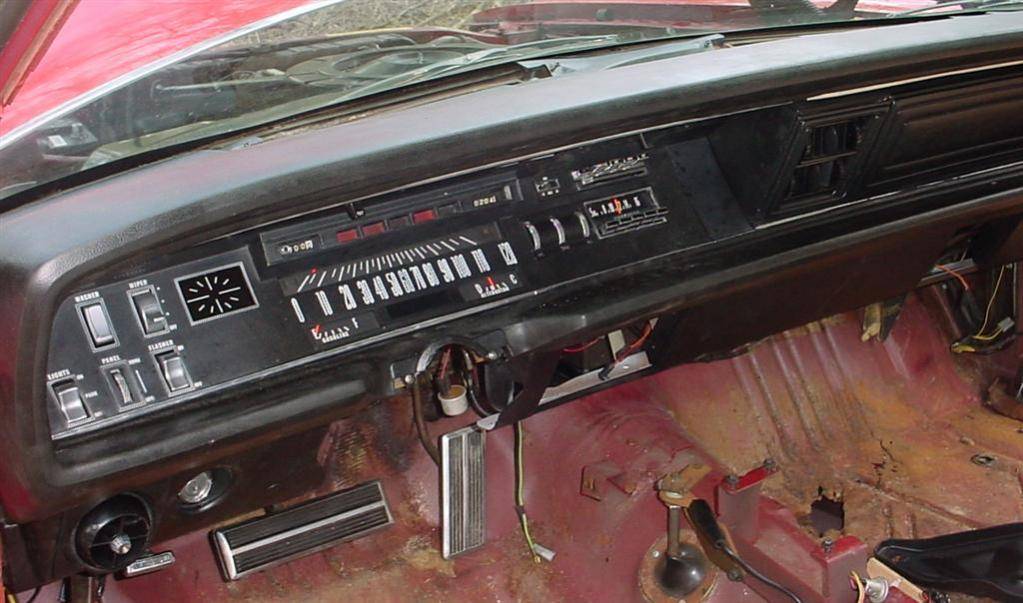

Well.... The cosmetic upgrade on Jazebelle is coming along nicely. I started out replacing just the insturment bezel to repair some past owner damage... and ended up removing and upgrading the entire dash, pad and frame, steering column and wheel. (It's tough being anal retentive). All's back in place now.

Exactly right...!!!! I shoot digital pictures of everything from every angle as I go. It's hard enought to remember where I parked the car..... let alone how to put it back together by memory.
The tech support here is fantastic... thanks guys... and the sharpie paint pencil is what I used to freshen the MPH markers on the cluster.... Plus... 1/4" foil tape for the chrome around the parameter of the dash.

You'd think so..... I really struggled putting the assembled dash back in place, (everything assembled with the harness in place on the bench). Next day I took another look and found the steering column support studs were not in the proper holes. I had to take the entire dash loose again and remove the studs to get it in the correct location.
And I never mentioned the heater box.... Once the dash was out I found the fiberglass box nearly busted in half from a past attempt to replace the heater core. It had to be removed, clamped and with the help of a lot of JB weld..was repaired and reinstalled.

It's not as hard as it seems. With the help of a friend you can have the steering column and dash out in a hour or two.
There were only 6 bolts holding the whole assy in place. I disconnected the connectors at the bulkhead and removed the fuse box, (after unpluging everything at the left A-pillar), If your car has A/C there is a 3wire plug in at the heater control with a black wire.... Remove that wire from the plug connector and all else will stay with the dash. You'll need to disconnect the vent cables at the vents also. Access to the dash pad nuts is easy on the bench.
Take lots of pictures during the process.... and it helps to have a factory manual and/or a parts book handy.
