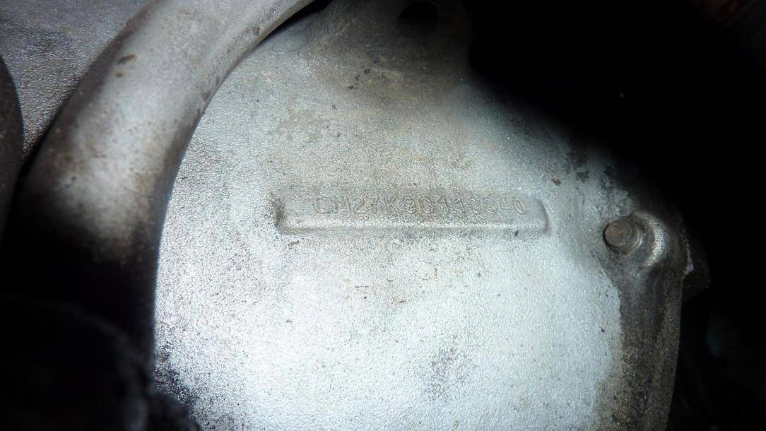

Hello,
Does somebody knows why the engine of my car has a missing Engine ID number?
Is this exeptional or usual...?
Thanks!

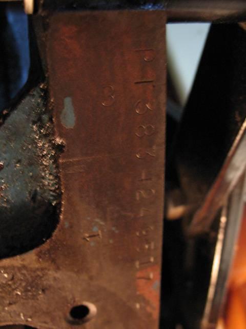

Beginning in 1968 all Mopar B&RB engine blocks have an engine serial number stamped in the left side oil pan rail at the rear corner under the starter opening.
Sample Serial # PT44028650001
Location Engine ID number 69 chrysler 440
Do you have a picture?
Thanks!!!!!
Here is an example of the stamping on the pan rail.
missing numbers

Some additional info: My 69 chrysler 300 is assembled on 30th August 1968! The engine is casted then months before this date. So its a 1968 440 in fact...
The casting date will always be several months earlier than the build date of the vehicle. The year of your engine (assembly specifications per year) will be specified by a stamping. The boss on a 440 adjacent to the distributor would have the year of your engine as E440 for a '69, D440 for a '68 etc.
Also the VIN stamping on engines was not done until '67, and the early VINs including some '68s were on the rear of the block on top of the bell housing flange.
