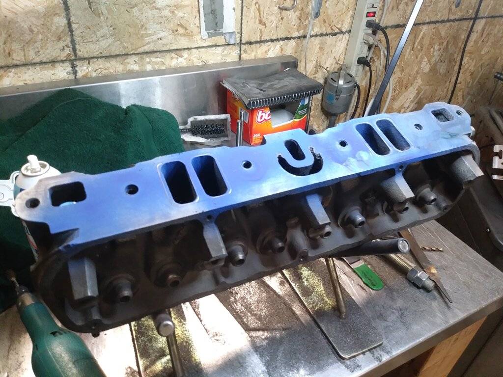

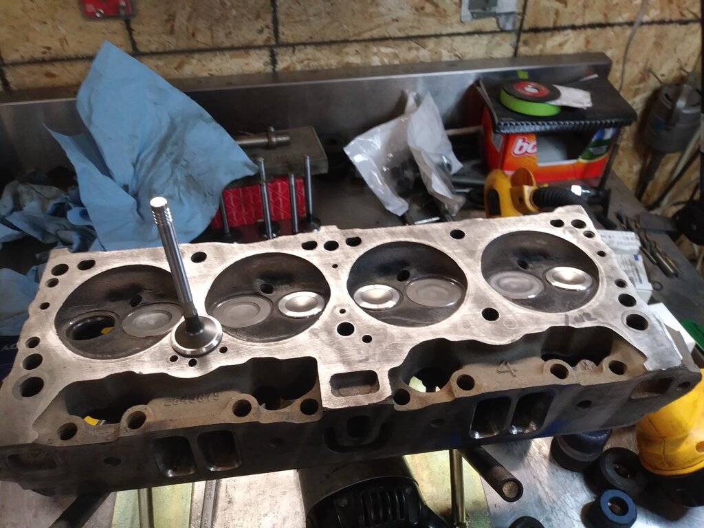

As most of you know,I have a 73 Satellite wagon with a 318.
During the rebuild,we did not install hardened valve seats in the original heads.
Not necessary with the low compression.
Just new valves with a back cut and 3 angle grind,opened up the bowls,some massaging in the ports,port match the intake and gaskets...
Basically worked with what we already have to improve torque and a cleaner burn..
