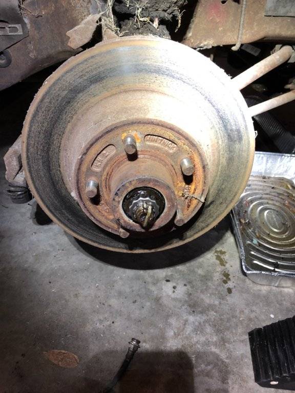

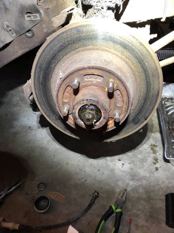

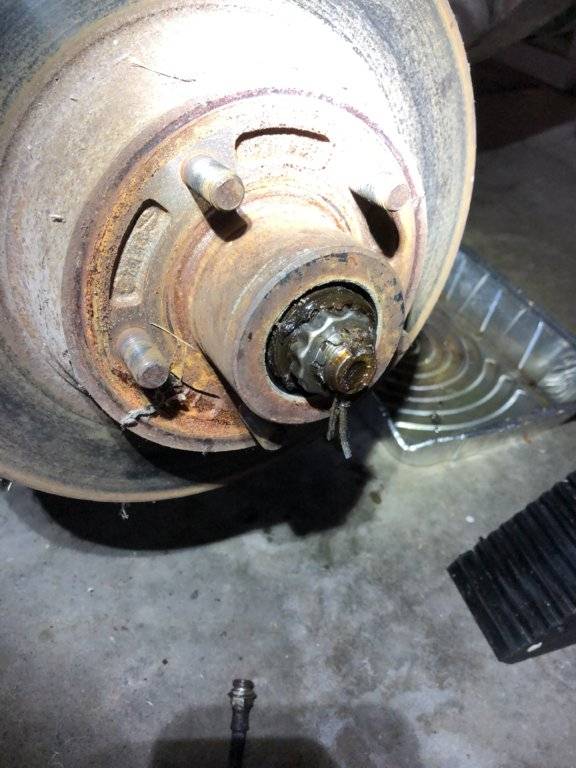

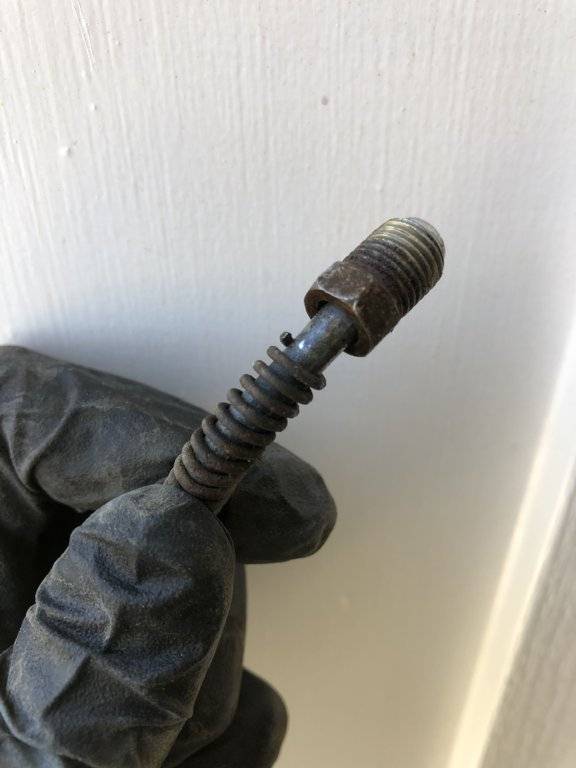

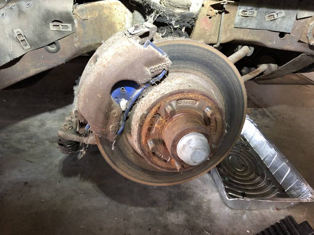

The front flexible brake hoses were held on with clips that were practically cemented in with a mixture of dirt and grime. Both required a liberal application of Deep Creep followed by rotating them with pliers before the clips came out.

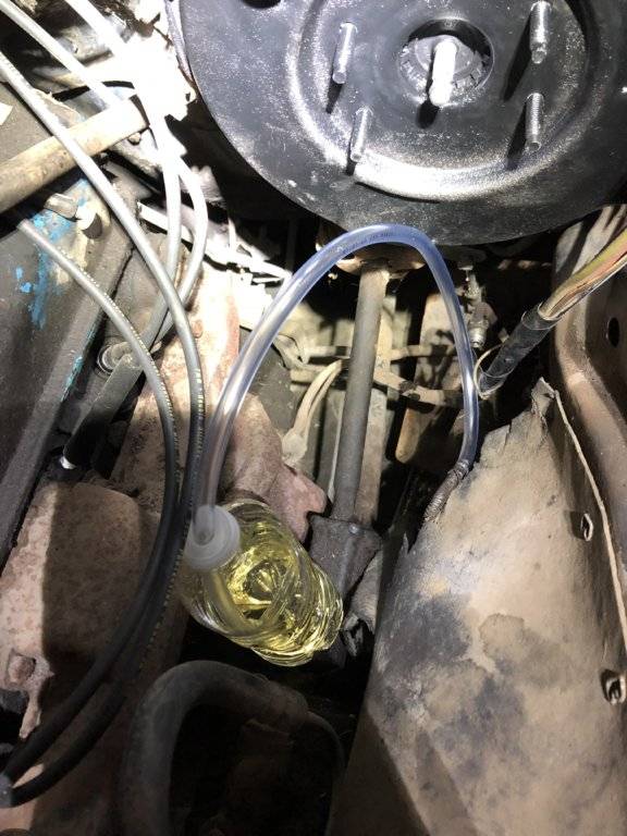

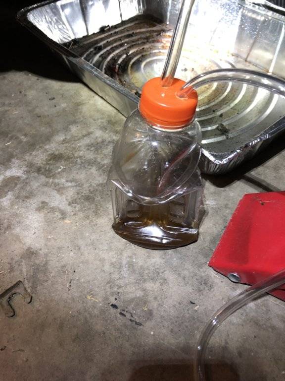

Used a cheap vaccum pump from Harbor Freight and a gatorade bottle to suck the junk out of the front brake hardlines. I thought the gatorade bottle would be rigid enough to withstand the vaccum and give me more capacity than the tiny little bottle the pump came with it. It wasn't so I ended up switching back to the little bottle.
Since I have the brake valve off I hooked another bottle filled with brake fluid up to each line and pumped it through until the fluid was clear, which it eventually was.
