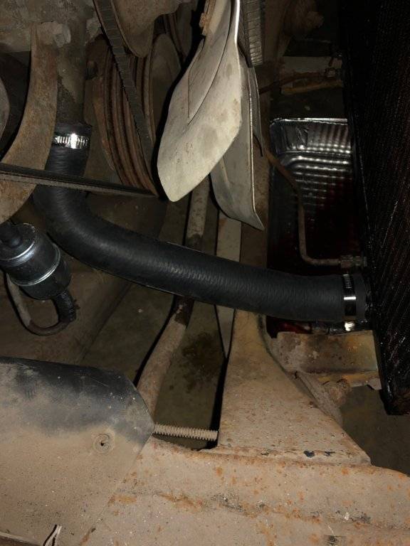

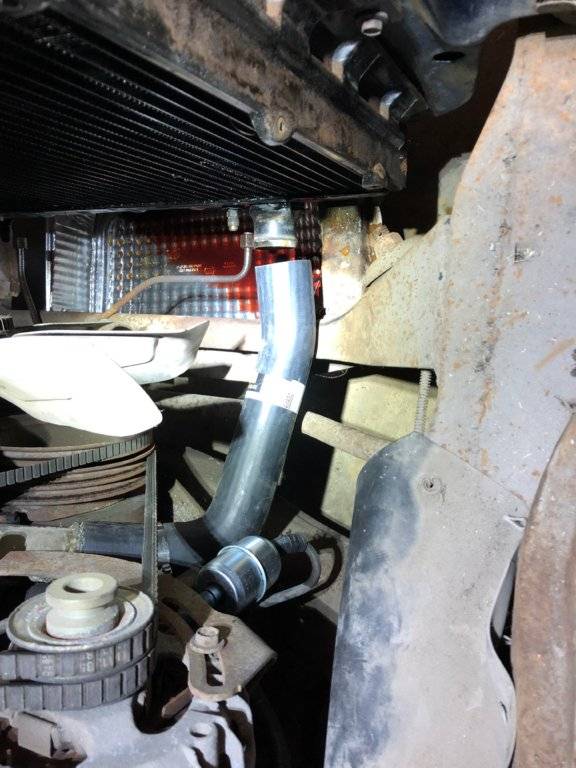

    Today I installed a radiator I had re-cored locally by B&L Radiator nearby in Alpharetta GA. Also installed was a new upper and lower radiator hose. The upper hose fit perfectly. The lower hose that was listed as fitting was two inches short as seen here.
    There were no other lower radiator molded options so I wandered the hose isle at the parts store before settling on a Dayco Length E 71901, which I cropped about 8 inches off of.

    It fits fairly well.

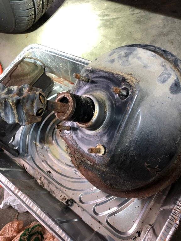

    There was mucky fluid on the piston extending from the brake booster. Thanks for the tip on avoiding the Cardone reman.

    I checked Inline Tube's site for a bunch of different formals and came up with nothing. I'll give them a call Monday and see if maybe it's just not listed online.
    NAPA only lists a flex hose for a lower radiator on a small block (everyone has one for the big block). The only place that lists a molded hose for the smallblock is RockAuto as Continental branded part, which is what you see pictured.

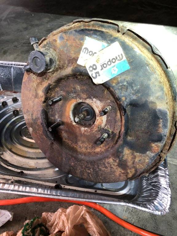

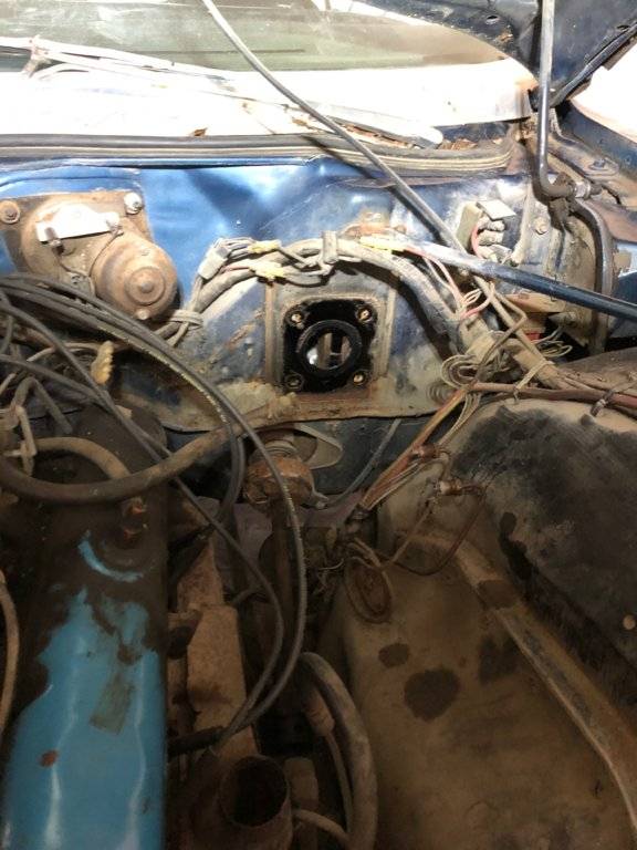

    Brake booster is removed. I thought this was going to be easy but the four bolts in the firewall require you to get into some unnatural angles to get them off.
    • Like Like x 1

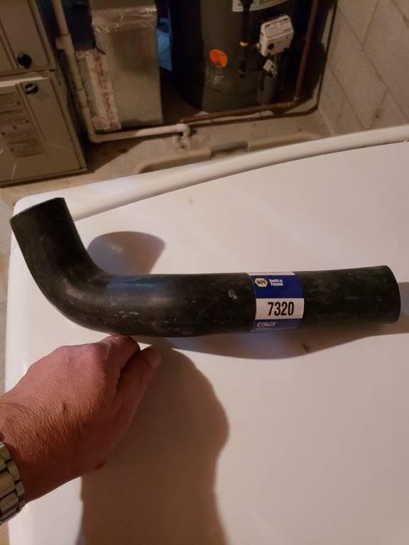

    The bottom radiator hose from NAPA is 7320.
