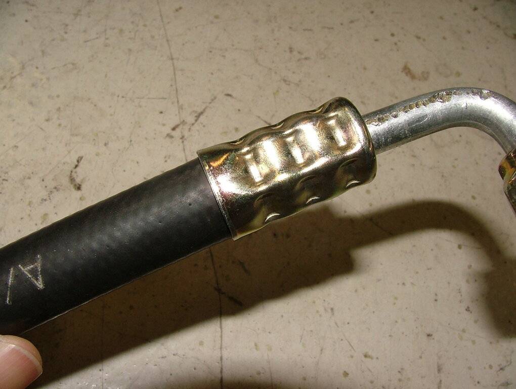

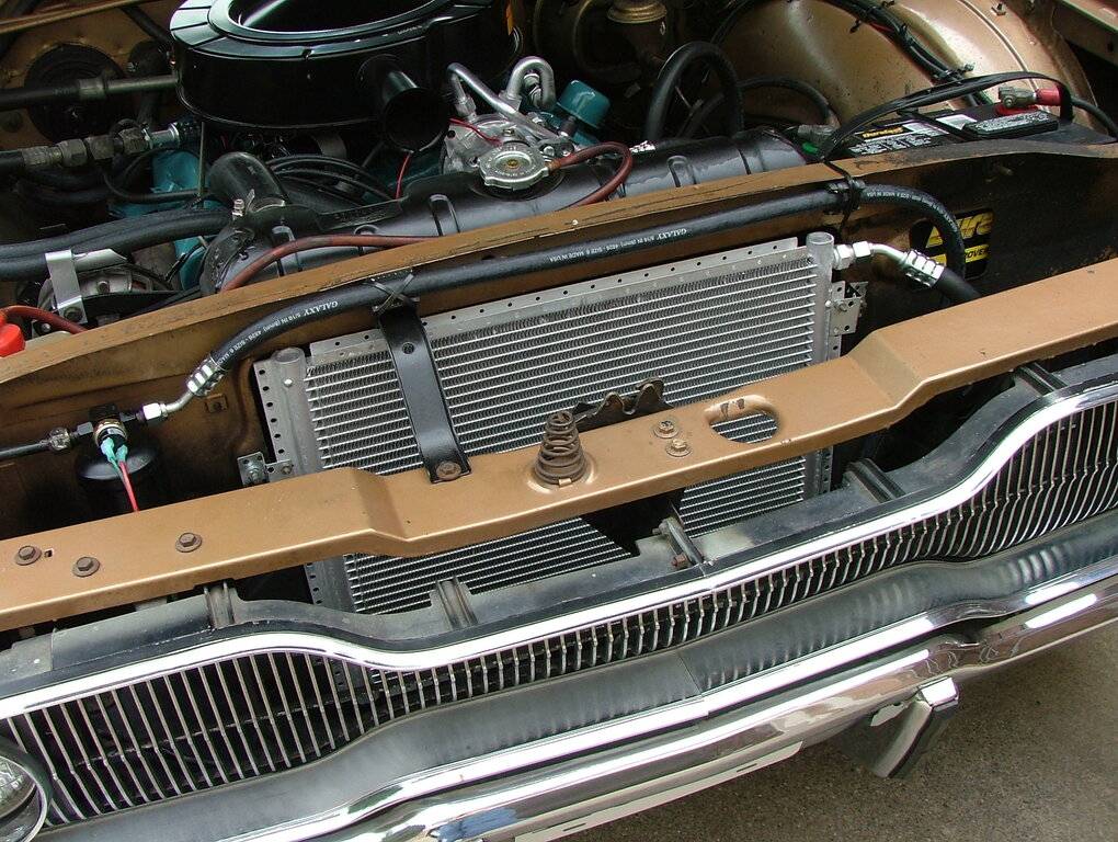

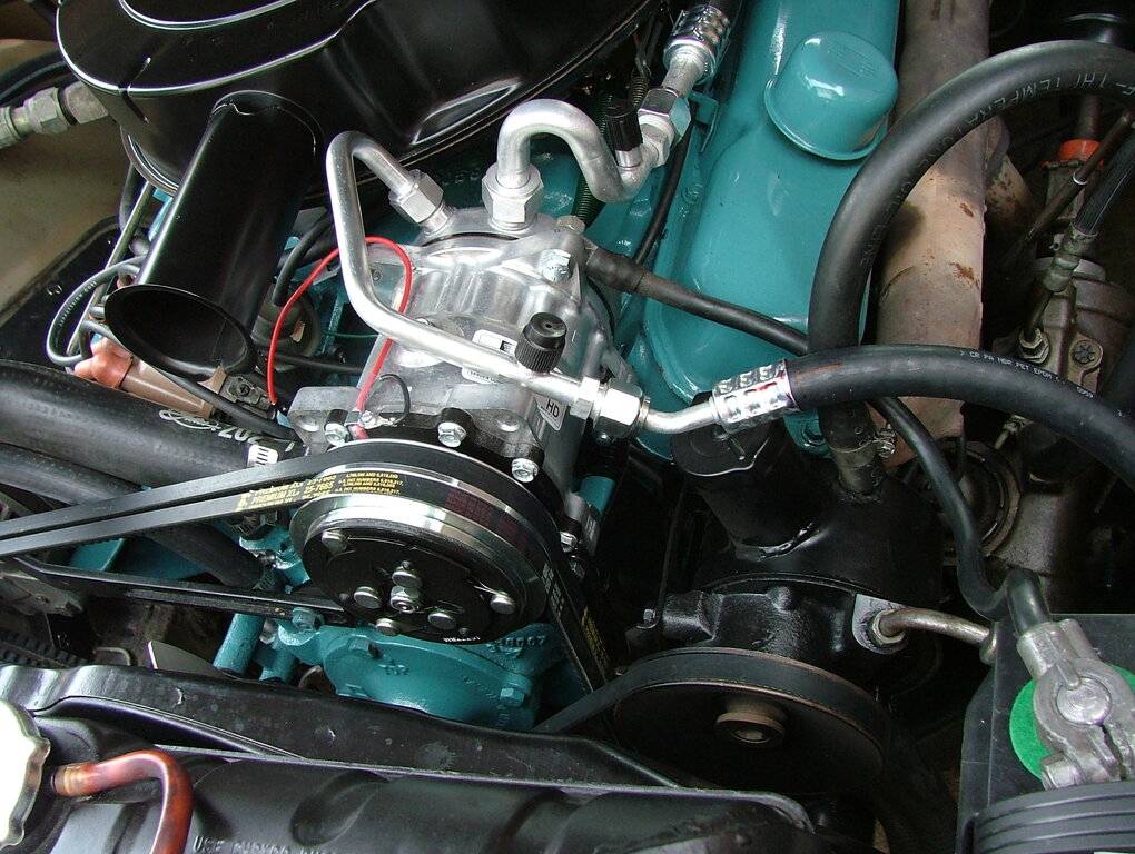

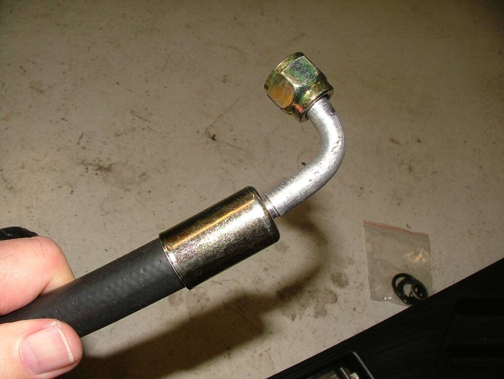

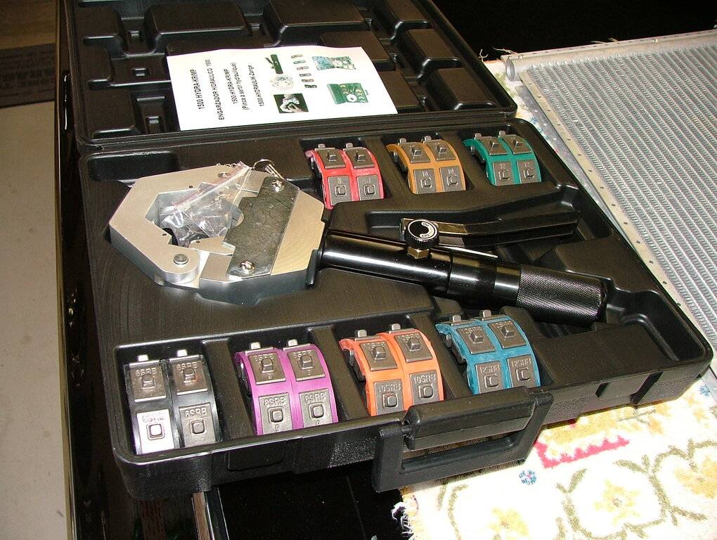

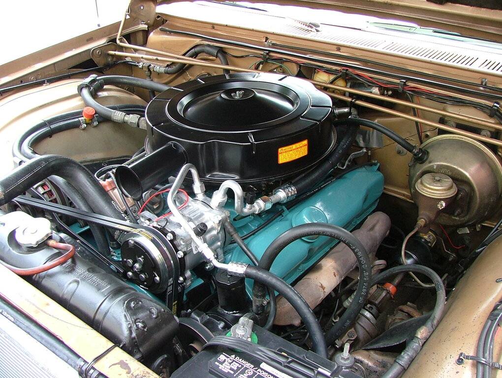

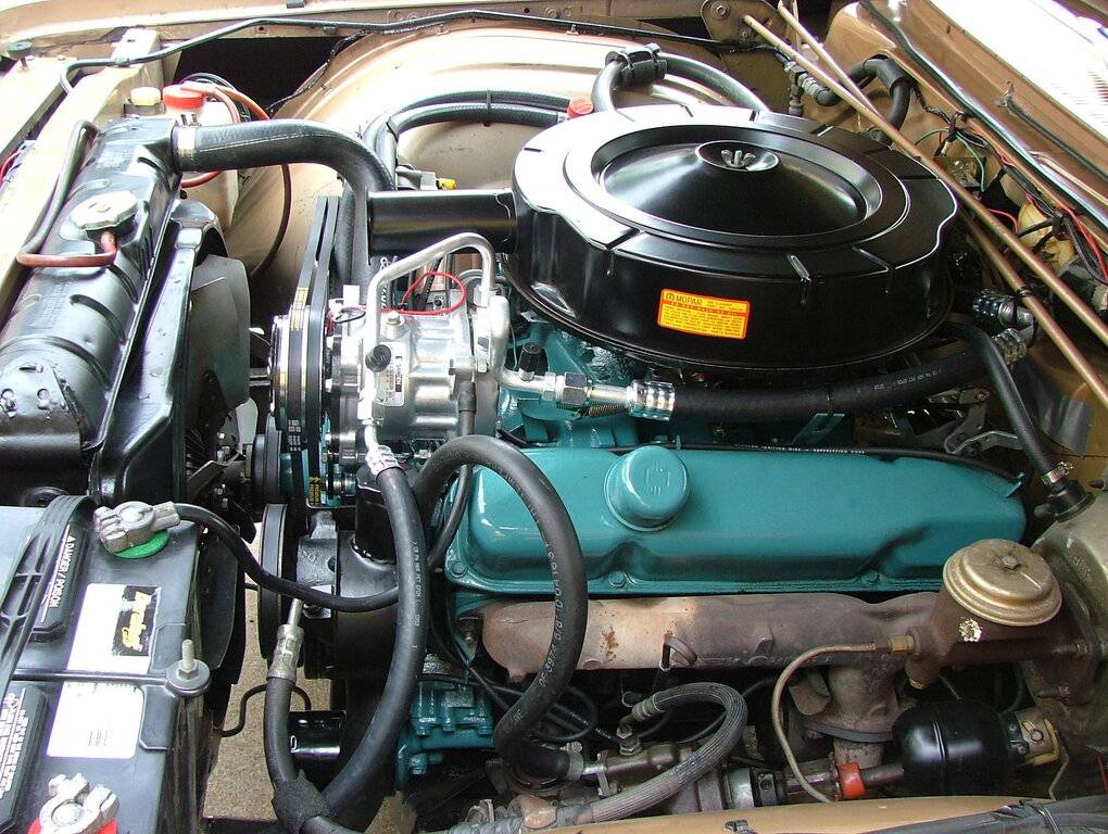

Making your own hoses is surprisingly easy, all the components are available from Cold Hose and other vendors and you can easily purchase a hydraulic crimping tool on Ebay. Here is my system after completion, it would help if you still have or can get some of the factory hardlines.
Cold Hose - AC Hoses, Hose Kits and Fittings
Thanks for that link! LOTS of needed things in that website! Your installation/conversion looks great, too!
