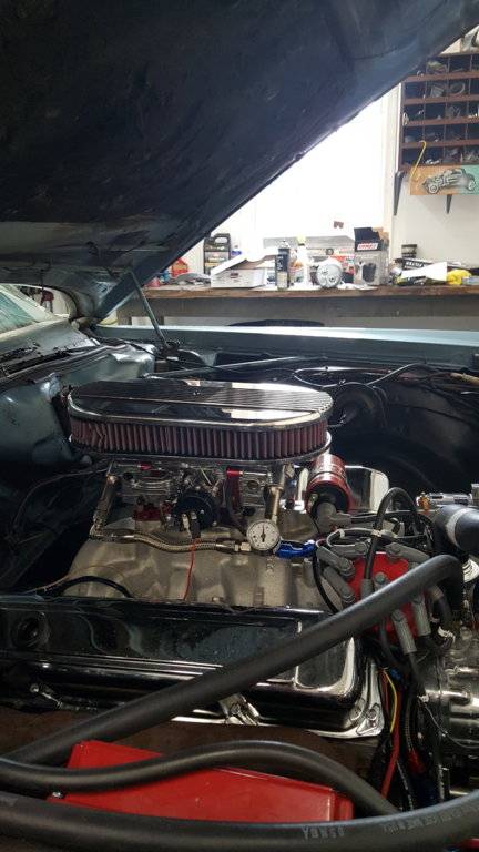

    I have pretty much the same setup and horsepower with my 400 in a 78 NYB. I'm having pretty good results with a Holley Quick Fuel 750 SS carb.
