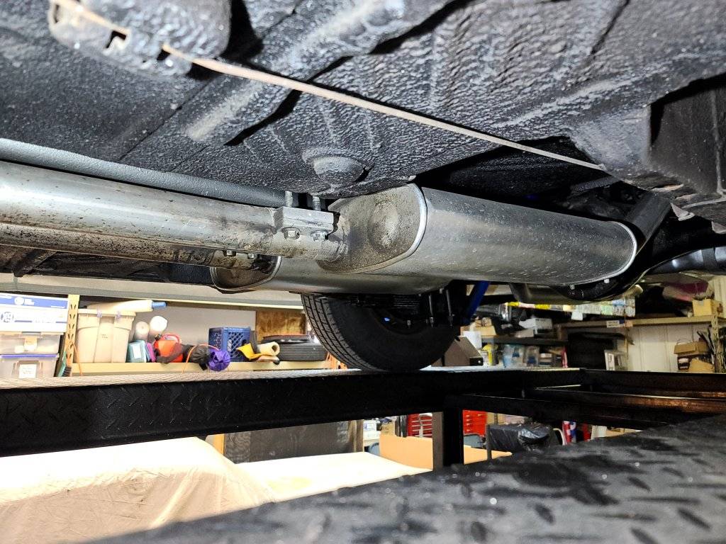

Same at the back as other 69/73 Cs. It was tight when I finished the cutting. The band clamp saved the effort. I will try to get a photo.
The other option is to have the TTI pipes re bent to a more traditional factory bent. TTI went with the 45 deg angle to reach the shorter Dyno Max muffler.

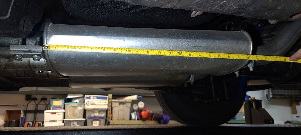

Walker Exhaust 18381 Imperial/NY/Newport 440 single exh system 1972
Case length 25.0" Case height 4.25" Case width 9.75" Overall length 29.0"
Inlet pipe 2.50" offset to inside Outlet pipe 2.50" center
Oval shape
Specific fit
This is what I put under my '67 Newport 383 car, single exhaust. With the pipes in front and behind it, it fits like it came that way. Looks as OEM as anything else I've seen, even factory OEM Chryslers of that era. Just my observations.

On this system, the over-the-axle pipe necks-down to 2.25" diameter from 2.50", with the resonator and tail pipe pieces or resonator eliminator pipe after that. Sound is as expected for an OEM-level system (with the resonator eliminator pipe).
On this particular muffler, it might not be an exact match for the OEM Chrysler muffler, but the length is an exact match, so it goes where the OEM production muffler went. Which works for me.

@darth_linux Opinions on the sound you're looking for should depend on personal preference, but for me it depends on the car when selecting the right sound.
I think exhaust sound on Imperials should be quieter than other models, but my 72 has dual exhaust and is slightly louder than I think it should be. My 69 Imperial has single exhaust and is quiet at idle and when out on the road. Since the new resonator was put on, it's even quieter than before.
On the other hand, if looking for a slightly more aggressive sound, TTI 2.5" with the Dynomax mufflers will get you there, and the fit is pretty darn close to perfect out of the box.
When installing the TTI exhaust, I did need to add band clamps on the 71 NYer's set up in front of the mufflers to make the TTI C Body kit fit properly. I suppose it depends on the wheelbase of your car and what size clamp will be needed. From what I experienced with TTI, the only C body kit they offer is for 122" wheelbase. My 71 NYer is 124" and Imperials are even longer at 127", so the band clamp was a necessity unless welding in additional stock to their kit.

Walker # 17747 is the equivalent to the Hemi muffler. 19 inch body with overall length 25.75 inches.
Thats the closest you will get to the sound of the factory mufflers.
used on borh B and C body cars.
