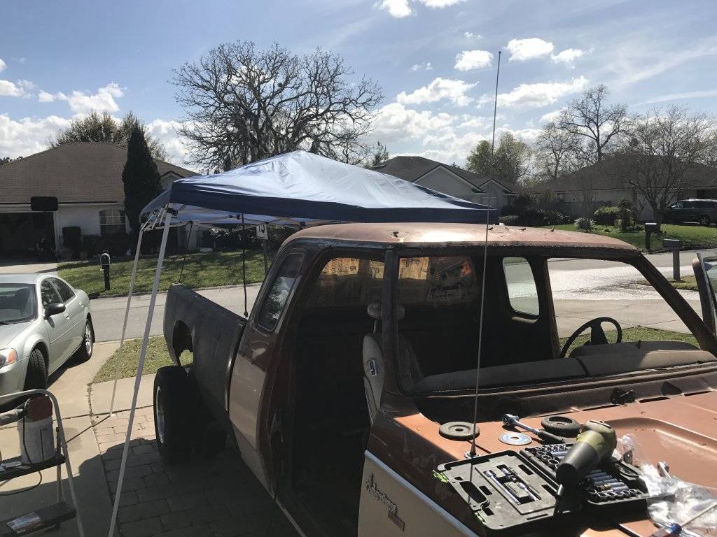

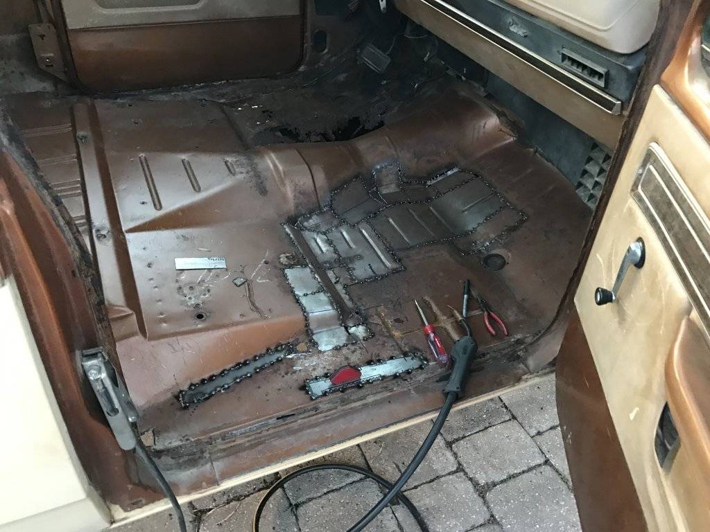

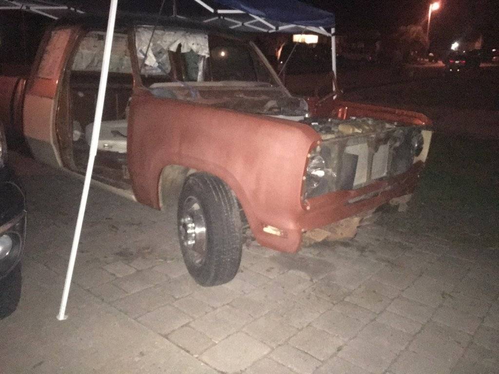

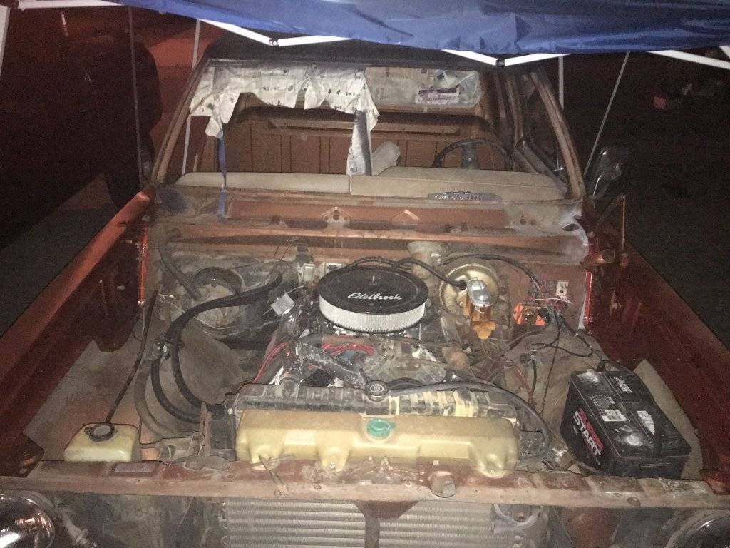

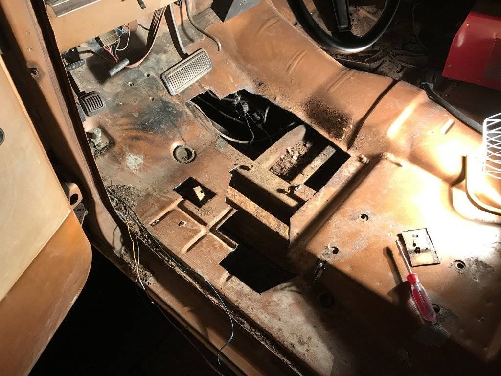

Late nights working on her. Gotta get the bed pulled soon. Still need to figure out what to do about the drip rail... as well as finish the floors up. Bunch of parts, and paint on the way. Although, I won't be painting this one! Let a buddy do it.

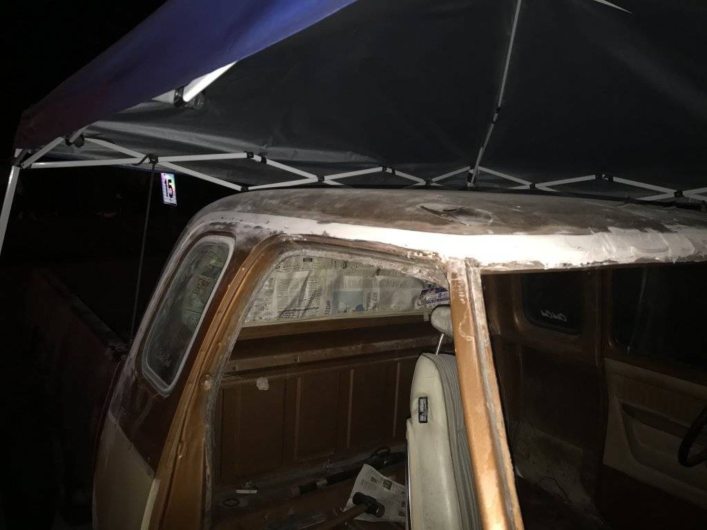

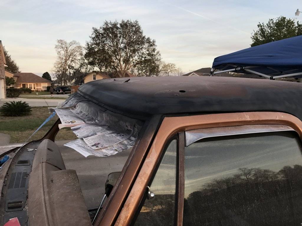

How did you put the creases in the metal.

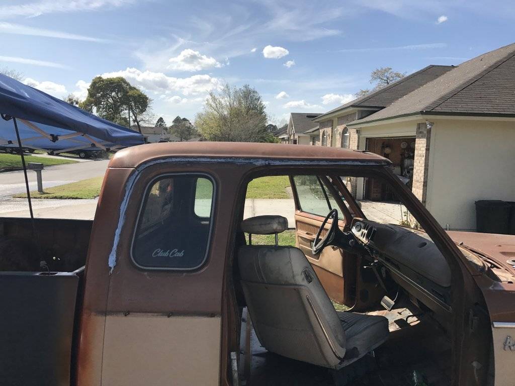

You gotta keep the cab lights. Since it is a 2 WD put some long running boards on and light them up along the whole length.

Cab lights are staying for sure! They are one of my favorite features of the truck! Idk bout the running boards lol...

It does suck! But a blessing at the same time. The trim would be a lot of work if we kept it. I think the the truck will look good without it too.

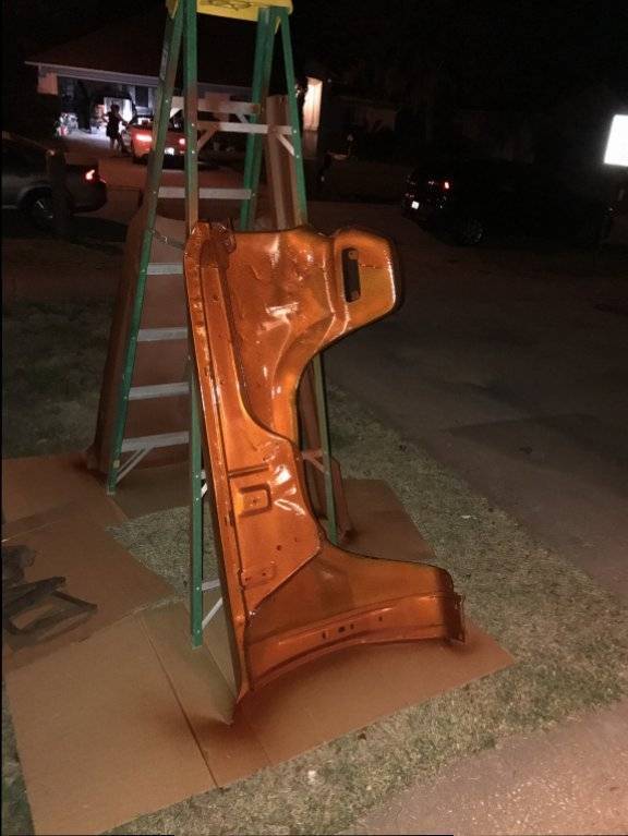

The diff paint schemes are a great idea. That was a thought with this orange. It will be a lot of it, and nothing to really break it up. At the same time, I think this orange can pull it off by itself.

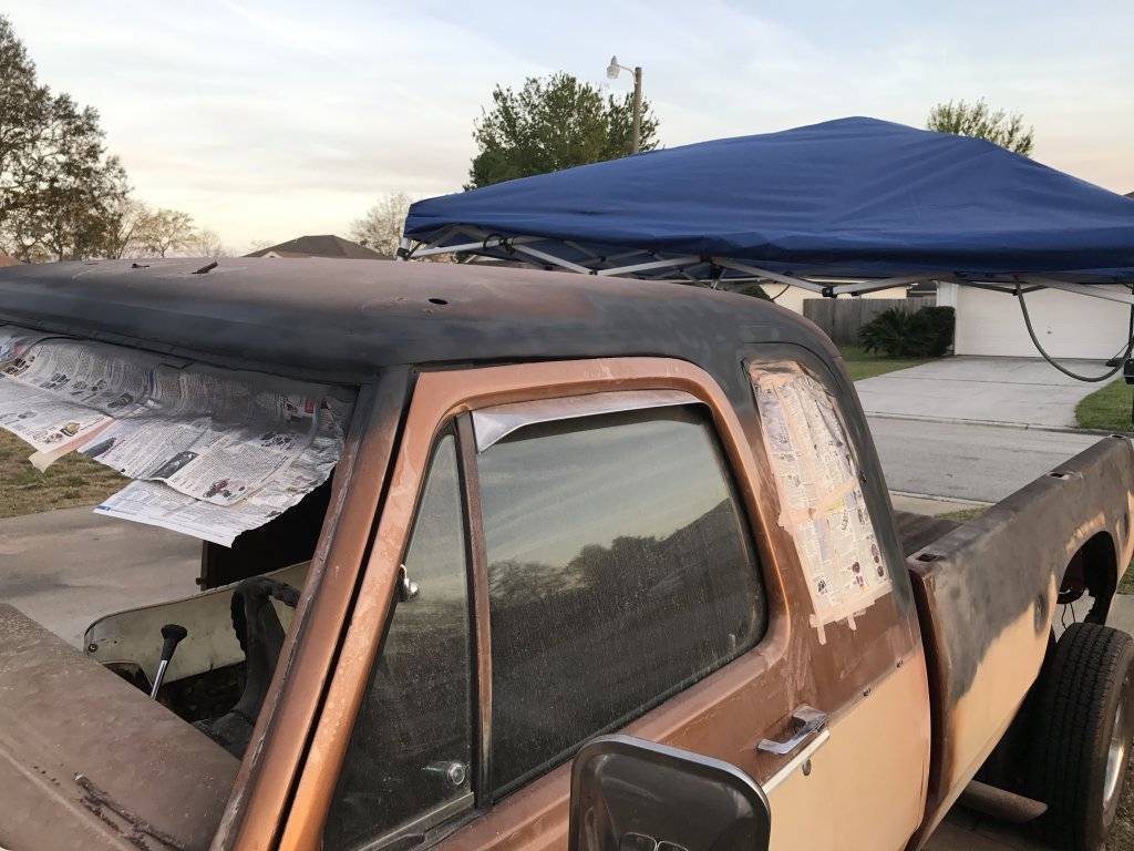

This truck is looking great!!!
Thanks!
Used a bead roller. Picked one up a couple years ago from Eastwood. One of those tools you think is not needed, and barely gets used. But damn sure comes in handy when it is needed. This is the 3rd car it's been used on now.

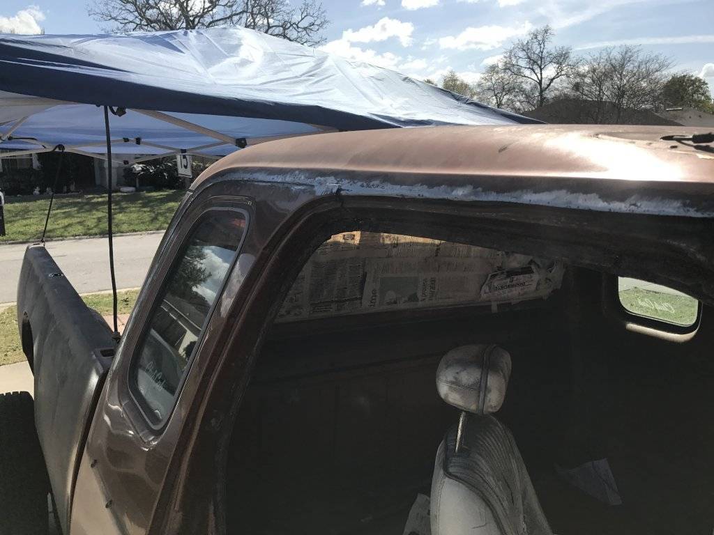

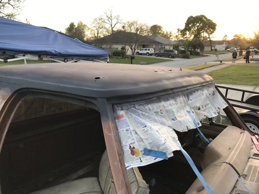

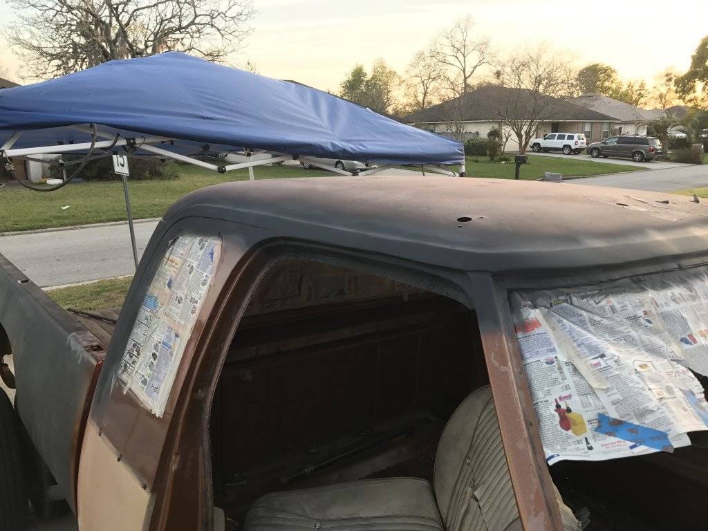

Not a ton to report, but deff been busy. The drip rail delete has come out much better then I anticipated. Still have a couple spots left to perfect, but am pretty happy with it.

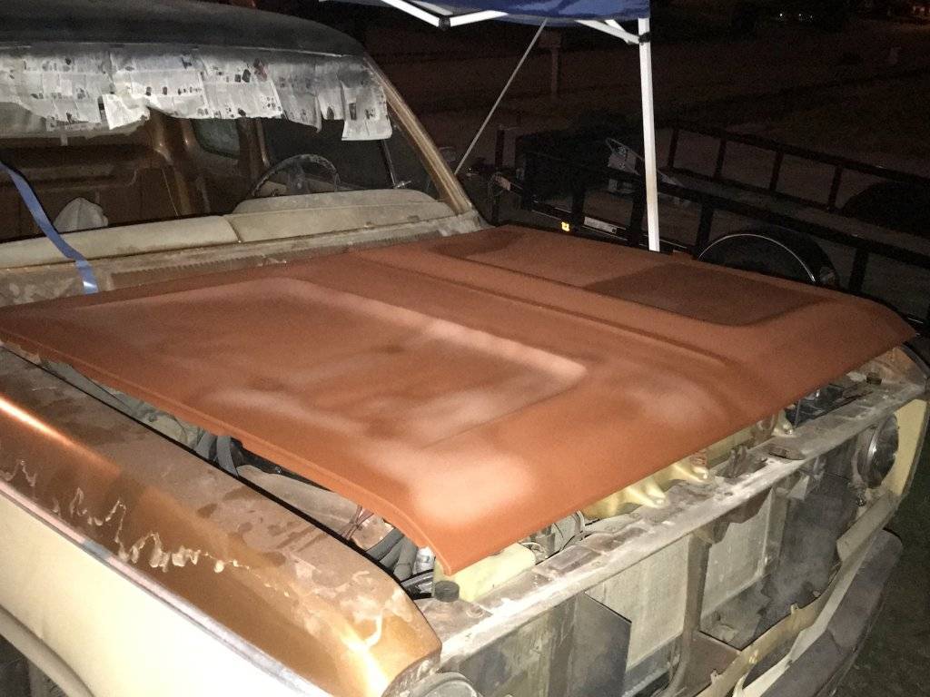

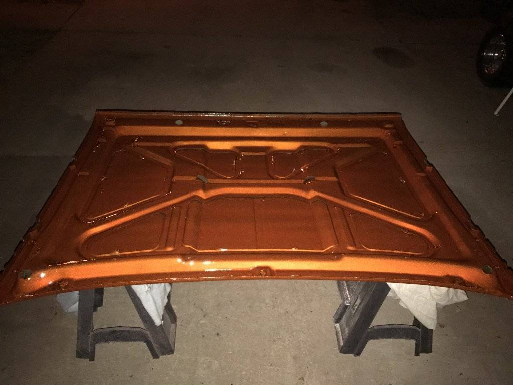

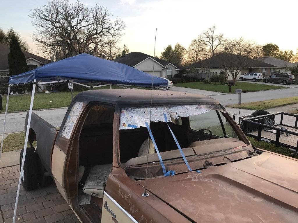

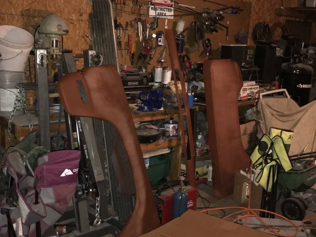

Did some body work on the used fender we got, and have it looking good. Pulled the hood, and did a little work to it as well.

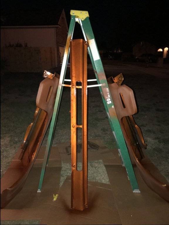

Picked up a gallon of red primer, to get everything to match correctly now. Got the whole new front end in primer, and got the back sides of everything painted tonight. A few runs here and there. But it's on the back sides. Just trying to Mach factory lmao

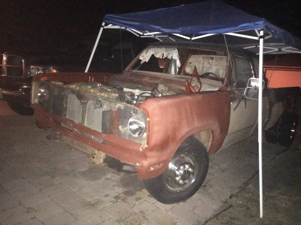

New front end is on. Body lines could line up better. But what do you expect from aftermarket pieces. Got the hood on today. Hopefully get the doors tackled this weekend.
Amazing how much better it looks without the banged up front valence!
