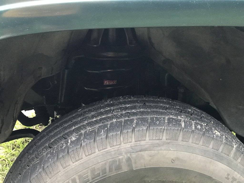

Hell The joints were even the weak link in the half tons back then. I’m amazed these ones lasted this long.
Carli suspensions makes an upgraded super heavy duty set, that is supposed to cure any, and all ball joint troubles on these trucks. I can’t swallow the $900 price tag that comes with em though!! Hopefully the new normal replacements last as long as these did lol
Im amazed at how well the truck was driving as well, after getting all of this apart!

I installed the SpynTec hub kit on my '01. Had to do ball joints anyway, I went with the XRF's. View attachment 190747

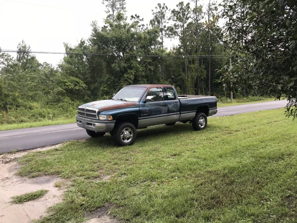

Finally got the old tank back on the road!
New-
Ball joints
Hubs
Shocks
Sway bar bushings, and end links
Rotors turned
And new brake pads
Feels much better going down the road. Ill get some new tie rods here in the soon future to finish it off.
So are you going to just leave it alone and drive it or is a paint job in it's future?????

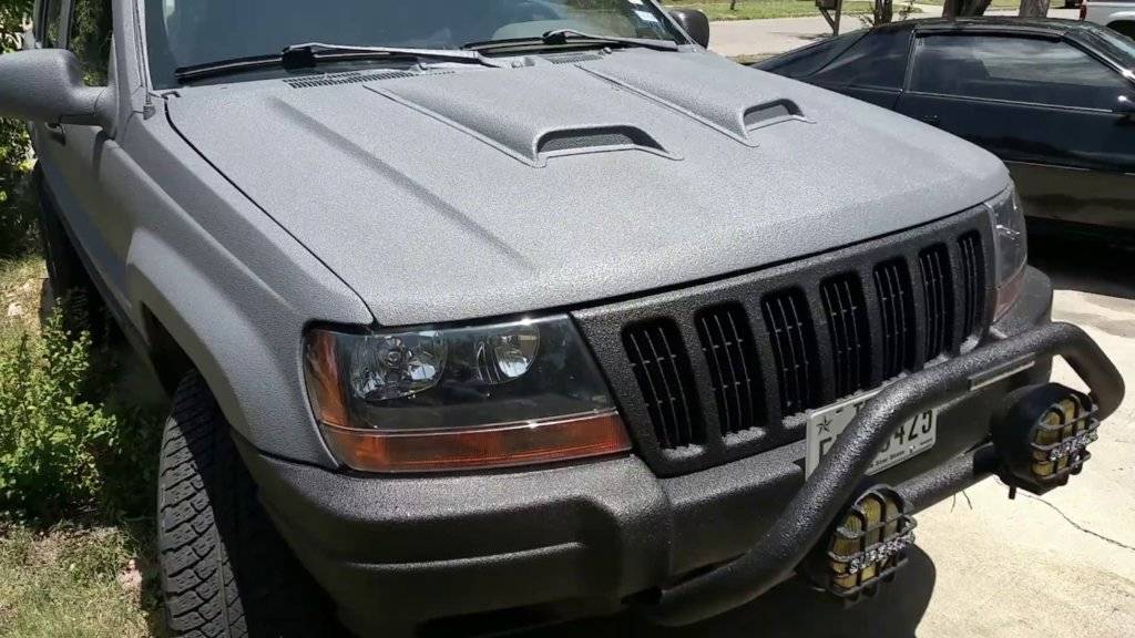

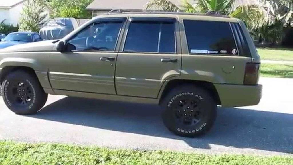

I believe this one is going to get raptor lined after a littlebody work. Much cheaper then a full blown repaint, and a lot more durable.
They sell it in a tintable versions as well, and claim it has a real good UV protectant in it.
Thinking either an olive green, or gray.
Seems pretty popular with the jeep crowd.

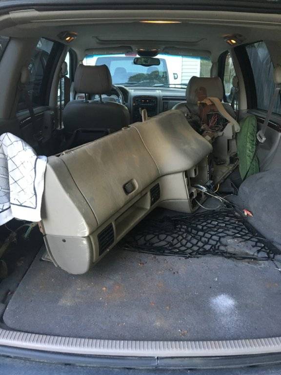

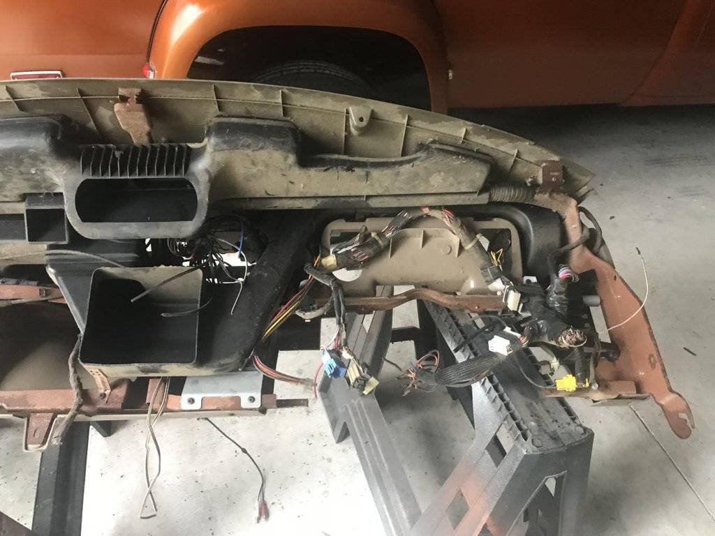

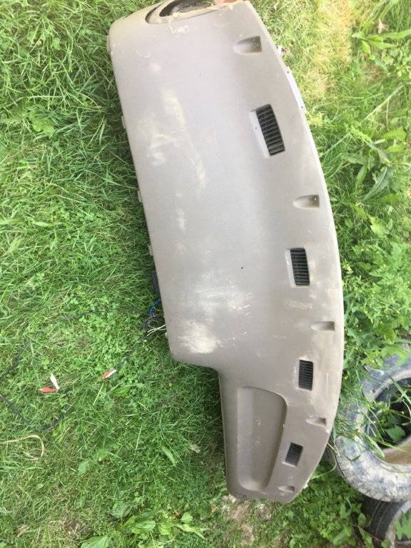

My buddy just sent me these pcs tonight. He hasa dash for me from another friend, that has had it sitting up ij the rafters of his barn for the last 15 or so years. He parted out a truck back then, and has had this ever since. Needs a cleaning big time, but is a crack free northern dash!! He is coming down the first week of july, so should have it then

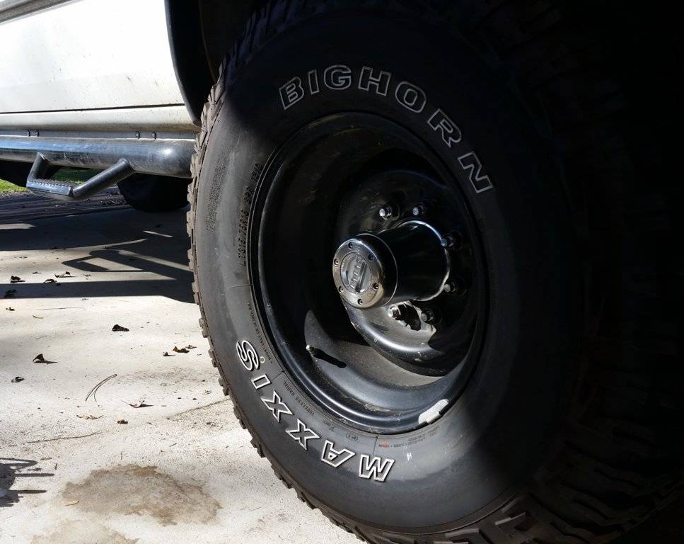

Did they put 15" rims on that?
High flotation tires. With that combo, if you bog down, you deflate the tires and get out of what would have been definitely a no-go situation. Reinflate when on solid surface again.
But he's obviously a wannabe. Biggest obstacle that truck will ever encounter will be the owner's Napoleon Complex.
cant do it!
Thank you.!!!!!!!!!!!
I know about the low pressure when wheeling, I just would have thought a larger rim would be available.

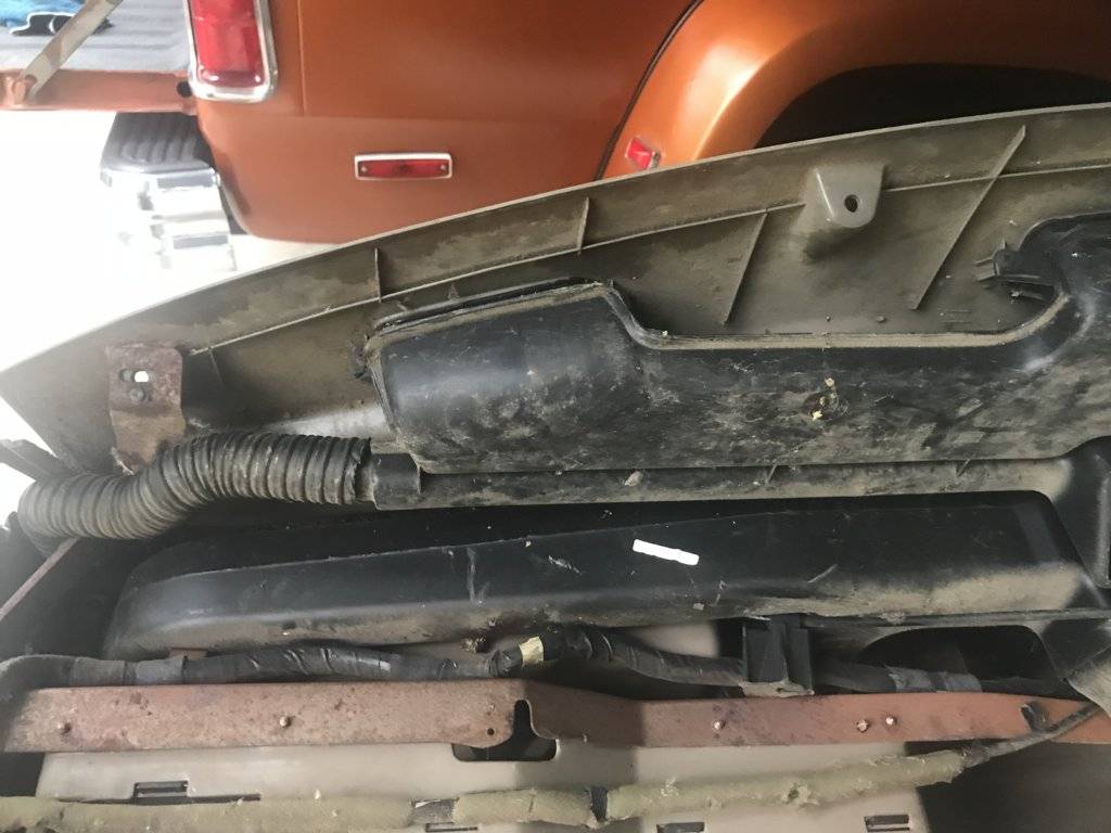

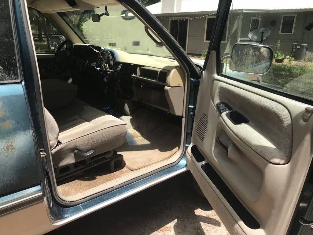

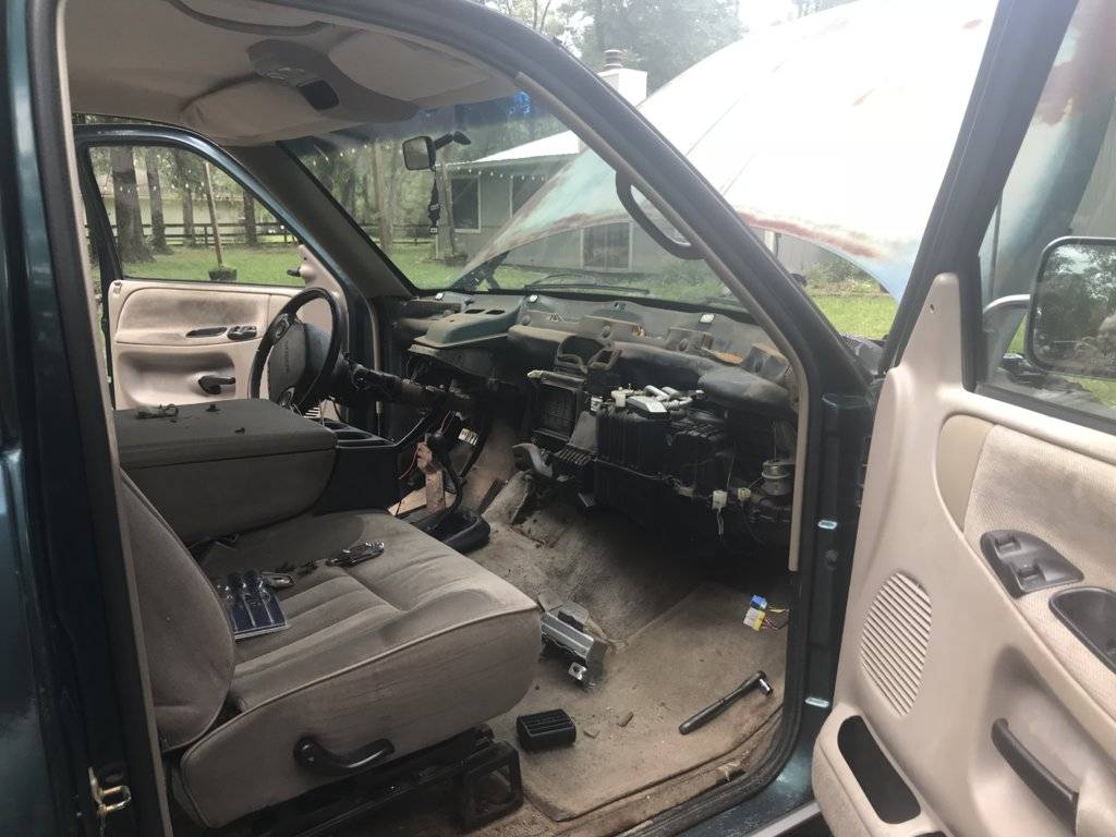

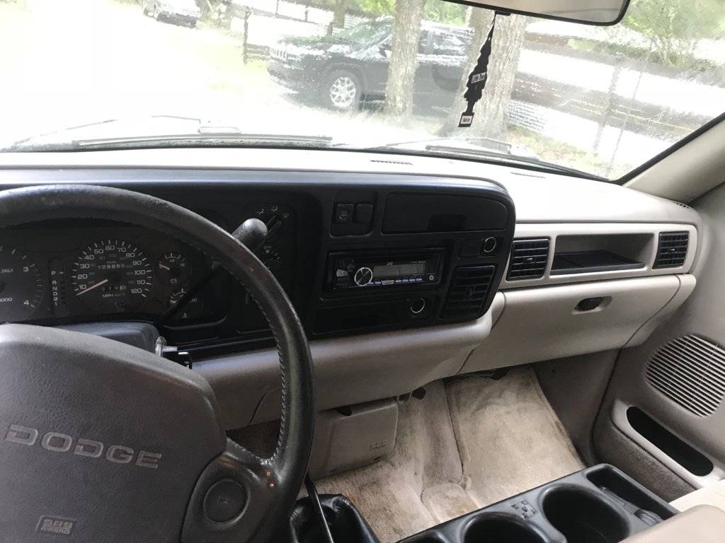

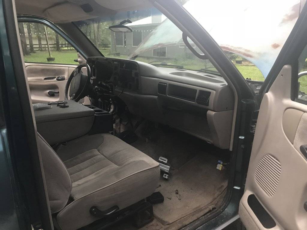

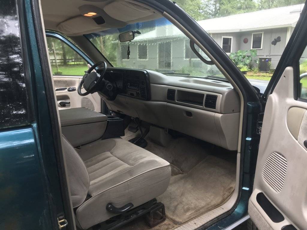

Jake showed up with the new dash the other day. Got her all buttoned up today, after a good cleaning. Damn what a difference!
The “new” dash is in amazing shape for having sat in the loft of a barn the last 20 years. Has a couple tiny rub marks, but can’t even see em. Had to clean out the mouse nests, and what not out of the glove box/vents. I transferred the wiring harness, and other bits over from the old one. Also bought a couple pieces for it off of ebay.
Tried using the factory radio that came with the truck, but it is toast. Went out and got a new jvc head unit today. Speakers sound pretty decent for being as old as they are.

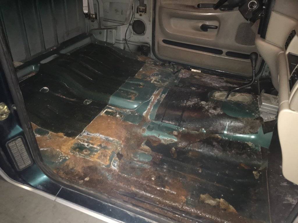

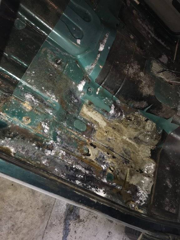

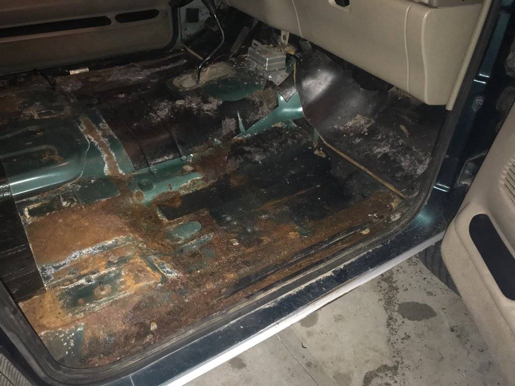

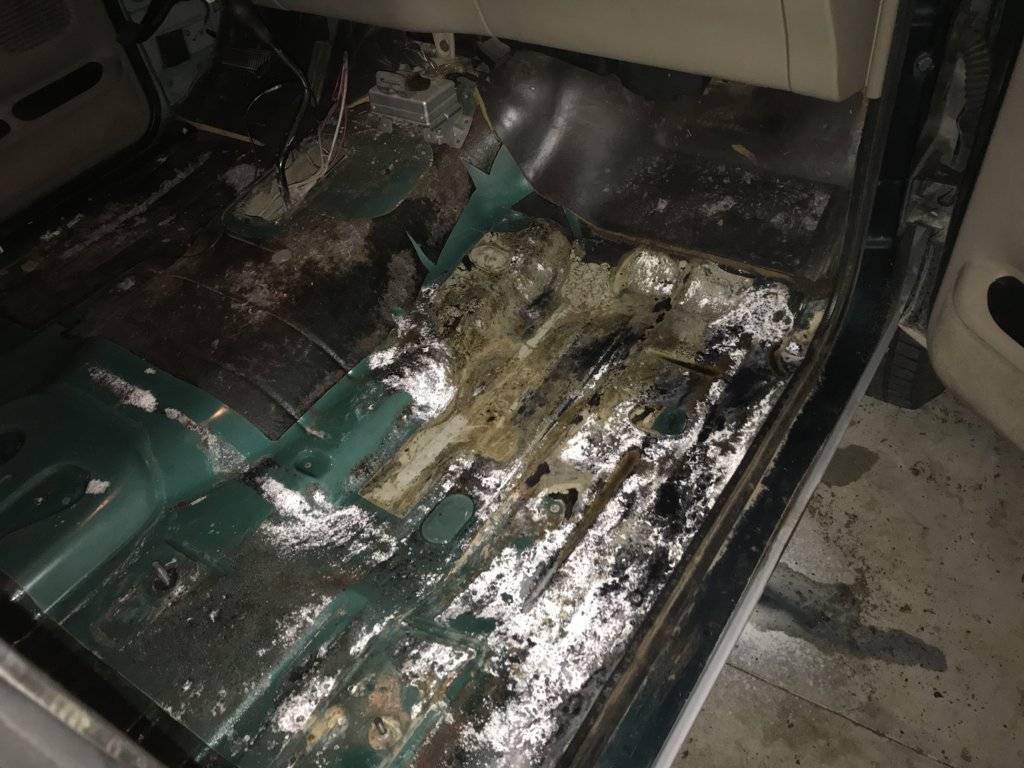

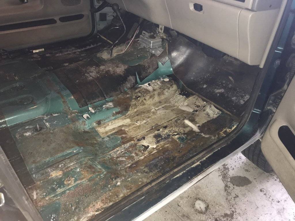

While the kick/sill panels were out, I noticed the underside of the carpeting was soaked. Peeled it back to see some corrosion, and atleast one small pin hole in the floor... Every F-ng vehicle!!!
So have a new carpet on order. Planning to pull the old one, and deal with the floor next weekend. Hoping to just weld up a couple pin holes, then trear, and paint the floor. Need to find out where the water is coming from.
Was a nice excuse to get a new carpet for her though. The current one is pretty nasty.

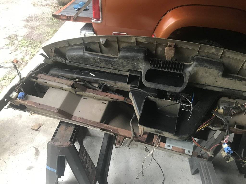

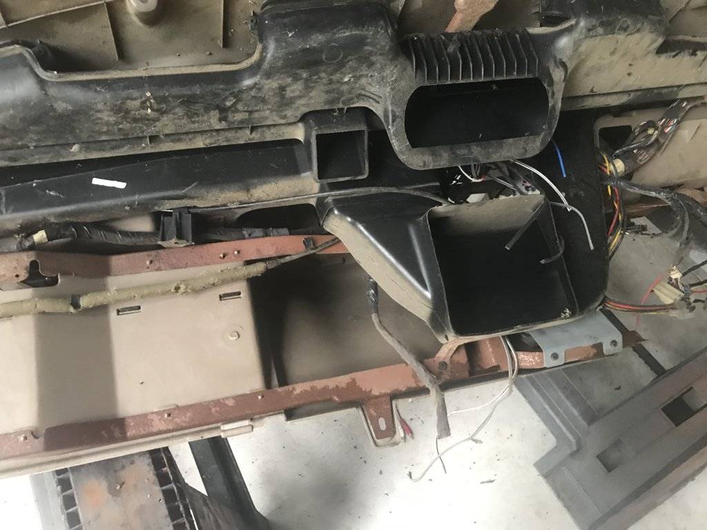

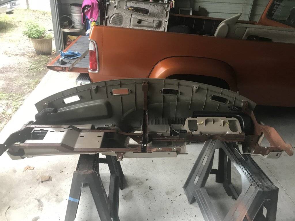

Here is a before shot of the old dash (or what was left). It disintegrated into dust as soon as I got all the duct work, and wiring out of it. All thats left is the metal frame.
Discovered that the vin tag for the dash is missing. Was hoping it was just hiding under the dash cap that was on it, but it is MIA. I installed the new dash without a tag for now.
Wondering if I can get a new tag for it?

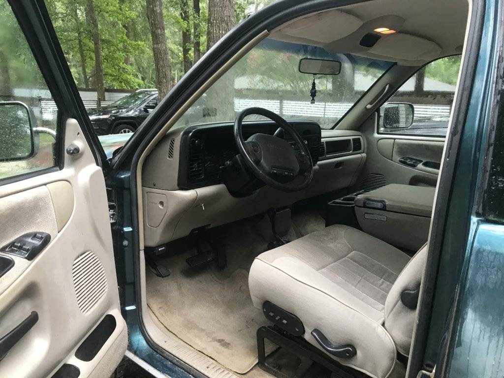

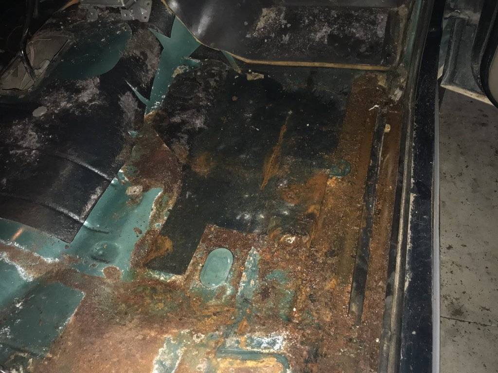

Got the interior gutted tonight. It is not pretty! But luckily, it seems to look worse then it really is. Still solid, just scaly.
Didn’t end up finding any goodies under anything either. Damn!

Made a little headway tonight. Removed the tar sound deadener, and wire wheeled the floor. Welded up the few pin holes, and treated it with the leftover metal blast from rust bullet. Can really see it doing its thing, treating, and etching the rust. The floors almost white! lol
Ill let it soak overnight, and get her painted tomorrow.
