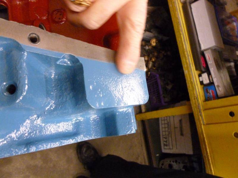

I totally missed this thread. Good info, I never thought about the exhaust valves being paired (No heads yet to look). I had an oh sh*t moment while running to the garage. Good luck with your rebuild OP, sounds like the updated engine will be much better.block.jpg

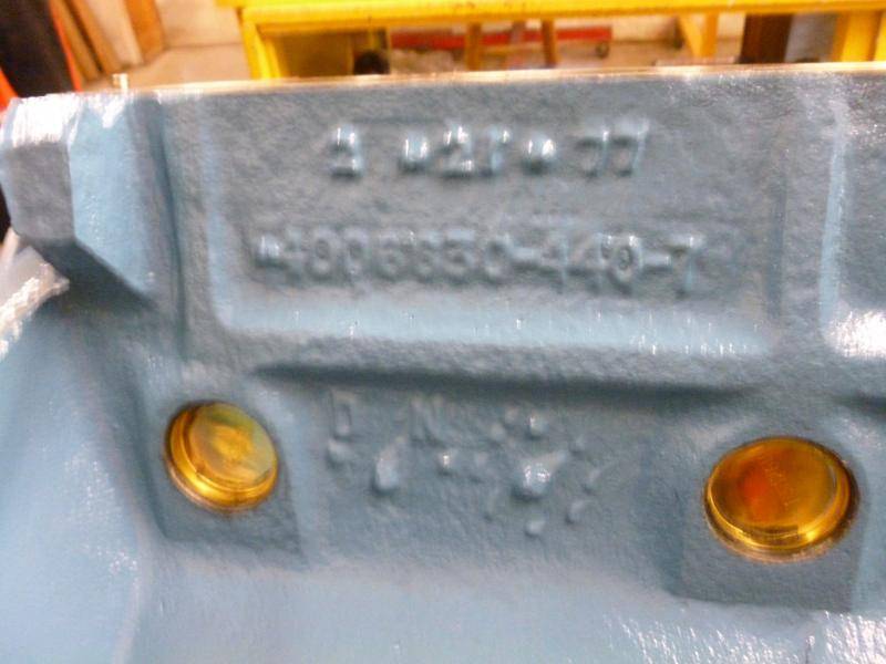

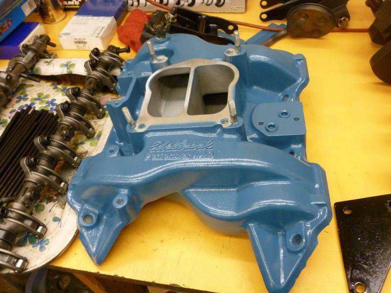

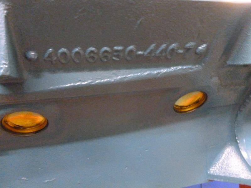

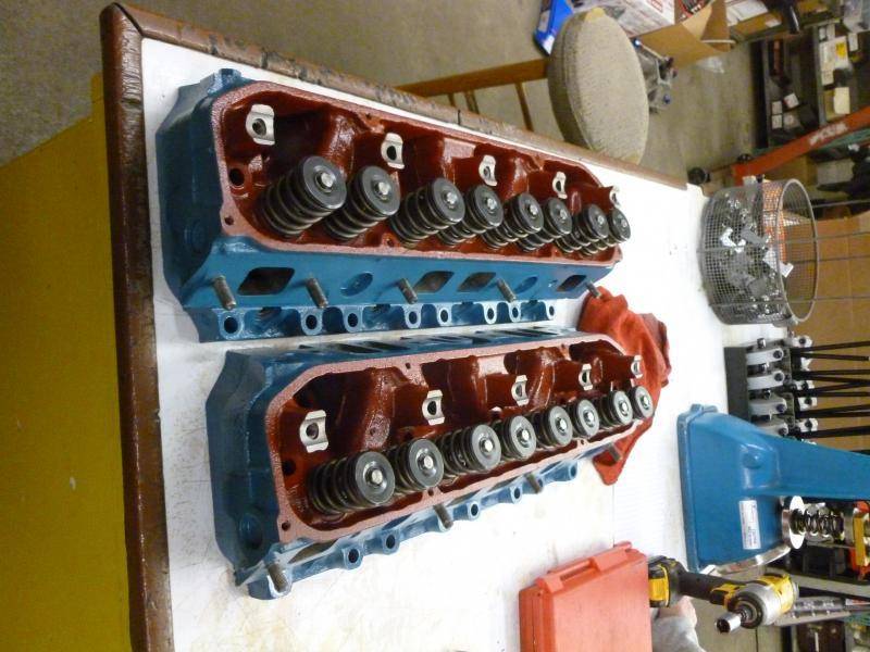

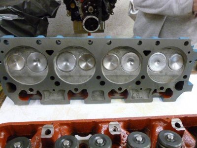

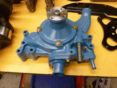

Looks like the pistons are on back order so it may take a bit longer to get everything together. Here are a few more pics from my visit today.

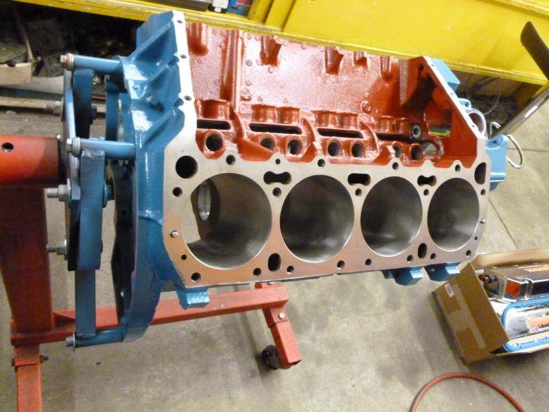

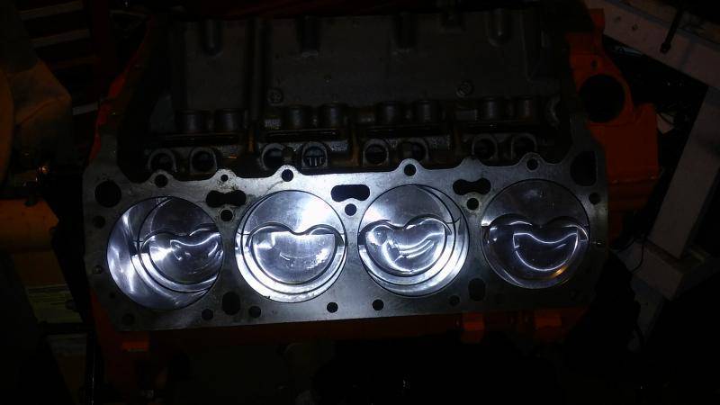

Another few pics from today. Block is bored another .010 (total .040 over) and confirmed adequate. The forged pistons ordered and moley rings have been ordered but due to back order likely won't be in until New Year. Shop still figures we will be on target for factory 440 HP specs. I was hoping to drive the car home but it likely won't happen on mid-January roads around here.
Hope you're detailing the hell out of the engine compartment to do that spiffy looking engine justice. .
The machine shop did the finish hone without the pistons? Did they get the piston specs from the manufacture
