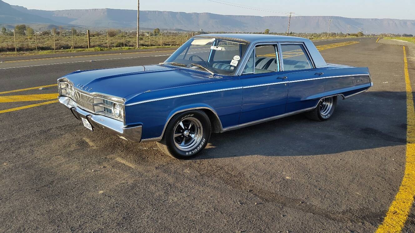

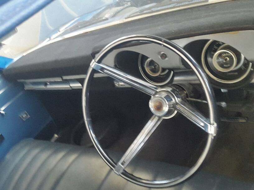

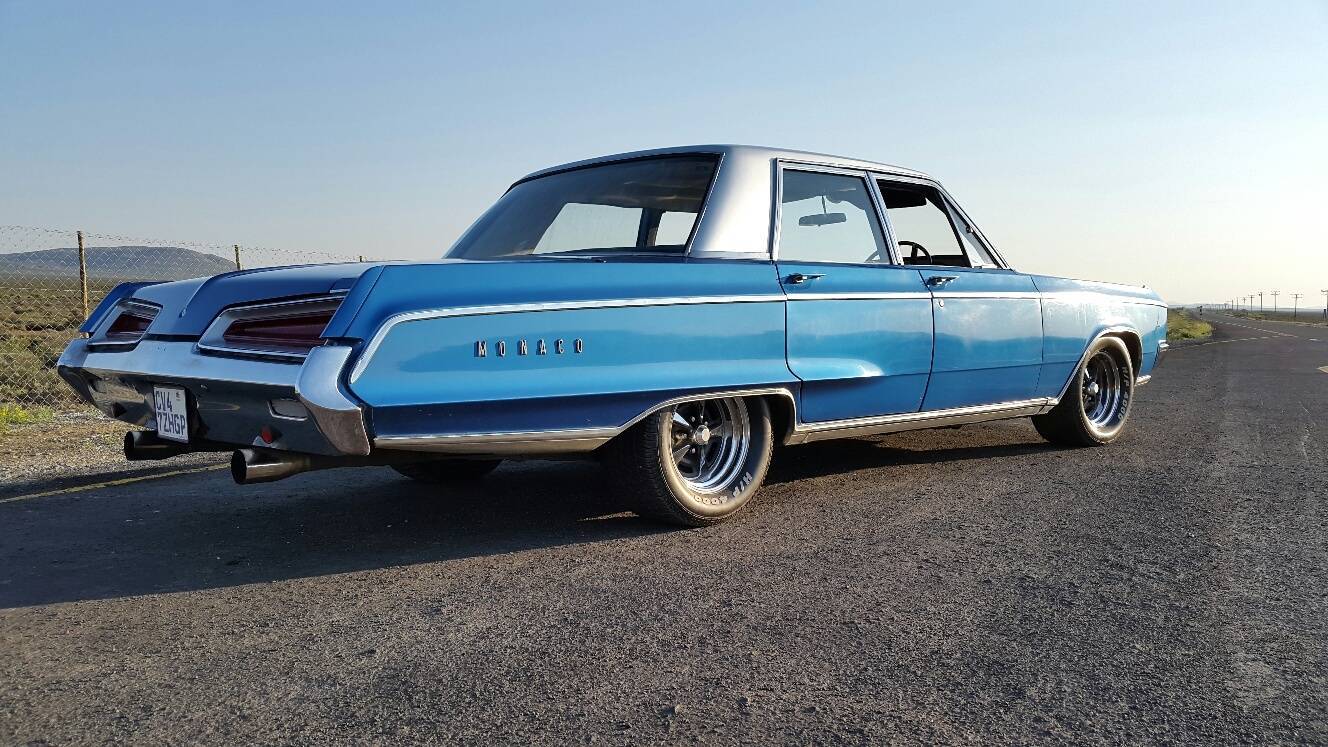

Hello All.
A mate of mine on this forum, Ters, inadvertently got me hooked on C-bodies.
Although I am only getting her next week Friday, I would love suggestions on upgrades that you would do to make it a very reliable daily driver.... And yes I love driving my classics everyday, or using them as my primary source of transportation.
attached are some pics of my Monaco.
