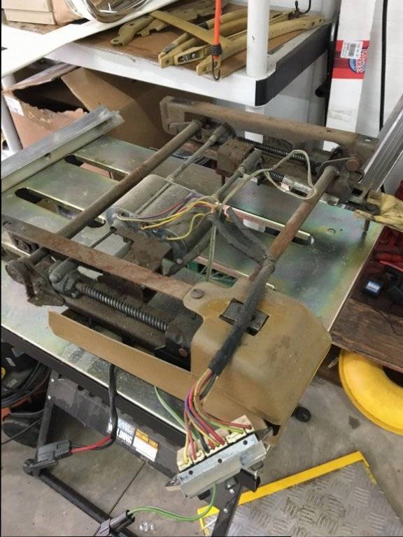

Apr 15, 2017 #1 Fast Eddie B Well-Known Member Joined Oct 16, 2016 Messages 605 Reaction score 630 Location Western New York It's the power seat rack from my 77 T&C. Won't get easier to tune it up. Anyone know off hand if there is any maintenance I can do to it?
Apr 15, 2017 #2 commando1 Old Man with a Hat Joined Mar 10, 2011 Messages 37,383 Reaction score 38,550 Location Sebring, Florida Lube it.
Apr 15, 2017 #3 Ross Wooldridge Old Man with a Hat FCBO Gold Member Joined Apr 25, 2016 Messages 5,669 Reaction score 5,254 Location Scotland, Ontario, Canada Clean all the wiring connections - male and female. Lube the worm gear and other track assemblies.
