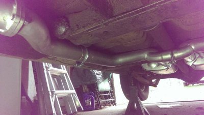

Here's the install from back to front:

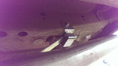

Hanger above rear axle

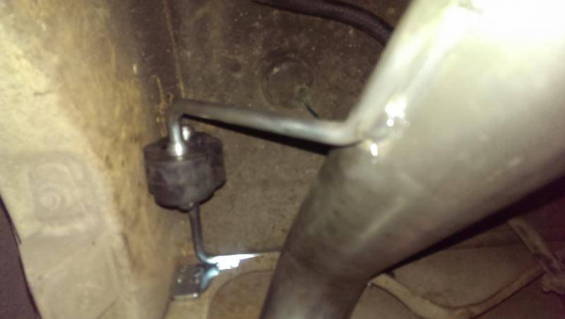

The hanger for the drivers side doesn't look quite right
I had to bend it before and after bolting it in to make it work

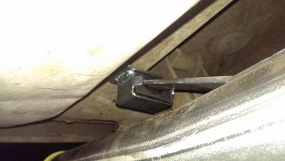

Other side was fine. These rubber isolators suck to get on! But they won't be going anywhere anytime soon. Yes I lubed them.

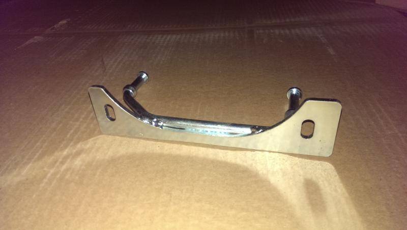

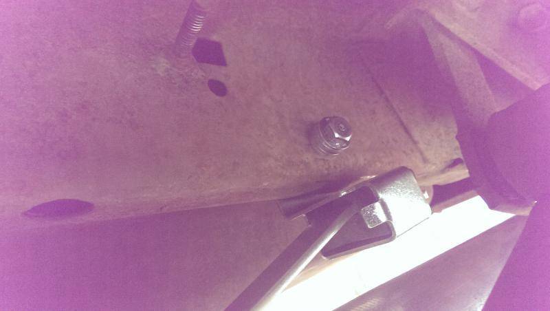

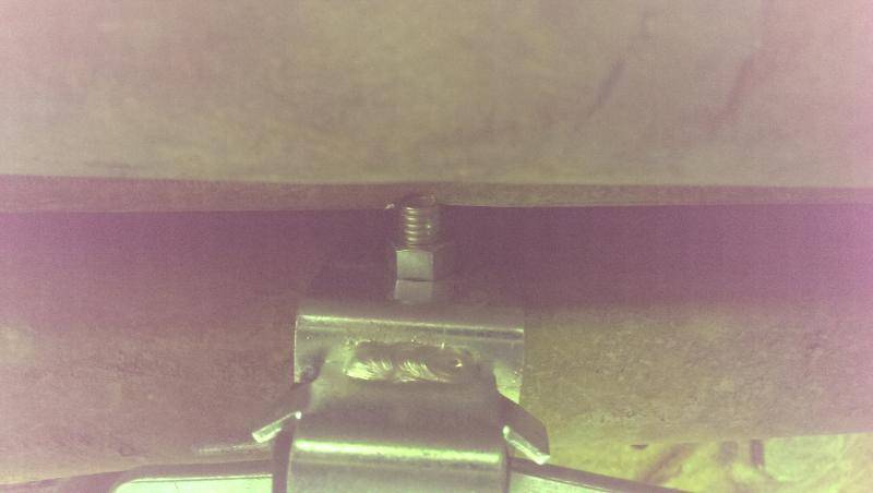

The hangers for the back of the tail pipe. The bracket required I drill through my frame rails, as the gas tank was in the way. The spring shackles didn't make it any easier.

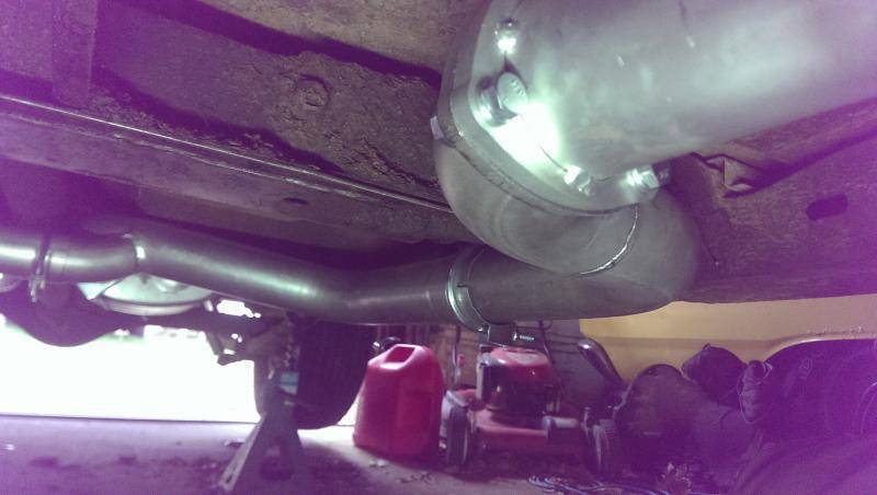

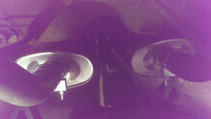

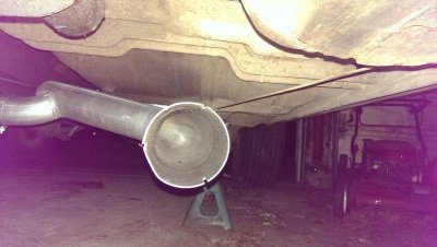

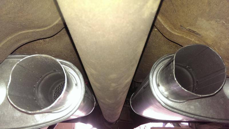

Mufflers had dents in both inlet connections and one outlet. Bent it to round with my crescent wrench.
Then the H-pipe assembly.
I still have to put the header extensions on and align the system, clean the headers of grease and a couple other things under the hood, then fire it up and take it for a spin!

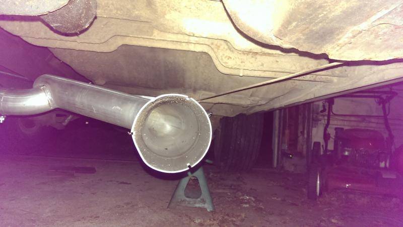

I haven't put the turndowns on yet. If I do I'll have to cut the tailpipes down a few inches. I'll see if I get around to it.

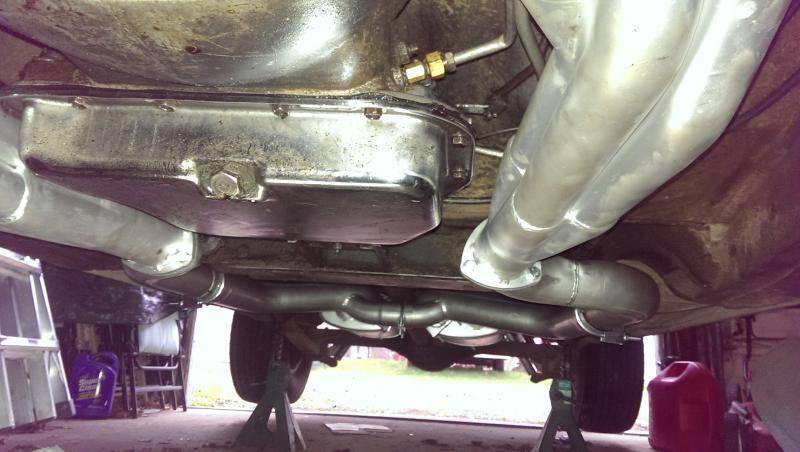

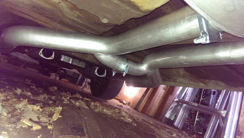

Need to cut the H-pipe down a couple inches. I sure like working in dimly lit conditions! At least I don't have any time constraints...

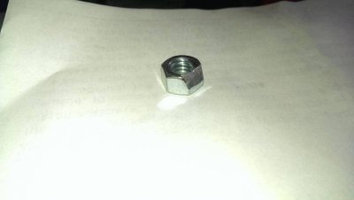

It's all under the car! Had to cut 2" off each side of the back of the H-pipe as stated, then had to expand the front of the drivers side of H-pipe, it must have been made right before lunch as it was just tight enough to not work. Then I had to use the old rubber mallet to get the header adapters fully seated, and aligned to the headers. Once that was done, I had to grind a little off of a nut so it would go over the hole and engage the bolt.
The bolts and nuts have just enough room to work with, other than that one, definitely not roomy with the adapters.
The tight side. Not round either.
That is all tightened up, just have to do the back of the mufflers and adjust the rear pipes and shim up my bolts back there. The tail of the car is sticking out the garage doorand it's raining, so I get to slide under the axle! I'll have it running by tonight, I'm in no hurry (if you couldn't tell by reading this thread) so hopefully the rain ends soon. I'll check over little things if it doesn't.
All tight all the way.

I accidentally hit the gas tank seam with the drill when I was making holes for the tailpipe bracket, which actually worked fine since the bolt had to go right where I drilled!

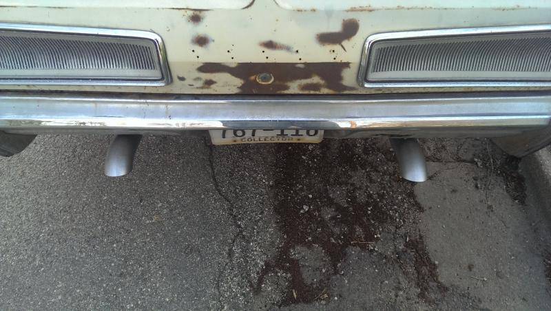

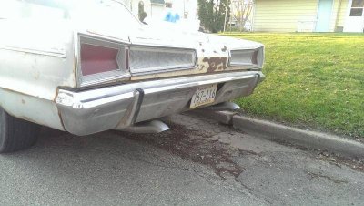

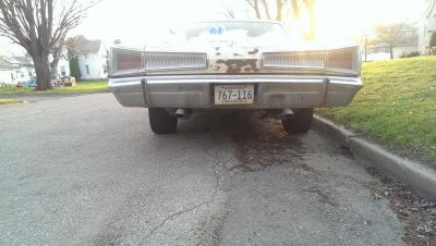

Between being busy with work and house work, I managed to get the turn down tips on my car. I think they look ok. Here's a before pic.
And some after pics.

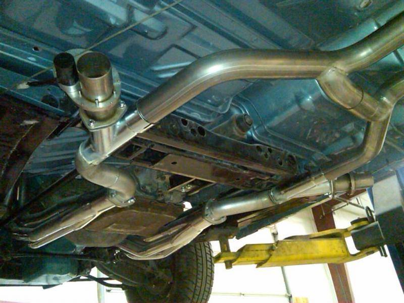

View attachment 41538I have the Headers and full 2 1/2 inch exhaust on my 65 Newport. I didn't install it but the shop said it fit well. We had the wrong trans mount at first but when that was corrected it was perfect. I also added Dougs electric cut outs.
