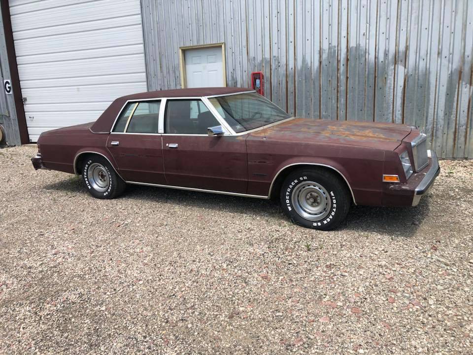

    I kind of like the looks of the R-bodied Newport, St Regis, and Gran Fury. But there seems to be very little love anywhere. I know they're not sexy like a fuselage nor as luxurious like a formal.
    I found a 1981 Newport with some nice patina much cheaper than some of the c bodies in the same condition.
