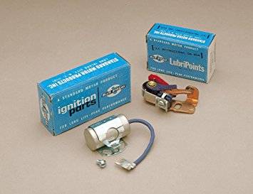

Issue 2: She's going through condensers faster than I can get through a box of Ho-Ho's. Could this be a symptom or could I be looking at quality control issues?

2. Check your voltage at the distributor with the key in the run position. If the voltage is normal, the ChiCom condensers have a 35 percent defect rate right out of the box.

The trick these days is to find quality ignition parts (stock) that are made with some concept of quality control. Most of the crap that you average auto retailer sells is coming out of China, some of it is pretty good, a lot of it is crap. Problem with consistency.
I kept all of my older Mopars with points except for the one I put the most miles on. That one got an OEM electronic conversion which has been in the car for 20+ years and it still works. FYI Electronic conversions work well if you have an electronic voltage regulator and the later style alternator. They will burn out quickly with a mechanical regulator and the early style alternator so keep that in mind if you ever decide to "Upgrade". Your "66 Imp should, regardless of whether you go electronic have the charging system up grade to prevent a burnout of the ammeter. You can PM me on this if you chose.
