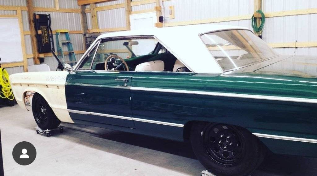

@rd92west has done a swap to a four speed, he has a thread here somewhere.
This is the car he converted, it may be mentioned in it. (Only 4 pages)
1966 canadian polara 880

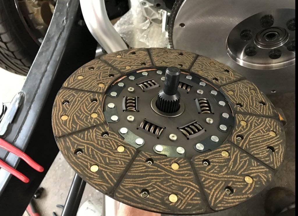

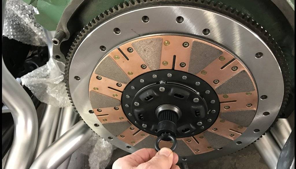

Here’s some pictures of the clutch that comes with the kit from SilverSport Transmissions. It’s an 11 inch.
At this point I’m only driving it around the school parking lot (I teach auto mechanics at a high school CTC). It’s a pretty big lot and I can get into 3rd gear before needing to turn around. It feels good and grips nice, no shutter when taking off.
You’re talking about a heavier clutch disc than this, but I think this one is a step up from the most common clutch and should last a long time for me.

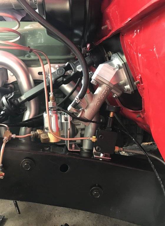

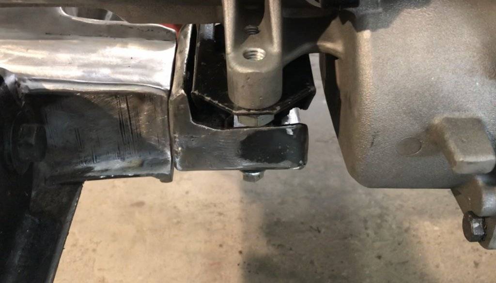

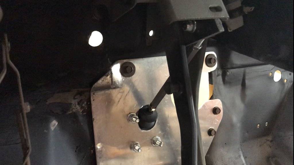

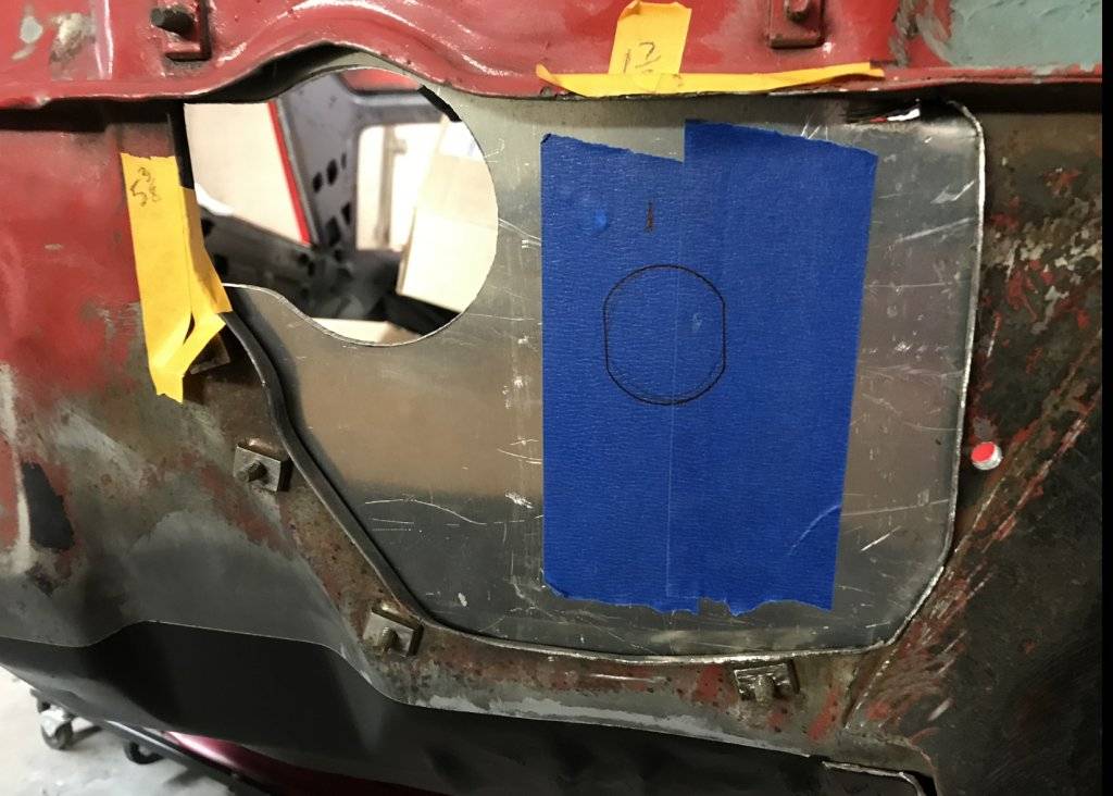

Silver Sport didn’t have a kit for my car, I had to go with an early B-body kit and build from there. I made some changes to my center piece - between the torsion bars for the transmission and the mount. It wasn’t a big deal, but it had to be done. The tunnel also had to be modified, again, that wasn’t too bad.
I sent my complete pedal kit to Silver Sport and they scanned them, so they have the capability to make them if the demand is there. They sandblasted and primed them before returning them to me - that was nice.
I have a thread here under “restorations” that will have some info about what I had to do to make the transmission fit and the hydraulic clutch work. Here’s some pictures…….

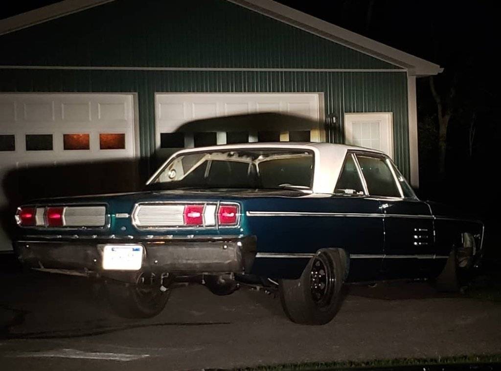

And here’s the finished product….
