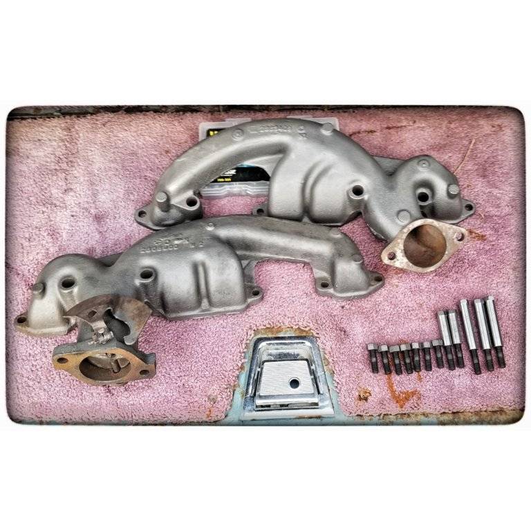

    Question: what are your plans for your vehicle?
    The headers that are KNOWN to work are TTI (different headers for 383 and 440 engines) and Hooker 5113. You can find the Hooker Headers for sell on craigslist/fb market place a bit more often than you do the TTI's. I've yet to see someone who has recent pictures of anything other than these two headers (and the currently out of stock Schumacher tri-y) on a big block cbody without moving a tube or some major modifications. Have you thought about HP manifolds? You can usually find those for under $300
