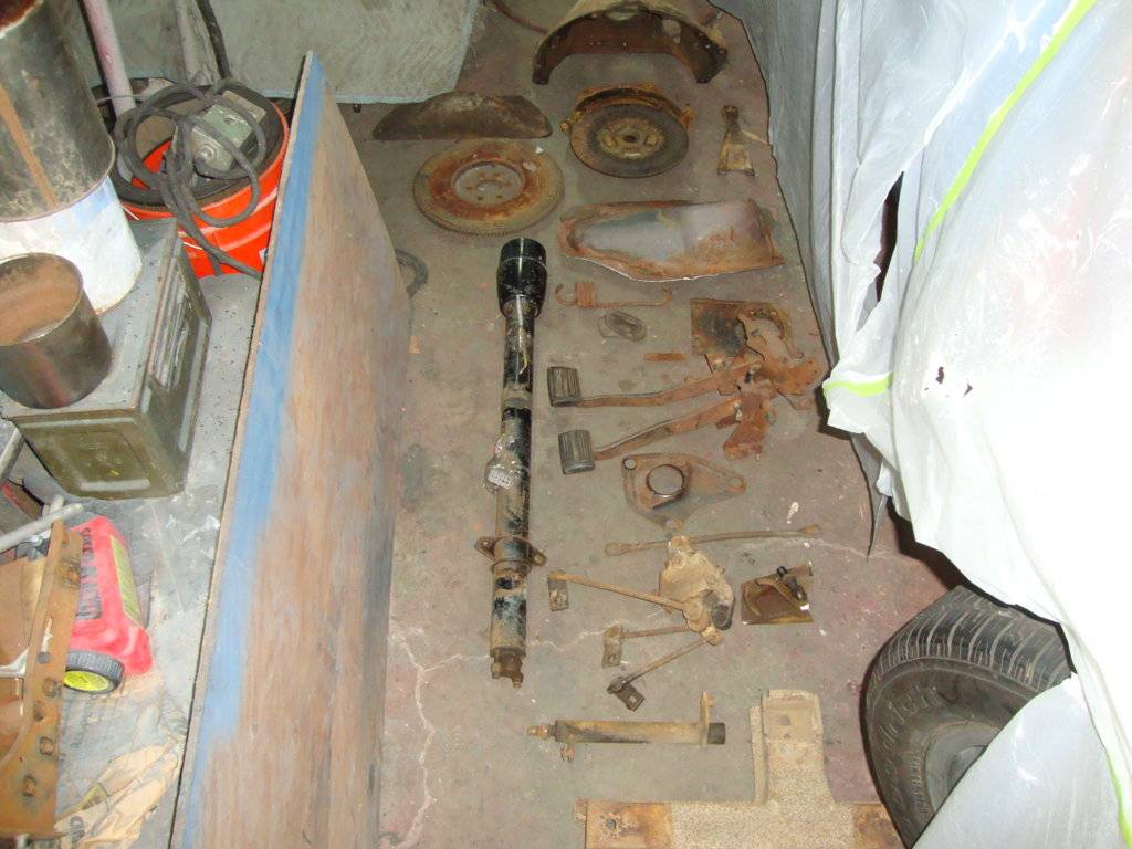

well i'm going to build clutch peddles and hanger brackers , as well as floor humps and of course that special z bar and frame mounting bracket . using 66 parts supplied . i'm just thinking of how many to build . these parts are to be made here in the united states of america . keeping the work force here working . and steel from here as well . going to make it as strong if not stronger that oem parts . so i'm looking for members that would like some of this stuff to convert or replace the setup they have . please feel free to climb on in on the discussion . and let me know of your wants . thanks pm

this is great guys . do you think you setups should be stock or heavery duty . what clutch set up and how much motor is going to be in the machine . thanks aidan , x'mas was grand , new years was a new year , lol . and aidan whats up on my 72 . still in the want ? and yes , thanks barnfind . the parts are being broke down to their parts of assembly now . i can't wait my self . of course i'm going to run these parts in my 65 880 . and there is two more c bodies in my stable or hoard , lol . does any one else see any more parts i should build as well in the pics , thinking about the steering column collar , but it would be 65-69 , the 70-78 maybe .

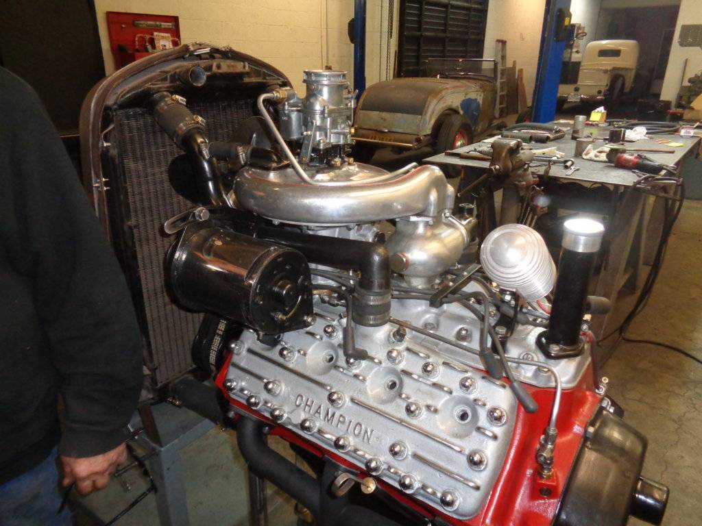

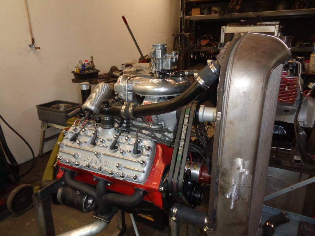

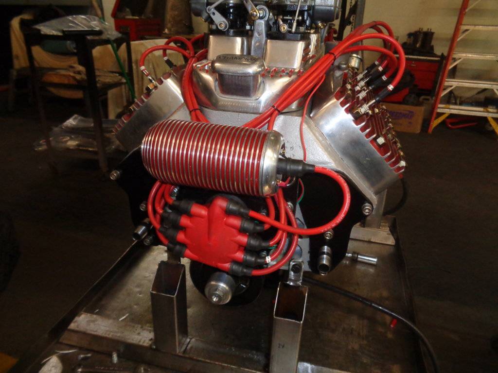

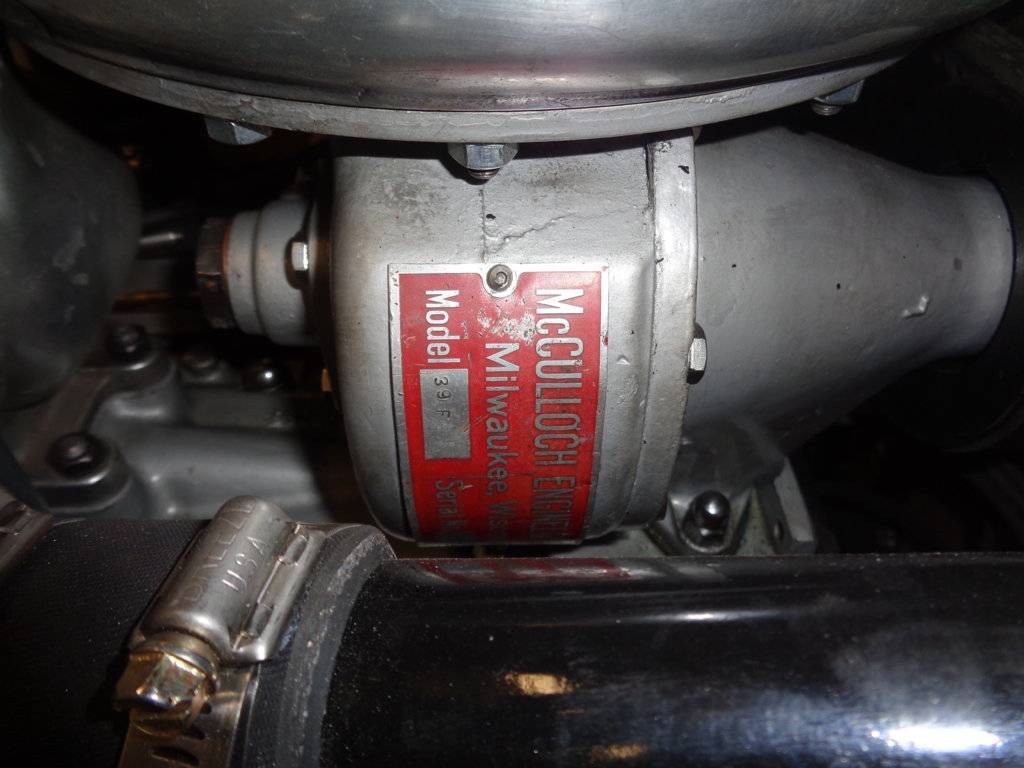

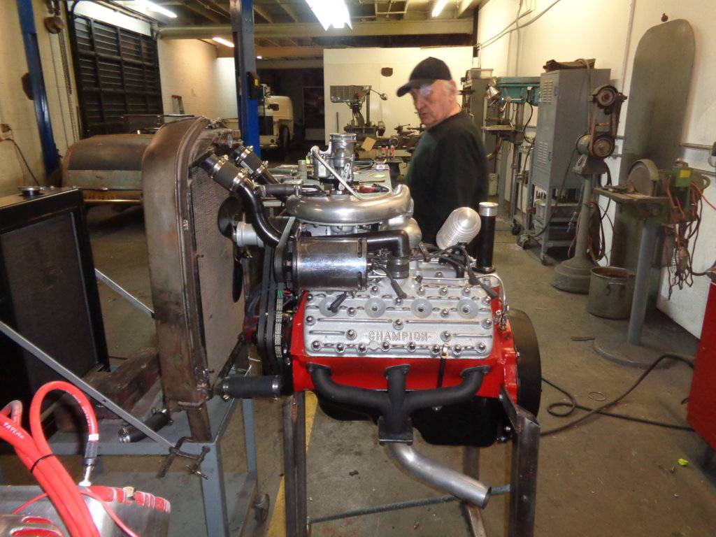

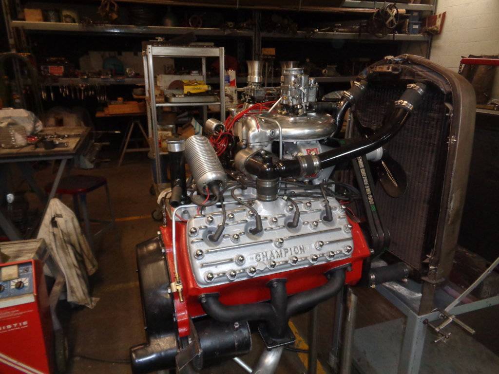

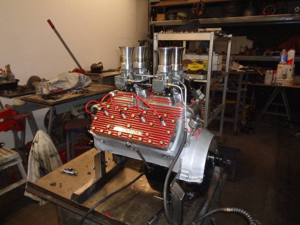

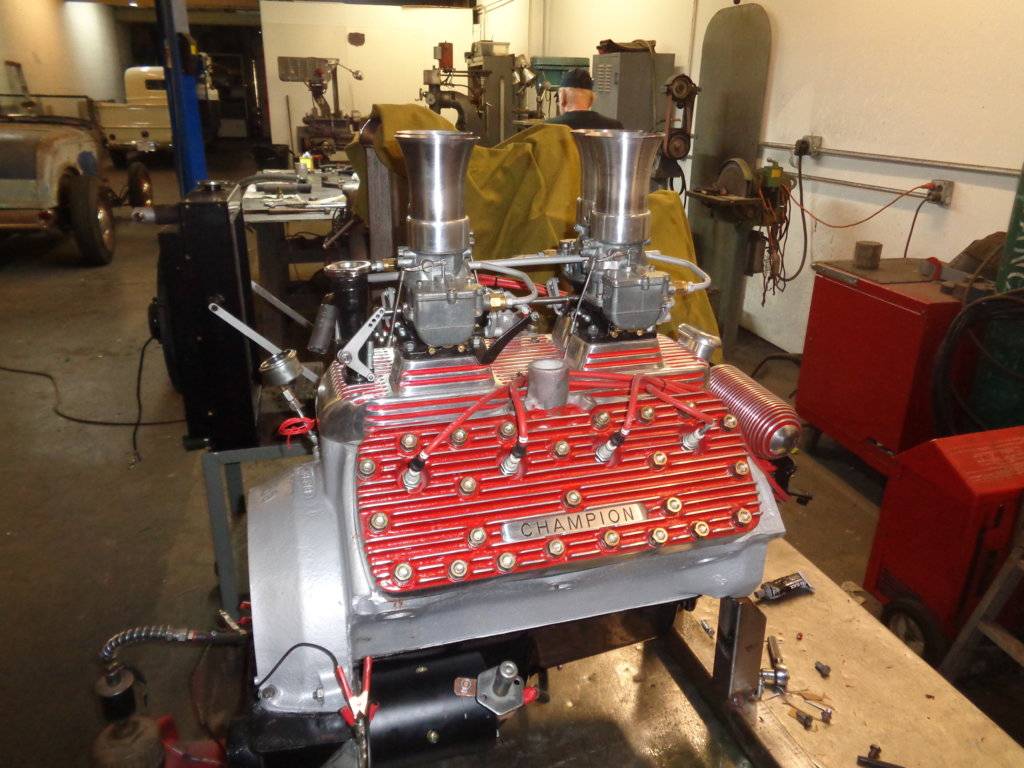

thats in my thoughts as well . the standard brakes are clutch peddles are on a common shoulder bolt . i need to get a p/b set up apart to measure up the parts . but in all , there would be another brake peddle arm to be made as well . and there is this thought . as you down shift engine rpm climbs up the scale and being on the booster brakes at the same time will make a boosted booster durning those gear down shifts changes . not sure about how that would feel when you are on the brakes . this is a different subject , but heres some pics of my buds butches flat head motors @Aidan1976 saw on his san jose visit . the blown one is a 49 merc
for his all steel 32 b'roadster , and the other is a 46 truck block ford , oh ya the blown injected 354 hemi's is next on the list of builds . there for sale like everything else .

yes gents , its all different then a's b's n e's . the hump is at the being spec'd out so we can stamp them found heavy steel sheet like chrysler did . and on a side note ; has anyone tried putting a g/v od on a a833 ? same spline on the output shaft as a 727 , at least the long version has .it would take a new tailshock just like the 727 .

yes , i have my metal smith working up the dyes for stamping them as the factory would have , for that c body hump . he's great at those types of metal stampings . yes @commando there to be as close as i can get them to be as oem . in fact i'm using my own 66 setup to do this . most of the parts must be cut apart to get here configuration for manufacturing them . i'm going out on t the limb on this . building some where of a hundred setups and be able to stamp n build more . we will have the fixtures to build , and the parts break down .
