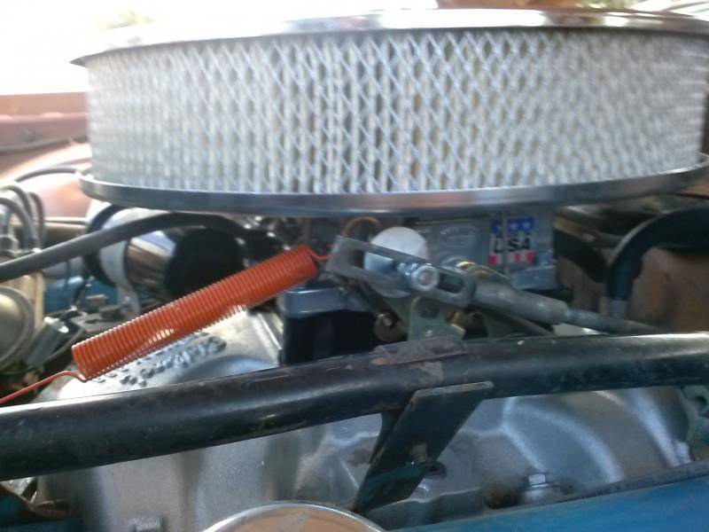

Hi All,
Today I put a 1 inch Edlebock spacer in between the Edlebrock Intake and Edelbrock Carb. I "tuned" it myself.
When I took it out for a test drive, I punched the gas from a stop, and when I took my foot off the gas the engine kept accelerating. I had the turn the car off to bring ita stop. Good think there were no other cards around. It started back up just fine and I drove it home (about a mile) without any issues.
The throttle cable is at a big angle now that I put the 1 in spacer in the car. Could that be it, or that maybe I tuned the carb wrong?
Thanks

Probably pulling the linkage over center and the spring won't bring it back.
Lose the spacer, it's changing the geometry of the linkage.

One inch is a big change. Cut it down to 1/2" and you should be OK. Thats what I run.

I'd check the spacer to carb fit and make sure they don't bind. I've had them bind and stick a wot.

The linkage is getting hung up on the air cleaner as you changed the geometry of the linkage by adding in the spacer. No big deal. You will need to do this mod to your car with a spacer setup. Kick-down will need to be adjusted accordingly after the mod is complete. Also, is your throttle cable long enough for full return with the spacer in place? Get rid of that big washer and make sure the kick-down moves smoothly. BTW, by looking at the picture your kick-down is not adjusted correct.

Maybe that giant fender washer is hitting the bottom of the air cleaner. Did you check the operation of the linkage with the air cleaner on before you took it for the test drive?
Thank y'all for the diagrams and advice! I'm going to flip or bend the passing linkage. It does look like it was hitting the air cleaned. Not sure what to do about the throttle cable yet. Maybe bend the bracket its on.
looks like your kickdown linkage is upside down or just angle from spacer but that's where I would look.

You also need the Edelbrock throttle linkage adaptor (Summit/Jegs), and get a light spring to hold your kickdown linkage forward independently and be sure it is adjusted correctly.
You should check the throw length of your kickdown lever on the transmission, and find a point on your throttle lever adaptor that will have the same amount of travel in order for your kickdown to work properly.

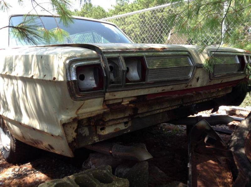

This is what happened to my car before I owned it by the same thing you have going on. Throttle linkage got stuck under the air cleaner housing and he couldn't stop the car and slammed into a tree in his driveway. Car was completely done. Not a good thing,.but good for me as I have the car now. Pictures show right after the quarter was hung and trunk. Frame was straightened out and reinforced. I'm about done with the body work to the quarter and will be moving on to the trunk. Just sanding will be needed and rust encapsulator before paint. Then it goes for paint and bumper re-chroming. Rest of the car is mint.
First question,was your car originally a 2bbl motor,if so then you need a longer accelerator cable or an extension,and a one inch extension on your kick down lever,they do sell kits for this,,on my 65 fury with a poly 318 it was switched to a 4bbl intake and carb,I had to find a longer cable and just welded a one inch piece onto my kickdown rod,,the amgle on my cable was way to low and if you look for a 70-77 BB/RB motor with cruise control ect you will see a cable bracket extension that raises the cable up about an inch,,it may take a bit of finesse but it will elevate your cable to the correct height,,good luck on your next exciting ride.
