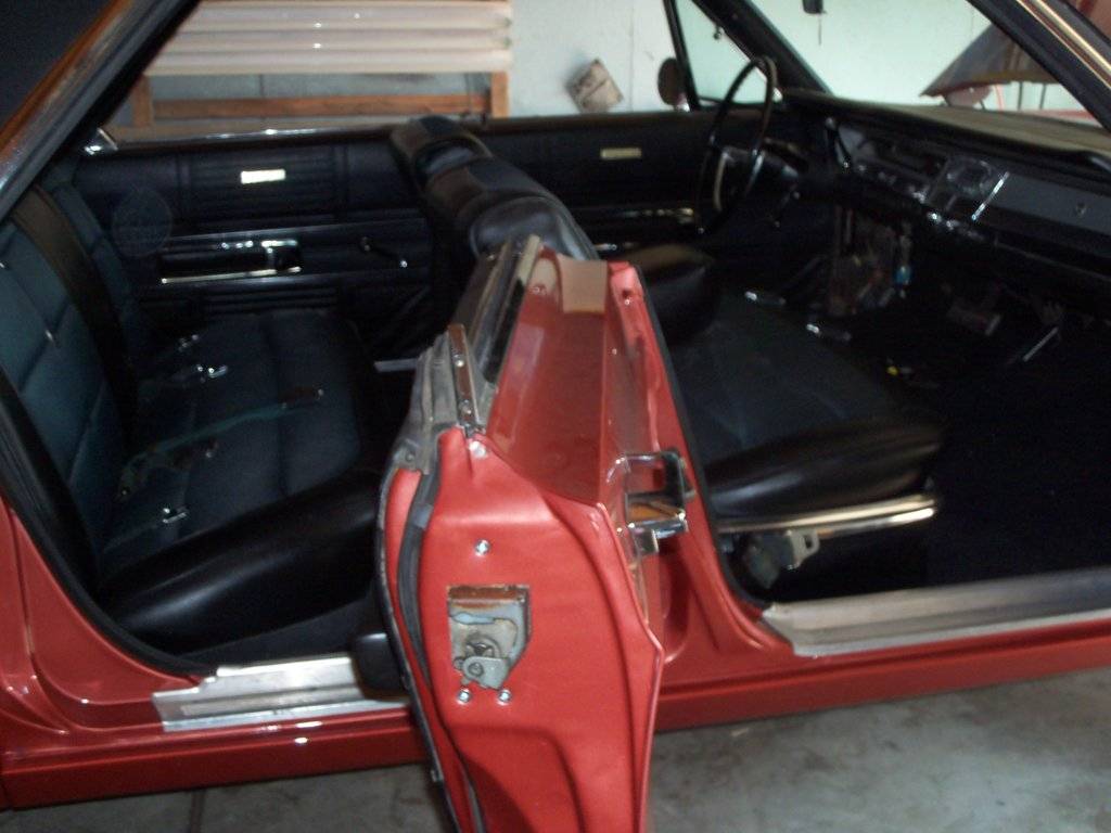

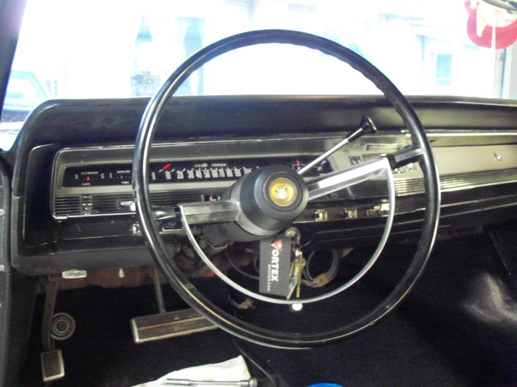

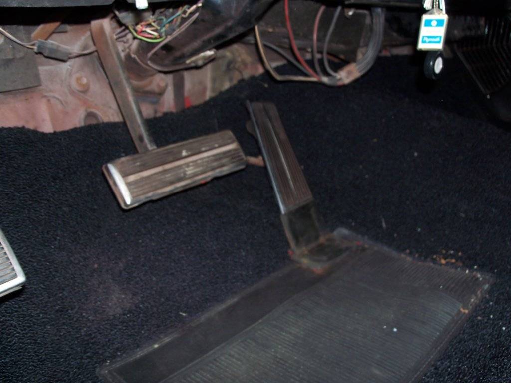

    Got ACC for both C bodies. Not perfect but just take your time installing it.
    I took it out of the box and let it "rest" in the car for a few days.
    Check and double check 3 times before cutting the carpet.
    On the BoaB a little short going up the firewall but does not bother me since I don't look up there when i am driving..
    Carpet is one of the very few parts being reproduced for the C bodies,so no complaints from me.
    Overall,I am happy with the product..better than what I started with which was...no carpet,LOL!!

    I bought a carpet years ago (from Trim Parts I think) for my 2-door hardtop and it came-up short in the front under the dash, just as shown in @cbarge 's picture. I also bought the matching floormats and they sucked... much too small to fit the front footwells. Recently I bought an ACC capet for my hardtop. It did not come-up short in the front, but there was very little overlap between the front and rear sections, so be careful laying it out exactly before cutting. Again I bought the matching floormats and very happy with these ones. Good size and the shape of the drivers mat is angled around the gas pedal.
