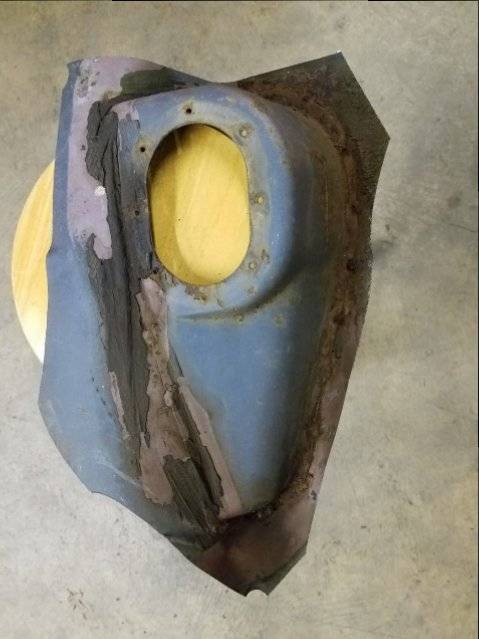

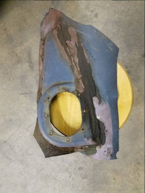

Save yourself a gazillion tons of aggravation AND just buy the correct C-body hump from Resto Rick.. It's a dead-on steel duplicate of the original.
floor hump , 66-69 b body
I beg to differ sir. The B-body hump doesn't even come close to fitting nor does it want to even after spending hours trying to refab it.
I just wish that this myth that a B-body hump works in a C-body would end once and for all.
In all fairness, you can say a canned ham will work with "a little fabricating".
in #4 i talked hump , but not from a b body . as you can see the pics are of a c body hump . the trans can be b body not the hump . use the pics to see the c hump differences to the b body hump , sorry this is the only pics of a b body hump i've got . yes its a 69 rr coupe 383 4spd car noise , lol . it to fix this one that did not stop , lol . thats another story , hope i cleared up the hump issues .
