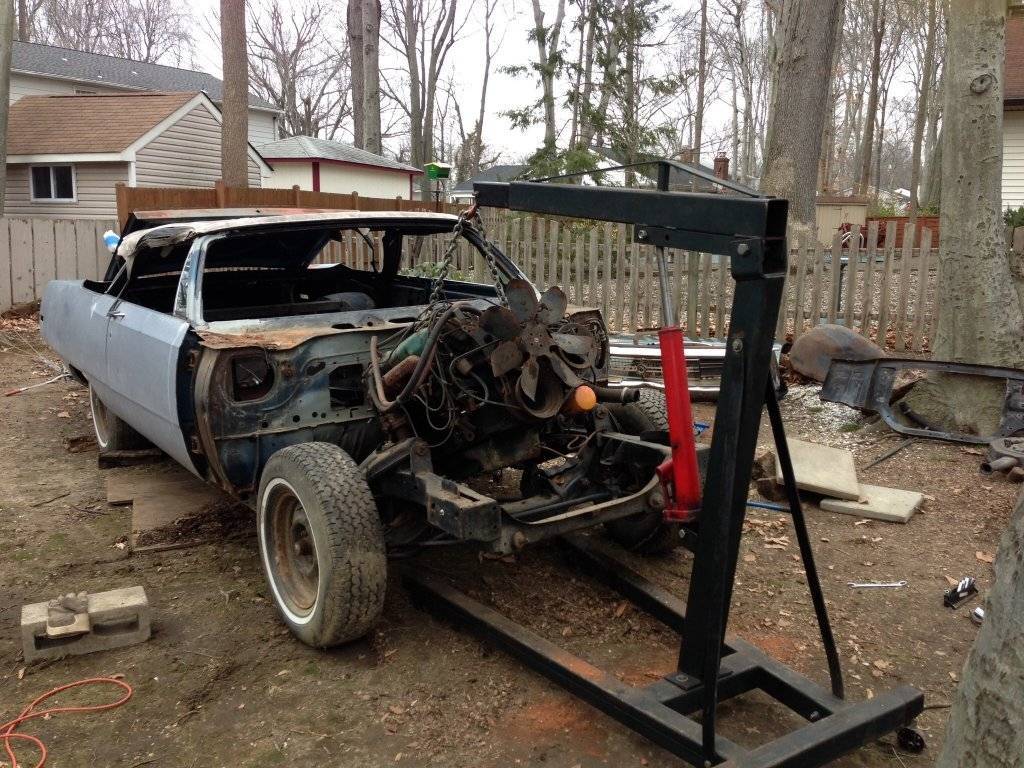

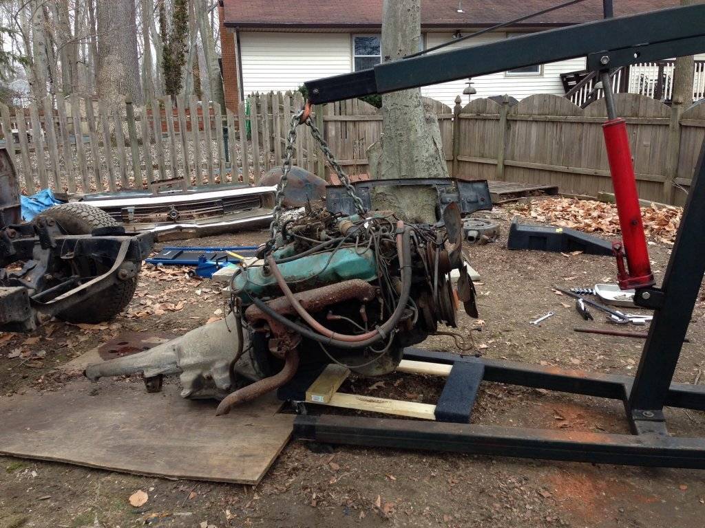

Load leveler? Solid driveway? Garage? Small block? With all of those modern conveniences, piece of cake....440 in the dirt with a truck chain, now that's nerve racking.:wideyed:
I'll bet your neighbors love you LOL
I really wish I had a picture of me and Dad pulling engines using the tree in our front yard and a chain hoist in the early 80s. Pull hood, loosen engine, shove car under tree, hoist engine, push car back.
Yeah the old swing set wasn't available and the trees are too tall. The neighbors cheered when it finally came out, 'cause they knew it was only a matter of time that the car would be out of the yard too.
:mob:
