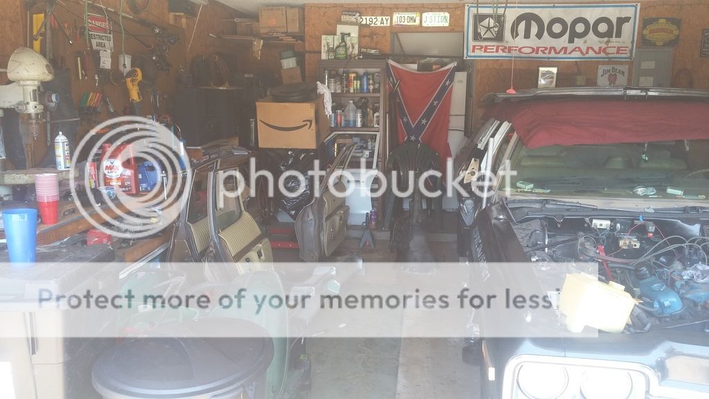

Shhhiiitttt! Maybe if I had a shop to do it in. I am OUT of space! I'm hoping like hell this guy on craigslist is genuinely interested in the small block, and comes to pick it up right out of the car next saturday. I've lost spare room privileges with family visiting lmao.
The garage has a finished ceiling, and being I'm renting don't want to go effing anything up. Already might have to paint the floor after overspray, and spilled paint from doing the underside lol

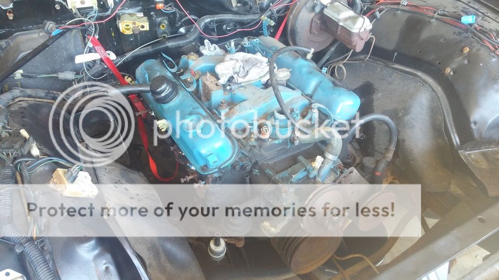

Finished pulling everything off the 360. Even have the mounts loose. Shes ready to come out.

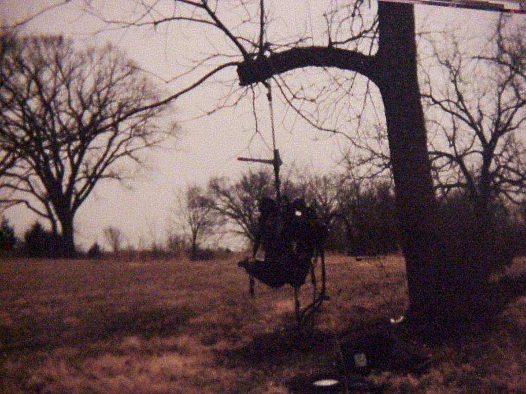

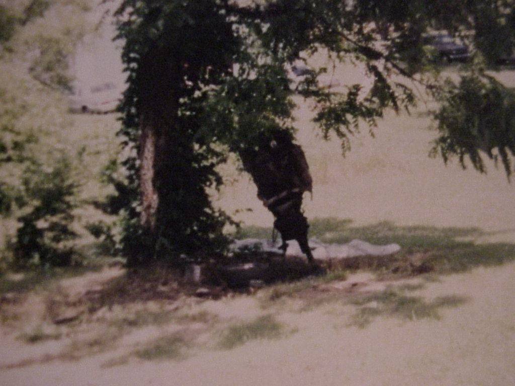

I really wish I had a picture of me and Dad pulling engines using the tree in our front yard and a chain hoist in the early 80s. Pull hood, loosen engine, shove car under tree, hoist engine, push car back.
Me and my dad did very similar back in the day when we junked cars. We would unbolt (almost) everything, pull the car up the hill with a tractor, chain the engine to the tree limb, then let the car roll back down hill. Sorry for the low quality pics. These were taken around '90 or '91

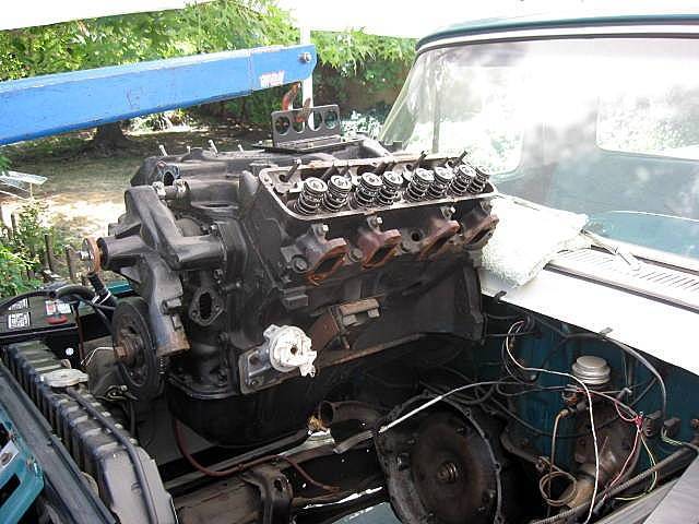

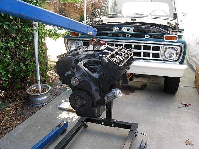

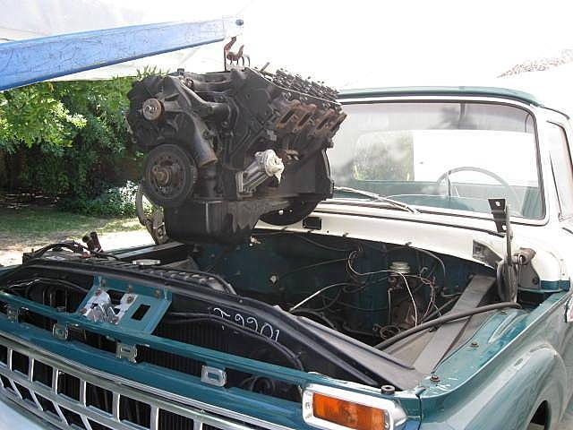

Whoa, a lot of stuff. Here I used a large cherry picker and a carb plate on a 390 in a taller truck.
