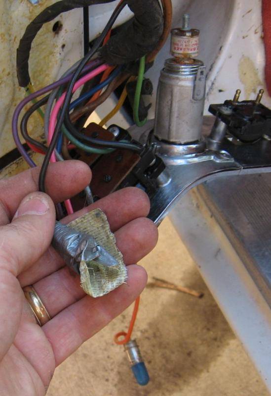

When I pulled the door panels to work on my window, I found that the cigar lighter was disconnected, since the duct tape (!) used to attach the wire to the lighter had hardened and was no longer holding on to the wire.
Rather than just reconnect it, I pulled off the circuit breaker, figuring there was a reason it had been rigged up in place.

Sorry, let me clarify: I pulled off the circuit breaker, and left the cigarette lighter unconnected. I wouldn't run an unfused circuit where one was fused originally.

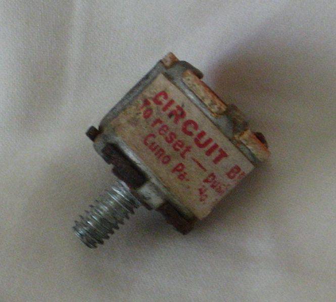

Yes, totally sure it is for the lighter. I took it off a couple weeks ago.

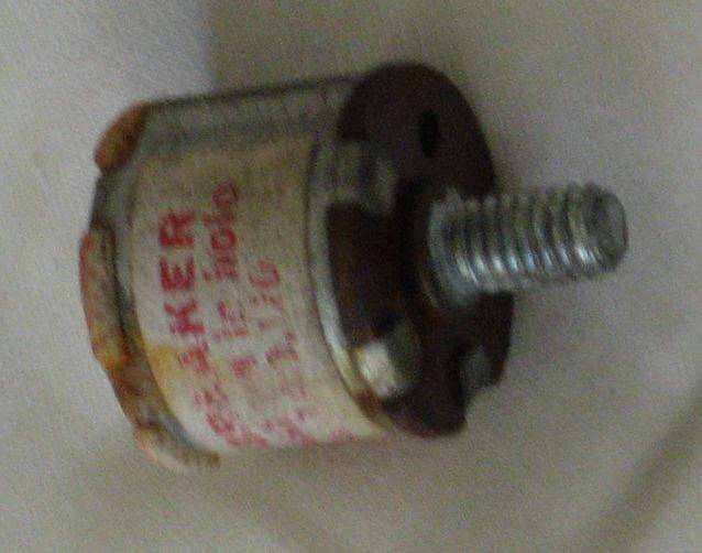

That's not to say I did the smart thing and tested it. It just looked old and dried out and not that trustworthy, although to be fair it might be the duct tape that was used on it. I'll put in a fuse if that's the only option, but I was hoping to find a proper circuit breaker for it.
Interesting... Never saw that before. I wonder if it's Chrysler or aftermarket.
You could replace it with something like this, but I'll bet that one is OK.
Parts book! Yes!

So it looks like it's original, or replaces an original part. Since there have been a number of comments that told me (very nicely) that I'm an idiot and I should have tested them before assuming they don't work, I may test them. Or at least test this one.
Anyone know where to track one down now that there's a part number?
