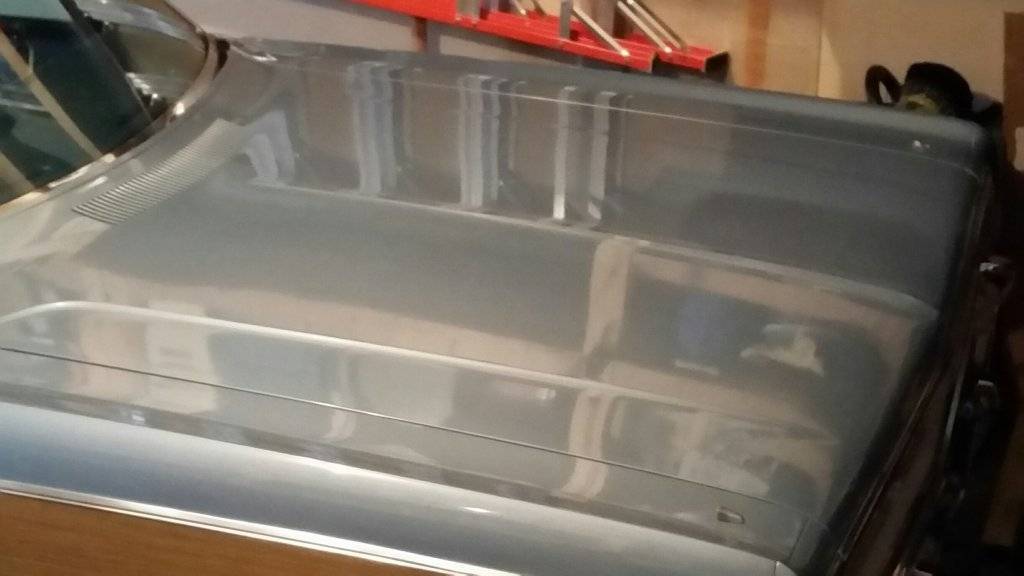

I tried a clay bar for the first time today. Damn, it did a fine job. Slick and shiny now.
