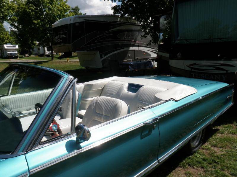

Here is an original boot for a 70 I once had

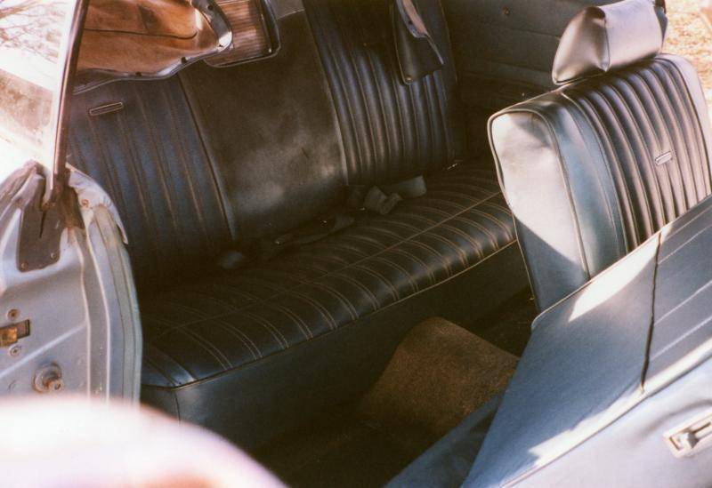

You wont see me disagree with Will too often but in 1970 the only color interior on the Polara Convertible was Black, White, Blue or Green. Those are the boot colors I have seen on them, all matched the interior color
