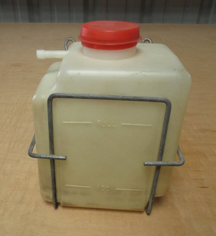

Is this an original Mopar part or not? I can't find any Part #'s on it. It was added on to my 69 Chrysler 300 which doesn't require one. If it's after market I'll just toss it. Thx

The key to making these things "work" seems to be where they are mounted, it seems to me. They need to be very close to the radiator and elevated such that the lines are pretty much at the level of the radiator's filler neck. PLUS a radiator cap "rated" to be for a coolant recovery vehicle. By observation, the best-located aftermarket tanks did not work as well as a factory-configured system.
On the other hand, a necessity for a drag strip raced vehicle. Where it might be considered "a catch can" of sorts.

Looks near identical to one I got from NAPA the past Spring. Mine works very well. Mind you, I still check the fluid level in the radiator top tank to insure its at the level specified in the FSM:1.25" below the filler neck seat. I've found that more than this doesn't permit enough room in the tank for proper cooling, and sure enough, the temperature can go up 10 degrees or more.
With the right coolant level, I get a presence of just a few table spoons in that overflow tank when the engine is cool. But when parking briefly after running in hot traffic, it does catch a bit, which then gets sucked back into the radiator as the coolant contracts. My system maintains excellent equilibrium.
Put the tank next to the radiator, with the cap at the same height as the radiator cap, run the overflow to the bottom of the tank, and all should be well.
