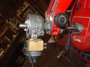

What is the motor, carb, trans factory specs and I can look it up, usually the single point those numbers have the e vac and it ties into a solenoid on the carb and when shut off it retards both. Do you have any dist that came with it and also does it have a vac advance like in the picture I posted?

This whole vac retard is sketchy, it is supposed to also have a wire going to a solenoid on the carb, only know of one guy tat has it and the proper wiring for it. No info I can find on it. The FSM's I looked at also not much with it, does not seem to be a CAP thing, it is for anti dieseling on shut off, would love to find something from Chrysler that actually explains it. I do know that solenoid is super rare and when and if you find it you are lucky. The one guy I am aware of got lucky when he bought the right carb for his car (carter) and it had it on it.

so I guess you need the 222 distributor. This is what I mean at least to me I am confused with all of these dam dist. Does your car have a wire going to the distributor vac advance? Actually do you have a FSM for it and does it mention anything on it at all? I wonder if the wiring diagrams show it also.
