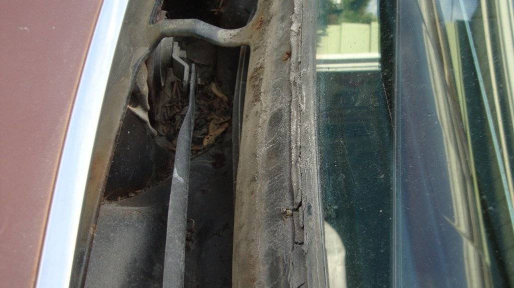

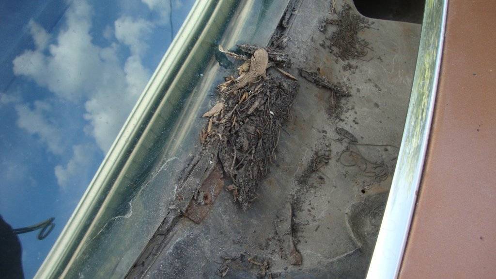

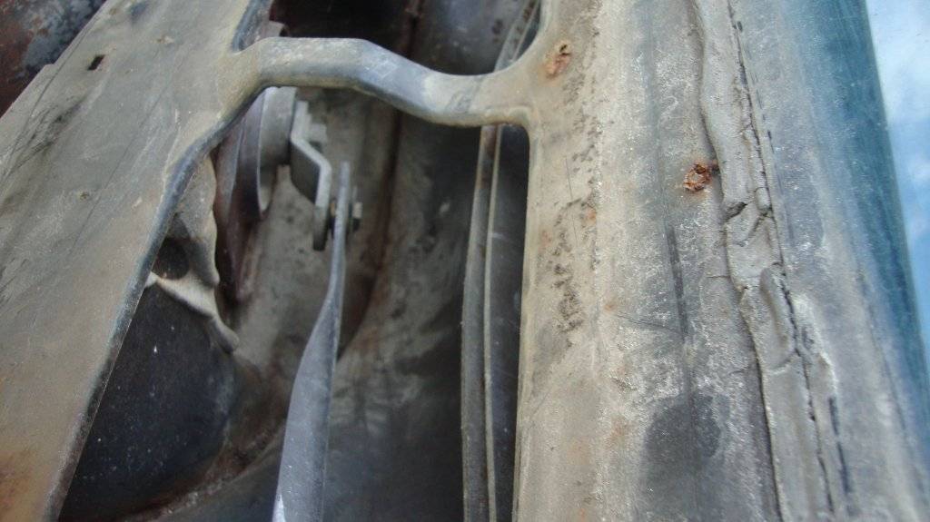

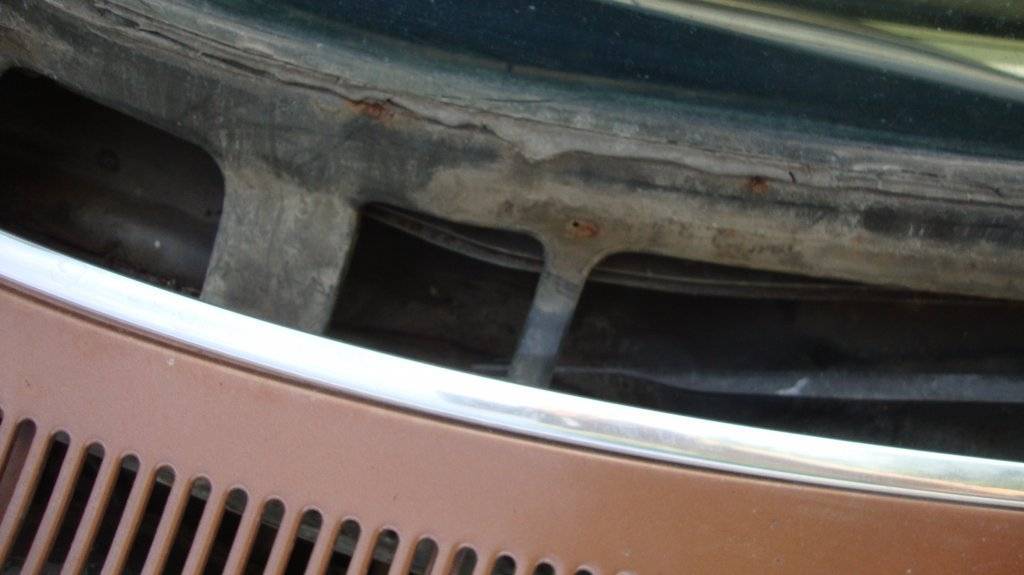

I finally got around to taking apart the cowl panels and vacuumed out the cowl wells.
I want to make sure the drain holes in the cowl are not stopped up. the FSM mentions the drains, but it does not say specifically where they are, and I have searched the forum to no avail.
Could one of y'all point me in the right direction as to where these drain holes are?
thank you!
a few pics for your viewing pleasure..

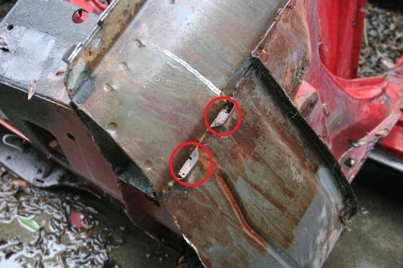

Hi Mario,
On my Polara they are off to the left and right with a smaller one running under the wiper motor...
These drains are huge and usually can hold about 2 lbs of crap on each side going down the rear part of the front fenders
The holes are actually about the size of 1/4" x 1" between the front door and the rear of the wheel well on each side of the car.
I can check out the Newport later but I have a feeling they are in the same areas

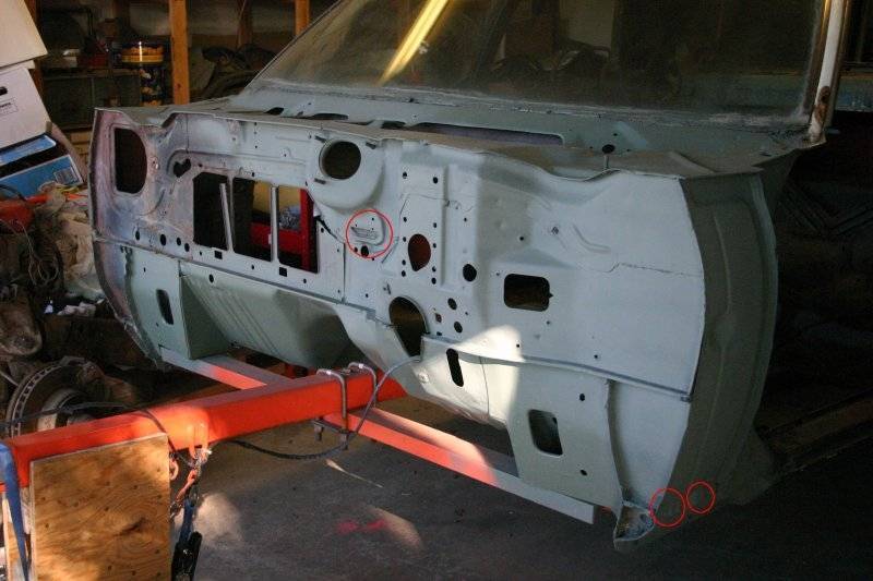

There is one under the wiper motor. the Sides just drain into the air plenum behind the kick panels, the is a drain there but the fenders need to come off to clean.
The center one can be seen right under the wiper motor and above the throttle cable.
The side ones can barely be seen a few inches back on the side and a couple inches up from the bottom.
Alan

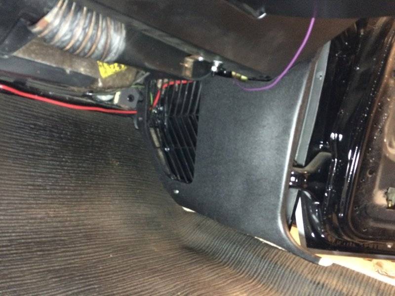

here is a better picture of the lower side ones.
You can reach in here with the kick panel and vent removed.
Alan

You should be able to get to them from inside by removing the kick panels and vents.
You might be able to just unblolt the fender at the bottom and pull it out a little.
Alan

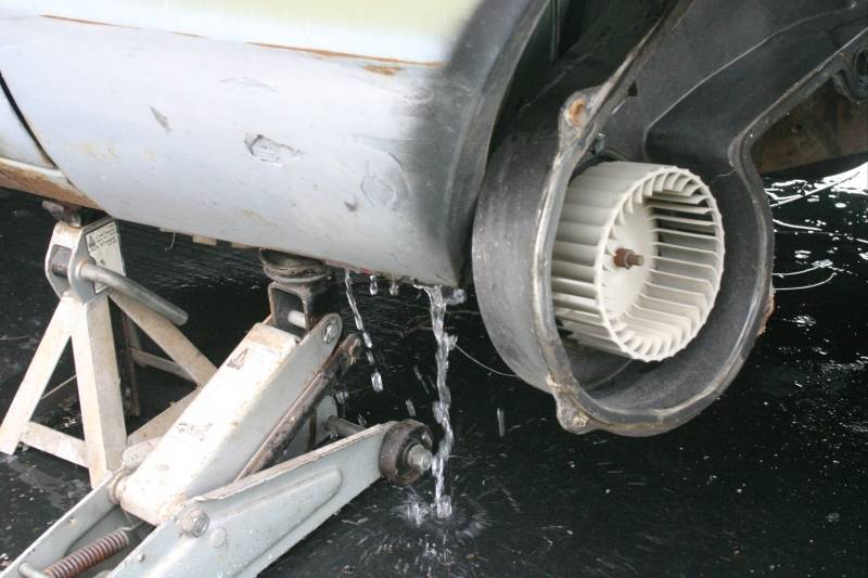

I would try to access them through the kick panel vents first, you can scoop out any leaves this way.
This was from a water test after I fixed an issue with water getting in the car.
Alan

The kick panel vents are just held in with a dozen screws, nothing difficult about it. Easy enough to do regularly just to clean them.
Alan
