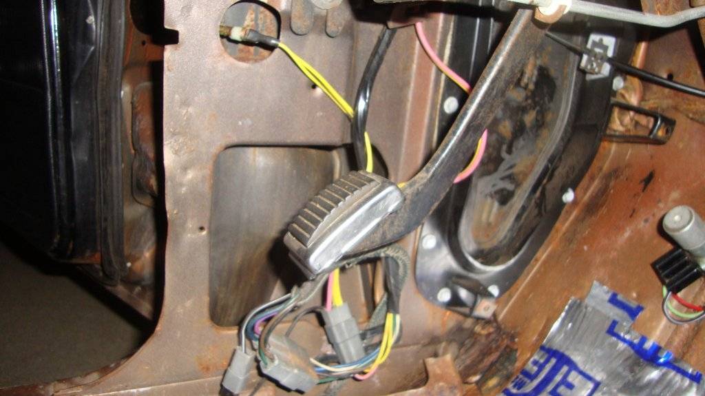

got rained out last night...going to give it a shot today.
I thought this would be the perfect time then Mario. let nature provide the water for flushing out he drains while you used your wire hanger!!:lol:
@MrMoparCHP, @mr. fix it
Alan, it seems my memory is not quite what it used to be. lol
I was combining the two holes in the drivers' kick panel. Now I see exactly what you are referring to.

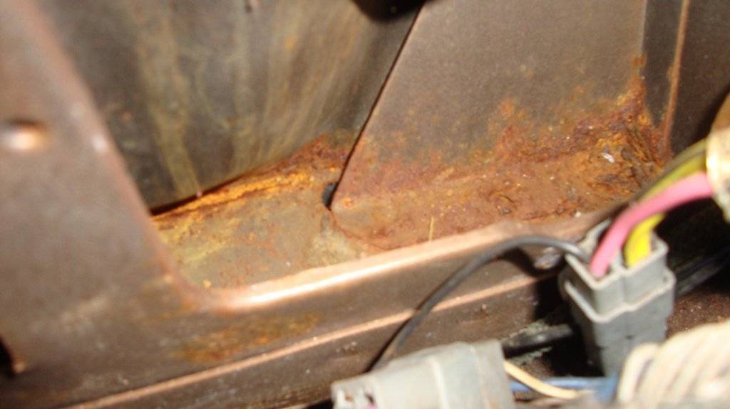

Doesn't look all that great, but I dont see any holes either...so far anyways. :mad:
Just now I went look at this and the cowl was like I stuck my hand into an aquarium! Don't know how long it has been this way but I got that middle drain all cleaned out with a long plastic stick and running water and I did the same for the openings at the bottom of the fenders and they run free though I still need to see about those hidden drains which may be collecting water. This should have been the first order of business when I got the car.:(
