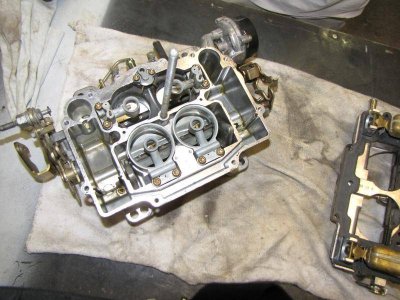

I had my helper remove the Carb, and clean it really well (thought it may be bad gas), but, I think he didn't do so great a job as I went back through it today and found the floats had been mashed down and one top plate screw not screwed in at all. So, I took it off and apart myself looking for errors to correct. Yup, needed a new top plate gasket, go to AZ and of course the only thing they have is a rebuild kit for these carbs, so, why not, do it right, right?

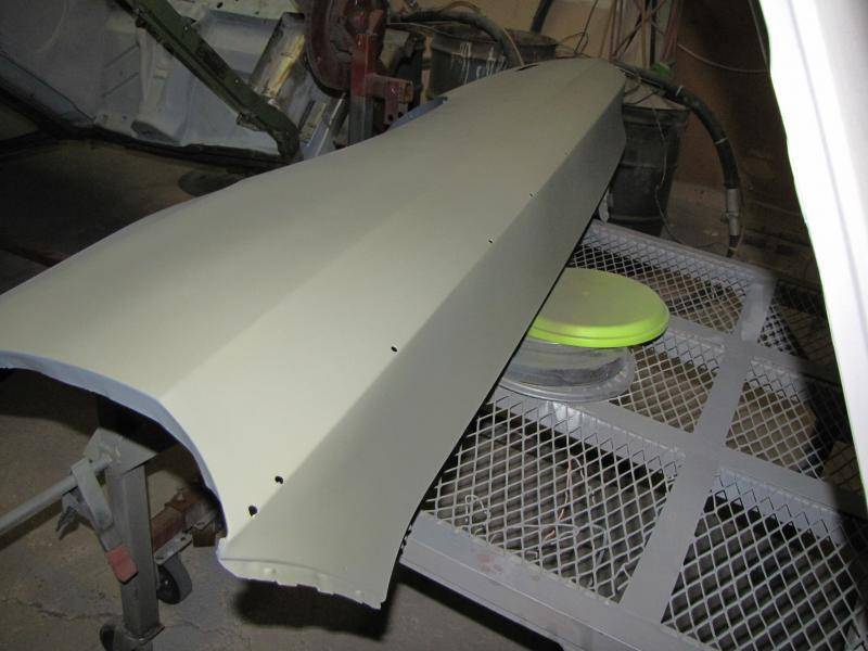

Ok, got the timing issues sorted out, and the carb off and cleaned up, car fires up instantly, every time. Got the left bank exhaust pipe system made and installed and the bad muffler issue sorted, so, it sounds absolutely fabulous, and stock! Got the donor Hood off, and the two replacement donor Fenders off too, got the Fenders media blasted and primed, the Hood is a big piece of real estate, and it serves as a back stop to my table when I conduct media blasting operations. This way I do paying jobs and get my own personal stuff done at the same time; two for one deal.

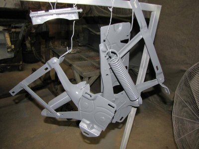

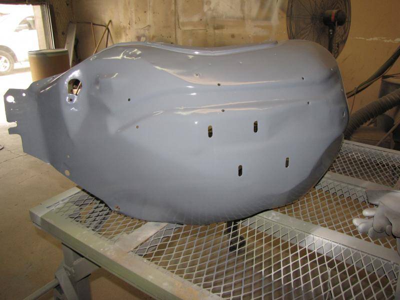

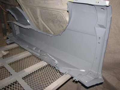

I informed my wife -- notice I didn't ask -- that this car is coming home to reside in the garage for the next few months, we have a 3 car garage with motorcycles and a Camaro in it, just a little re-organizing and it'll fit in. I am literally running out of room in my shop! Here's a few pics taken over the past few weeks.

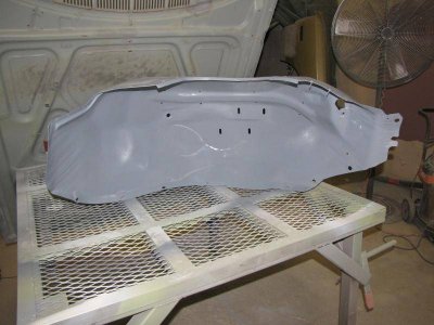

The painted wants the Fenders in Etch primer, on one Fender the inner portion I epoxied. The actual Inner Fenders I also epoxy primed (the gray color is Epoxy). One of the pics you'll see a Hood, that's this car's Hood.

Well, the Hood and Fenders I did a bit of trading with a guy who does moonlighting out of his garage, he works for musclerodshop during the day and Volvo's at night...yeah, interesting! Well, I blasted a bunch of his Volvo stuff, he Blocked and Sanded my Fenders and Hood, not all the way mind you, I guess he got tired of the stuff, but, they are straight, and ready for further blocking and sanding which I have not done -- yet! Also, a body shop across the street does a lot of side and high end repair jobs, and they send stuff to me needing blasting often, got a deal worked out for 2.5 gallons of the EF8 Sherwin Williams paint (should be enough for full coverage). Also, the upholstery shop next door classiccustomupholstery.com and I also have a deal, they send me GM seat frames all the time that are broken, I repair them. I also blast seat frames on their high-end jobs, and other stuff they need done, at no charge for them, which will equate to them re-upholstering my Seats for the 300. They've already ordered and have the material. The inner green inserts we could not find the right color material, and when I said that looks good enough they said No, it won't look right, so, I trust their judgements, and they said they will re-use the inner inserts, enhance and build the foam where it's worn out. So, this is slow, but...there is progress where funding is going to other things at the same time. Pretty soon I will have this 70 300 and my 69 Satellite coming on line and into the driving category at once! With my 70 Challenger and 69 GTX behind them! Hard to beleive I couldn't find any good and clear shots of the Seats! I will fix that today, and post some up later. Here's the best one I could find of the seats.
