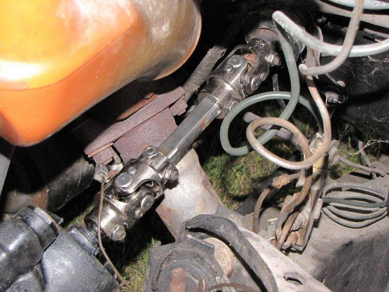

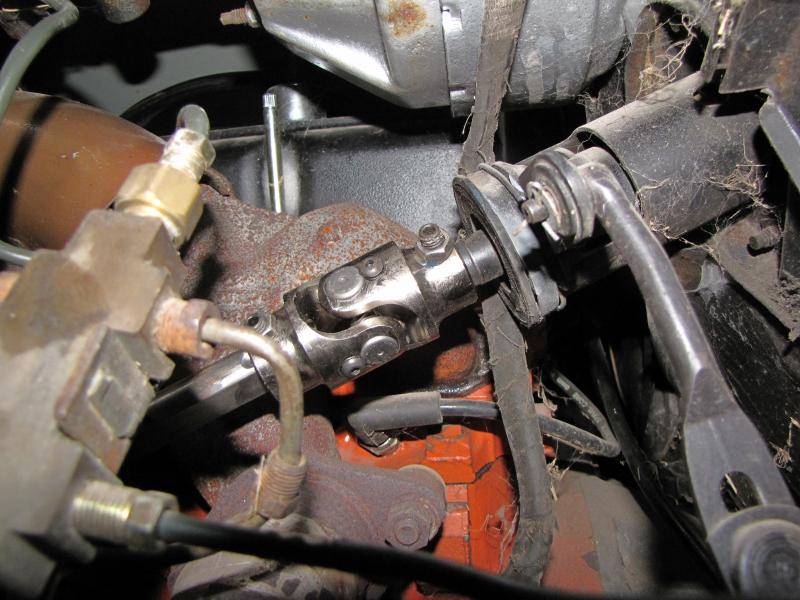

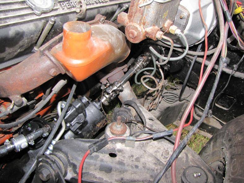

You used a u-joint kit on a Chrysler do you have a aftermarket steering column, does it have a slip joint in it.
No aftermarket column, stock one. What's a Slip Joint? I joined the lower steering column to the gear box with the U-Joint kit and shaft from Flaming River. They don't make a 'kit' for this application, I had to piece one together, but, they have the U Joints, and an 8" shaft, cut it to fit, but, don't rush, can't cut it too short. Upper and Lower U-Joints are different part numbers from Flaming River, but, it has the slightest feeling of less sloppiness in the steering -- and in these cars, anything to improve that feeling is worth it.
Nice, Donny. Did the exact same thing on my Polara & it took all the slop out, hopefully forever. The guys doing my build said that's the only way they ever do em.

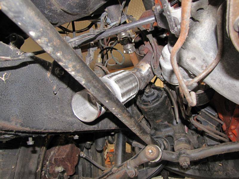

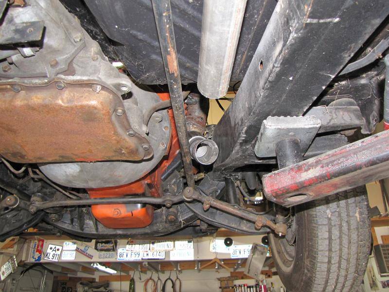

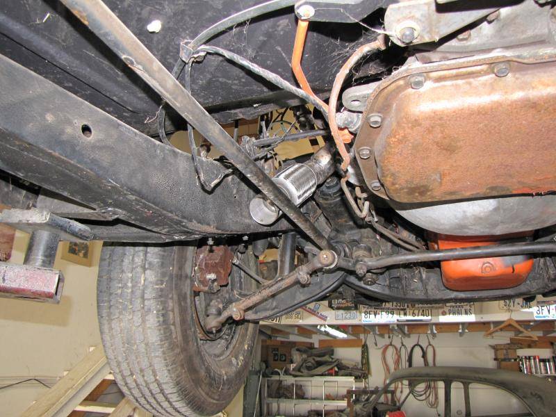

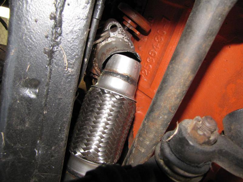

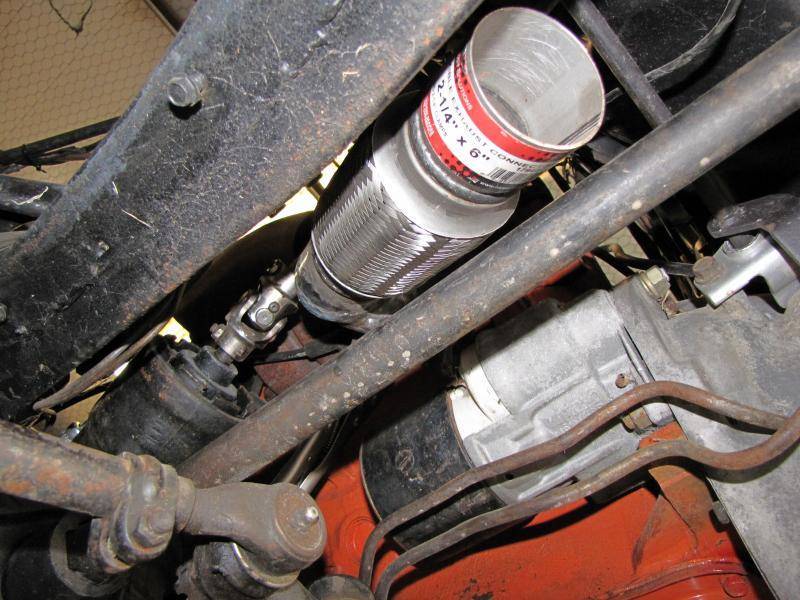

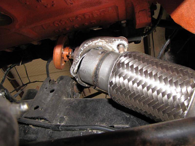

DrBlast (specializing in plastic media blasting) Follow up on this car. The exhaust system drivers side muffler is bad, had a blow out on the top of the muffler, how and why this happened I don't know, but, I know I'm rendering a solution! Also, got the new style flexible exhaust connectors which I'll be fitting them in the immediate area (like 1-2 inches from the exhaust manifold) allowing (as intended) the exhaust system to remain immovable as the engine moves in its motor mounts side to side - keeping from breaking anything!

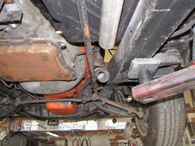

Today I fabricated in some flexible exhaust pipes to fit right off the exhaust manifolds. This car used to have a crude flexible system, but, I seemed to have tossed them thinking they of no worth, or, I can replace them later, haha, lesson learned, don't throw ANYTHING away ever! These new flexible pipes are very cool, very cool!
