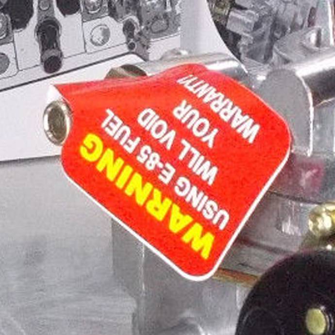

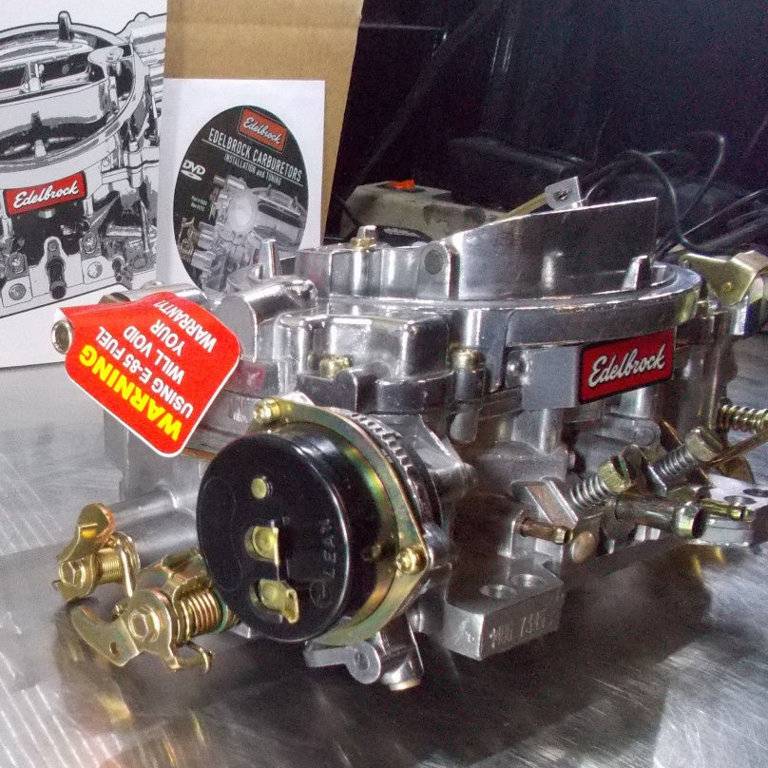

So I'm having troubles with my 51 year old Holley again so I've started to consider switching. I noticed this while looking at listings on ebay.
So much for a warranty in the day and age when it's extremely difficult to find ethanol free fuel. I've got two stations near home, but am I supposed to never take the car long distance...
That doesn't mean ethanol free, it only means E-85, regular fuel only has 10% ethanol mixed in. E-85 has anywhere from roughly 60-85% ethanol. I run regular fuel and th only part I've ever replaced was an accelerator pump plunger. Ethanol might have hurt it a tiny bit, but sitting did more damage. I wouldn't worry about the ethanol levels in regular fuel.
I have never seen an E85 warning on an Eddie carb. I have a new one in the box and don't see any E85 warning unless its something that started recently.
