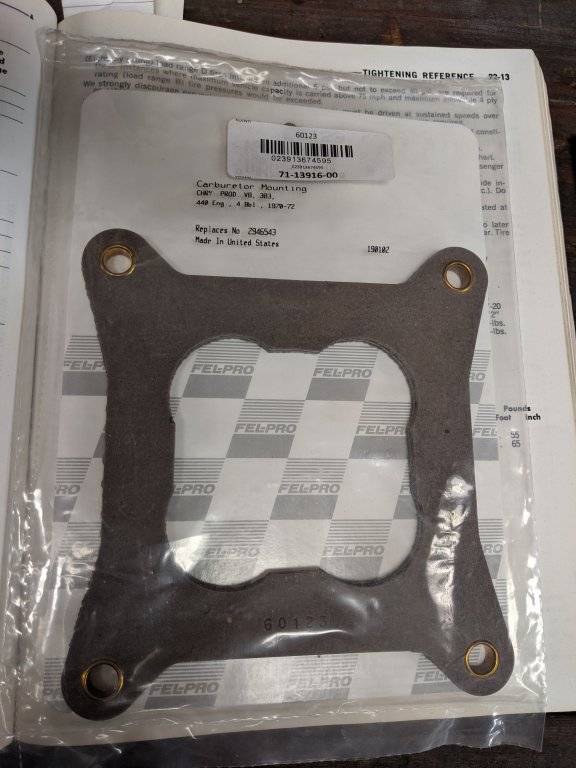

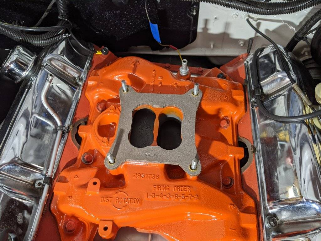

Another learning moment for me.....the secondaries dont open on the stock manifold. Both mfr and sales outlet said all good for the AFB replace.....hmmm. I have ordered an adapter riser plate to allow more room for larger throttles. Edelbrock has notes about this for ford, chevy and for mopar thermoquad....but not the AFB. Same bolt pattern, but 383 stock manifold holes too small. Do more homework than I did.
I used a Felpro 60123 to keep the AVS2 800cfm from hitting my stock manifold.
Very nice resto work. I like the gasket, and am curious whether what look like brass spacers affect compression....interesting.
I believe the original AVS carburetors on our cars were 650 CFM. This carburetor you purchased is 800 CFM so that is probably why the secondary throttle blades do not fit.
I suspect they used soft malleable metal to control compression such that the gasket/spacer is not distorted.
