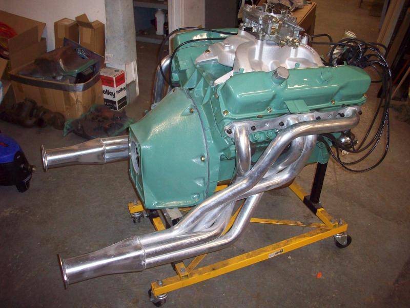

all 62 361 and 383 were turquoise. go to mymopar.com to print off a complete list of all mopar motor colours from 1960 to 1974. rexus 31 looks a little too blue but it could be the lighting.
this is turquoise.
Duplicolor and Bill Hirsch are both good choices. I've used both. 2-3 cans of duplicolor or a pint of the Hirsch product thinned.
The color name is Chrysler turquoise. It looks more blue when fresh but has a tendancy to lighten up after a couple of heat cycles.

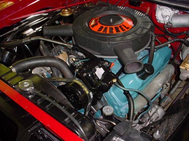

Just wondering. Were'nt there noticible differences in the original hues looking at different engines ?
I know from one employee of a GM Europe engine plant who used to mix together leftover body paint into the engine black which led to bluish black etc. tones. As Long as it appeared to be mostly black it was considered o.k. ;)
