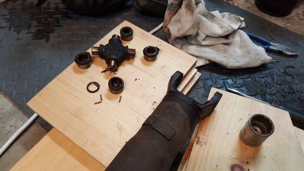

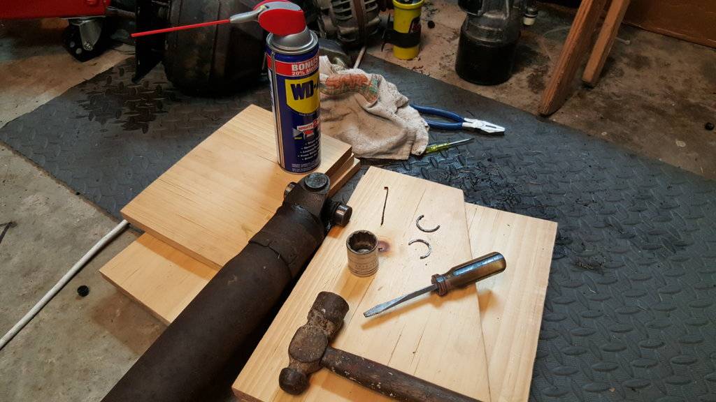

tonights task - pull a ujoint.
tools required:
1. with flathead screwdriver and firm hammer strike on either edge of the C, remove c clips from inner side of pressed-in joints. throw a towel under it to catch the clip from flying.
2.) place blocks of wood so the driveshaft is up off the ground - resting on the loose ujoints
3. with 1 1/8 socket, put that over the pressed in joint, and smack it. it will pop one of the caps out.
4. flop it over and do the other pressed in joint.
I think u joints are cheap enough to replace, but what I read is if there is any wear on the joints, or if it does not spin well, trash it. I'm not planning on keeping this one so w/e, but I guess you can repack them and reuse them if not worn.

When you reinstall the U joints be extremely careful not to let any of the needle bearings fall out of place. If the cap will not go on completely, or the joint does not move freely when installed, take it back apart and reinspect.

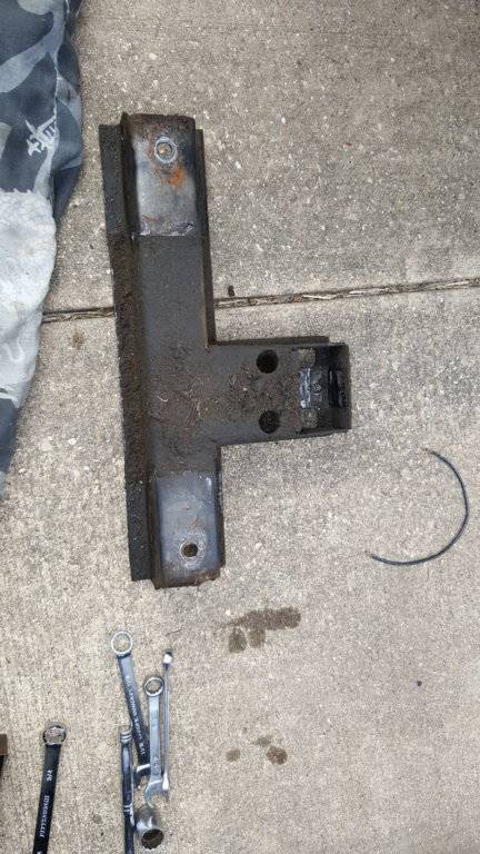

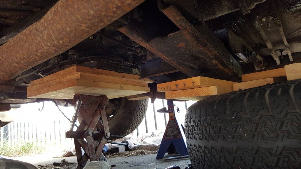

today i finished pulling the 383 out of the white fury and then we dropped the 440 in. motor mounts and crossmember went in, hood went on, and we called it a day. its 96* and the feels like temp out in the driveway is 6 gorillion.
one note on the crossmember R&R - i did choose to unload the torsion bars, as trying it under load felt like some of the crossmember bolts were under strain. on the flipside - trying to stab the new transmisssion in, it would never worked with load on the torsion bars nothing would have lined up. so undo the loads on the torsion bars before removing the transmission crossmember.

Good advise, explains why my crossmember was a bear to get lined up.
something I noticed and need - at the transmission on the side of the housing is a spot where a shift bar goes thru a hole - what is this piece? I needum. this one is toast.
