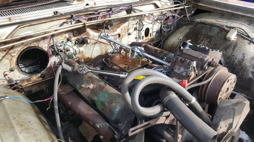

starter out
I'm about to hook up the load leveler.
I was going to put it on the 4 corners of the intake.
my homeboy said its supposed to go on the block and there are predrilled holes already. but he is a chevy guy. but I told him id ask the forum before I rip off the intake when I try to lift.
where do I bolt the load leveler?
thanks -
- saylor
