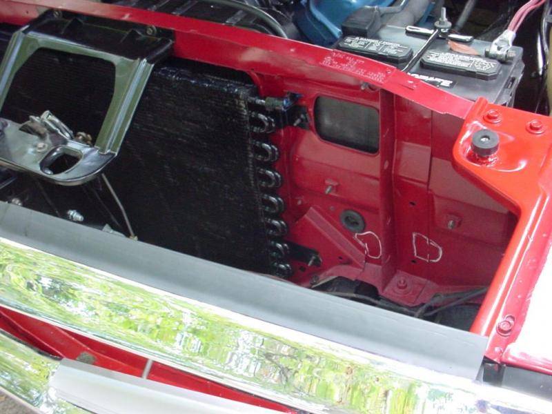

I had my painter paint and clear the core support then I scuffed and shot it with flat black (spray can, unmasked) to mimic the factory look. I went off photos I took prior to taking the car apart. You can kinda see it in the pic below. IMO, I wouldn't want a masked, clean line there. This "spray bomb" on the assembly line probably took all but 10 second to apply. It was applied to black out the grill.

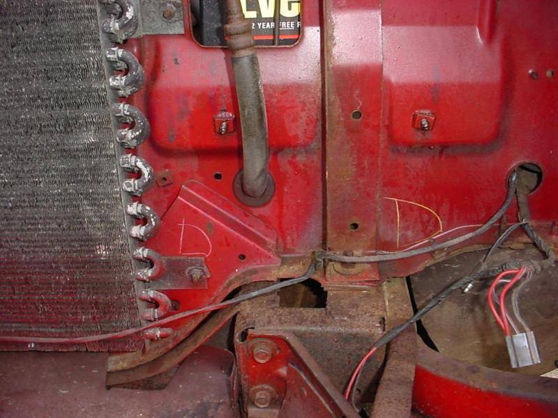

I left the black off when I refinished the car and even redid the factory grease pencil marks..... I have no idea what they mean.

Yeah, I know it's not a real clean line. I told the painter that as well. Thanks for the photo, so is the front of the core support the only black?
I can only speak for my car. The front of the core support was blacked out and the outer part (closest to the wheel) of the inner fenders were black as well.
In your case the DD stands for Daily Driver I guess. :)
