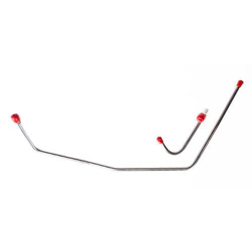

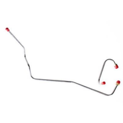

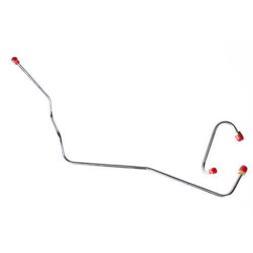

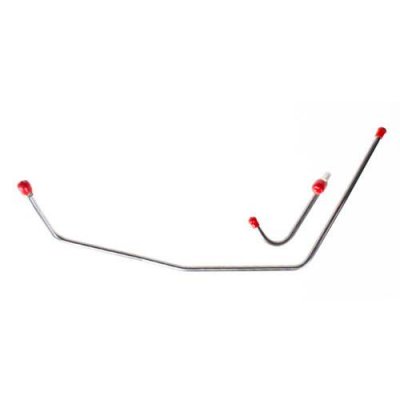

After doing some research the carter afb 4 barrel has the same setup as the edelbrock. I looked up the fuel line on jegs for afb 4 barrel for 68 chrysler and they have the fuel line pre bent for $20. Here is the link http://www.jegs.com/i/Right-Stuff/965/RPC6810/10002/-1 or this one http://www.jegs.com/i/Right+Stuff/965/RPC6601/10002/-1
