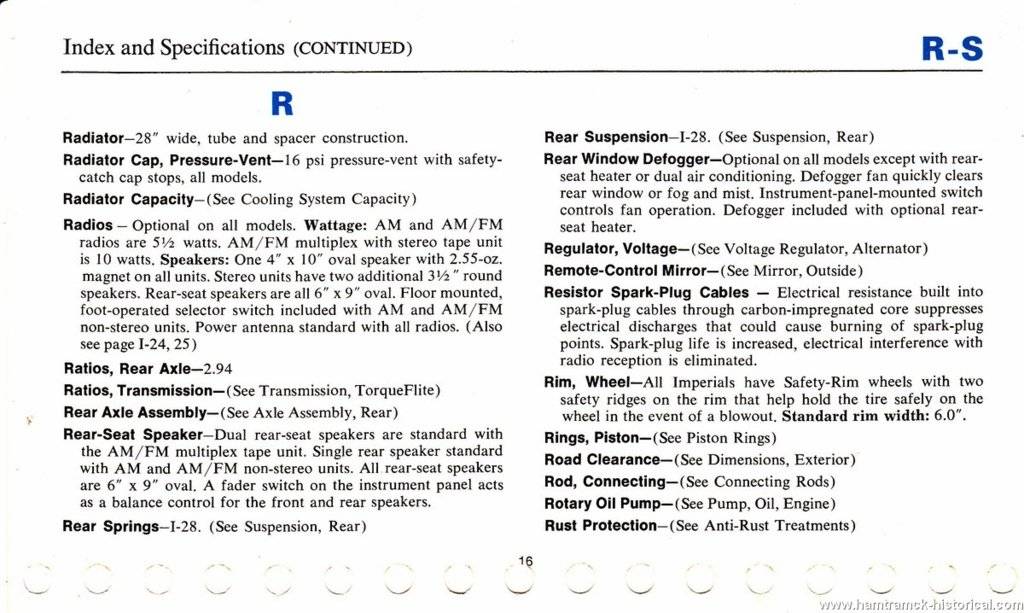

The 2.94 was std in the Imps for at least a couple of generations.

2.94 was standard in the Imperials for years.3.55 was the optional gear ratio for 4 Speed and some automatic equipped cars. Usually found with big block engine with a performance nameplate. 440HP, 426 wedge HP, 426 Hemi and some 383HP. This ratio also used on some 340 equipped cars
3.23 was the standard gear ratio for all of the above and was a widely used gear ratio on most standard performance cars up to the early '70's. Also used on many of the large C-Body cars as standard gearing.
2.93 was a standard ratio on many cars thru the mid to late 1970's where more economy was desired while still maintaining some performance potential. I don't think there was a 2.94 ratio in stock factory mopar gears.

My 71 has a 3.23 SG. I don't know if the original owner ordered the car or if it was off the lot.2.94 was standard in the Imperials for years.
