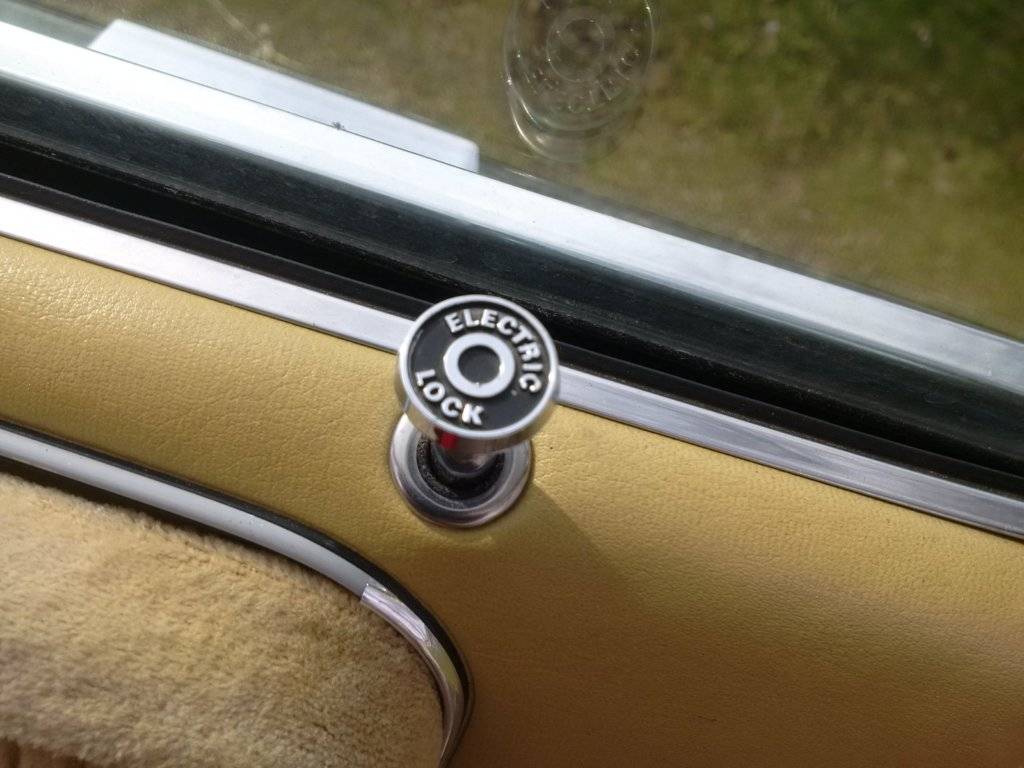

Great reply....Funny thing is...and I know this sounds really stupid....but I assume there is no separate "lock button" but just simply the knob you raise and lower manually to lock the door. My windows are manual. The noise and slight movement the other door lock knob makes when you raise the knob on the drivers' side door (don't know if it works the other way around) is the only reason why I thought this was some sort of automatic system. Are we saying the same thing?
If a door lock other than the one you are touching at the moment "makes noise" you have electric locks. These are on my '76 Dodge. If I raise/lower either of the front door knobs, all four will actuate. Only the higher priced NY'ers and Imperials had separate switches (as are common today). Your knobs should look like mine, but it's possible someone could have swapped them for the more common plain knobs.
Power windows and locks were available independently, which seems weird now, but was common back then.
