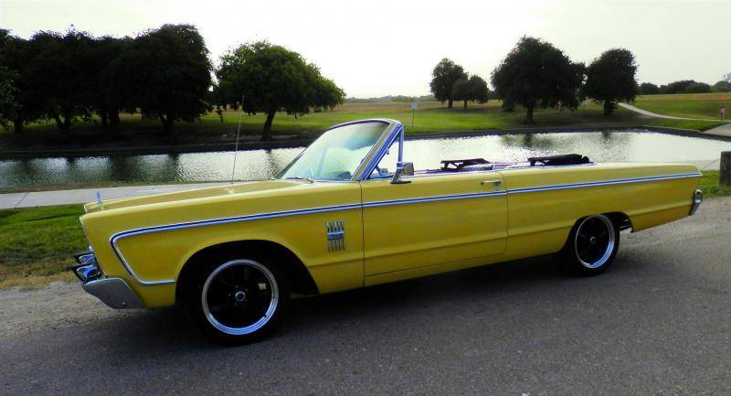

Fury1.jpgOk, 3rd post, I scoured 10 pages of archives with no luck. I have low beams...most of the time, no high beams at all. Bought new dimmer switch, same problem. Put ohm meter on both switches, they both checked out ok. Did same on both high beam lights, ok there. Also, left turn signal works until I hit brakes, then indicator stays lit, right side ok. Gotta be a ground issue, just not sure where start looking??? Only had car for a week, but man I love this car already!! Kel

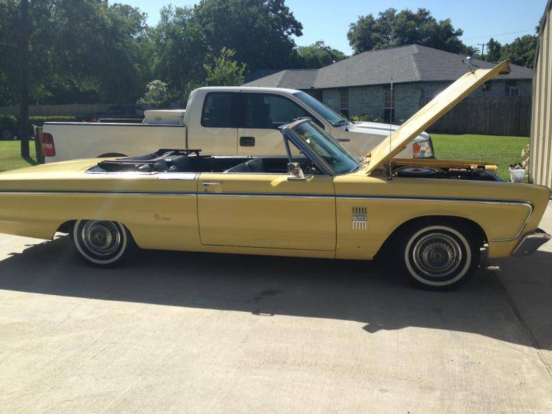

Several issues fixed tonite...
1. Both front turn signal light sockets corroded real bad, fixed. That helped with turn signal issues.
2. High beams fixed, after checking all lights, I also noticed that my new after market stereo I installed kept kicking off/on while driving...figured gotta be a ground issue messing everything up...with stereo on, I moved wires in bulkhead panel, found that several terminals were corroded. Cleaned that up, now stereo works all the time, and all lights work. Very happy camper now...time for an evening cruise..thank fellas for the help! Kel
