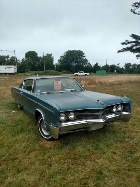

Thanks man, sorry i dont know how to attach photos here im still trying to figure it out. The paint was like sand paper before i clay bared it. I couldnt believe the difference that it made. Then I did a medium and light polish followed up with a wax. It took me an entire day but the paint shines now and looks brand new and feels it too! I determined that it was re-sprayed the original color at some point in its life but not recently. When i bought the car it still had an inspection sticker from 1993 on the windsheild.
It was garage kept by a doctor here in RI and the car has almost ZERO rust or rot. The only place is on the rear bumper where water accumulated under the taillights. It has quite a few dings on the body from other peoples doors but it is incredible condition for its age. 97k miles and I am the second owner at 26 yrs. I plan on cutting out, welding and blending in the rot on the rear bumper. Sending all the brass out to get re chromed. I just got the front seat re-upholstered yesterday. I want to fill all the dings in with body filler because i dont think ill be able to pull them out, then re-paint the car the original metallic blue or teal it was painted. Then im just going to drive it around everyday so everyone can see how much fun im having getting 9mpg

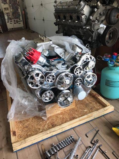

This is what I'm doing with a 400.....
Holy SMOKES! I don't even want to know how much that belt system costs. Someone has deep pockets
Edit: that thing is super cool though. Specs on the engine?
