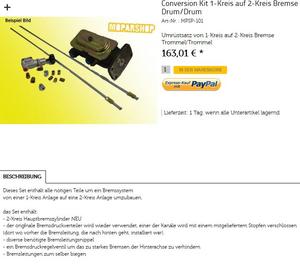

"Dual chamber MC" was the first thing I thought after crashing into the wall. Well, not the first thing, also not the second...but before I got out of the car, I knew, this will be installed:
("Conversion kit 1-circle- to 2-circles brake drum/drum").
$163 euro seems like a lot of money to pull this off. read the articles on this forum about swapping brake stuff - I think we can get this done cheaper than $163 in the ad you posted.
try not to die -
- saylor
it looks like a drum/drum MC, a couple of new brake lines, and a prop valve.
i say you can for sure get this cheaper than $163 euro - even with shipping it to FDR.

Replacing the master is pretty easy. I'd use a dual M/C from a 67 and up Chrysler. There's no proportioning valve in these systems. They did use a distribution block with a warning light, and it does make the plumbing a little easier if you use one.
