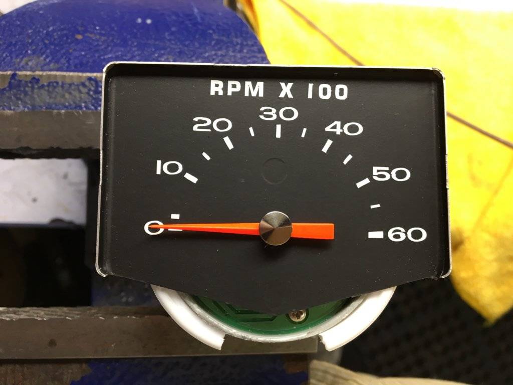

now that would be a big help. I got as close as I could from pictures of factory tachs. I started looking in Hobby shops and craft shops but I ended up at wall mart in the wall clock department for a great looking stainless button. Even a aluminum button would work.

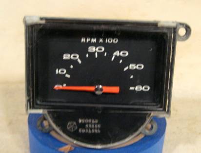

No measurement but here is a picture of mine if it helps.
Well I think mine might be a fraction bigger but when it’s mounted in the bezel behind a lens it looks good enough for my dash.

There is a bit of tweaking needed on the graphics yet I see but that shouldn’t be an issue. The dash before the numbers should be thinner and a bit longer and the RPM X 100 should be smaller.

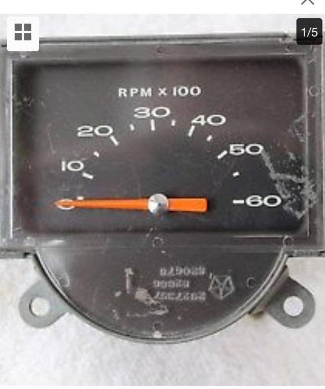

I did find this picture online hope it helps..

Not to criticize your effort but your numbers are just a hair off. If you run a ruler under the 20 and 40 you’ll see that your a little high on yours versus the original. Also the font size on the numbers is just a little bigger on yours. Agree that the RPM x 100 text is also too big.

Otherwise..... perfect.
