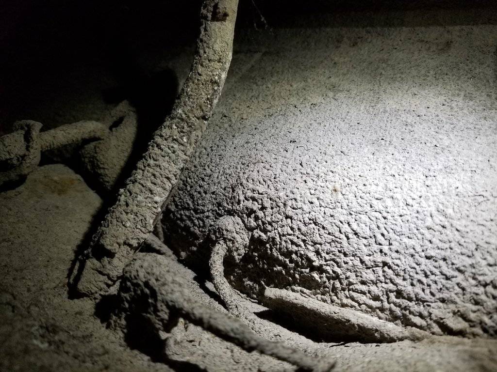

70BBD suggested starting at the tank. I liked that idea until I took a look under the car. It does look like the original hose is still on there, and there is a super tough coating of something all over that area. It will be a real pain to pull the sending unit/pickup and replace the hose. But I think it is probably necessary. It seems to me that maybe the mechanical fuel pump that is on there is actually OK and the problem is at the tank. When I got this car there was a new looking carb with the choke wired in the open position (electric choke not hooked up), the kickdown linkage was disconnected and laying on the intake manifold, and this electric fuel pump was jury-rigged into the engine compartment. They must have been having fuel issues and there are still fuel issues. The tank area is the one untouched link.

That mess all over everything is undercoating that is supposed to slow the formation of rust. It is a major pain in the butt to remove as it is usually asphalt based with fiberglass strands.. Some manufacturers also used other fibers which may be toxic. As noted in the previous post, low vac is an indication of a leak someplace in the supply line from the tank or the pick up tube inside of the tank. High vac is usually the result of a clogged pick up filter on the end of the pick up tube. Note that a defective fuel pump will also cause low vac.

That undercoating looks more like it came "after production" to me. It might be oil-based, but that oil has probably dried-up somewhat so it might just flake off with a putty knife. Especially if it was not reasonable clean when it was applied.

I was surprised to see the undercoating. It is not obviously visible on other parts of the underside I have visited. It is on top side of the tank but not below the seam. Maybe it wore off over the years where it is more exposed. I can barely scratch it with a putty knife. Normally I would try heat, but obviously can't do that here.

Sounds like a good plan to me. Leave the undercoating as is. unless it interferes with tank removal. Remove and cut open the fuel filter to find contamination. Will also give you an idea what the inside condition of the fuel tank is [ rust dirt ect. ]
