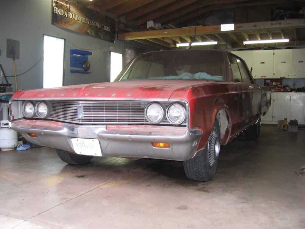

The only parts that swap easily are from the 68 New Yorker. I prefer the NYer grill and frankly if I were to buy a 68 Newport convertible it would end up with NYer grill and tail lights. Just my preference. Personally I think you've picked a very sharp car.
When you said it will be going off to the lift to go over the brakes will you be doing the work or someone else? When I did my NYer I found that the bleeders in the wheel cylinders were metric, urgh.

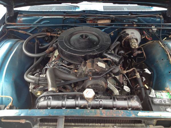

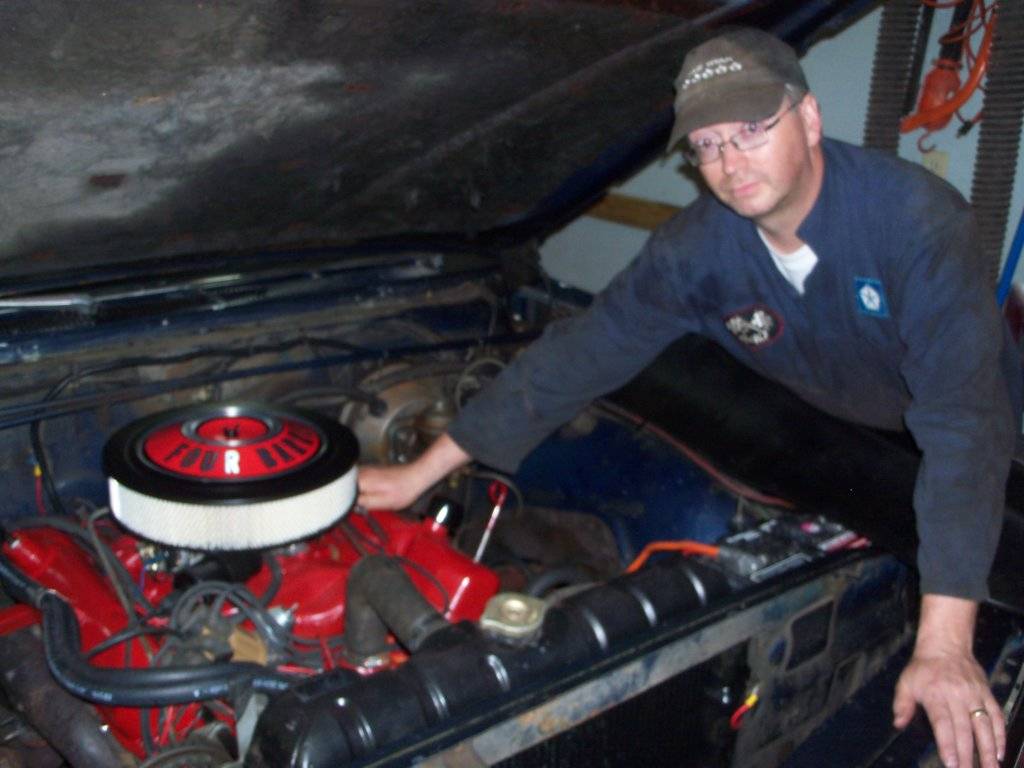

Also I looked at the under hood picture you posted I don't see anything there that shouldn't be there. I would be an FSM and start reviewing it before removing anything. You don't want to make any headaches for yourself.

I'll be doing most of the work myself. I'll be downloading the FSM shortly, right now I'm weighing options of transporting it.

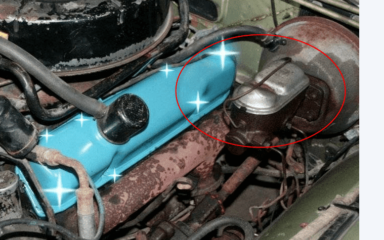

I forgot to mention that it looked like the master cylinder on your car is a disc brake master. Toward the end of my thread you'll see that I had issues getting to brake correctly because someone before me put the wrong master on it.
Yeah, mines a 4dr sedan, but mechanically they are pretty much the same.
From what I read in the post regarding your MC, mine is correct for drums, 2 equal sections.
The one you posted has 2 different sizes sections:
The one on my car-to-be has equal sections .
Two equal sections is a drum brake MC. When you get that far, wiper motors were not painted in most cases from the factory. They had a natural metal finish on both the motor body and the pot metal gear drive assembly Many rebuilt units were painted flat black. Brake boosters were typically a flat matte black although some had a natural metal finish also.
