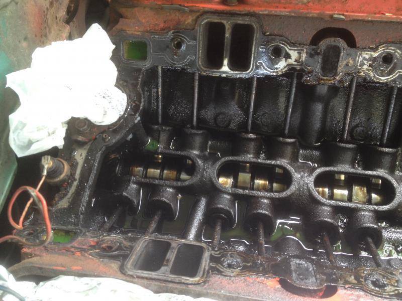

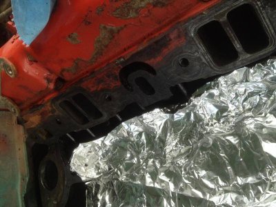

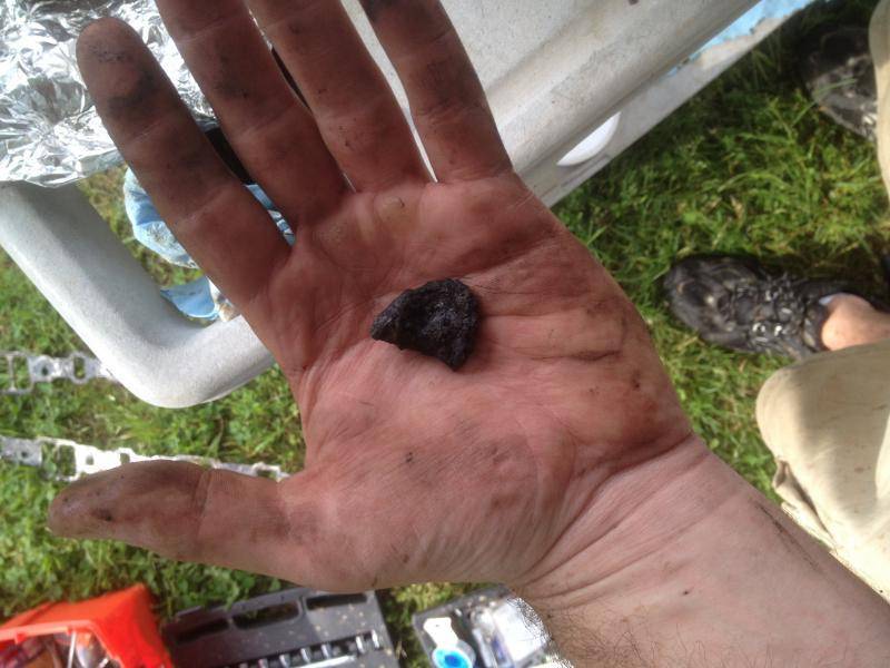

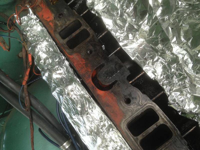

What shocked me was how the ports in the middle where completely clogged on both the intake manifold and the head. Before, after and a chunk of the carbon deposit that came out of the intake!

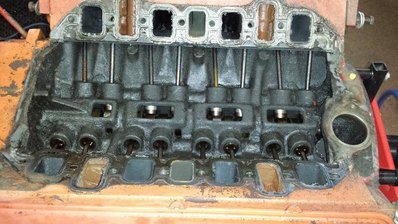

Here is a shot with the intake manifold removed. Any idea what the scoring on the lobes is from?
The real test for leaks will be a couple of hard acceleration runs to see if the seal leaks oil on the rear of the manifold. If it does leak the oil will be running down the txsm and all over the exhaust under hard acceleration runs.
Unfortunately that is from a lack of running the engine enough & enough oil changes...
All engines love being run for long periods of time.
A short run to the corner store will do this to an engine.
Raw gas builds carbon then washes into the cylinders then turns into carbon because the engine never gets hot enough to burn it off.
The carbon build up results in scoring of the internals
The recommended frequencies for oils is say about 3500 miles or 3 months on these older engines but I am sure not many here do that.
Change the oil out every 3 months regardless of the mileage and this should slow down further wear & tear.
I also use the Lucas oil treatment as well.
Be careful of any cleaners for oil as this could knock carbon loose and plug up the oil pick

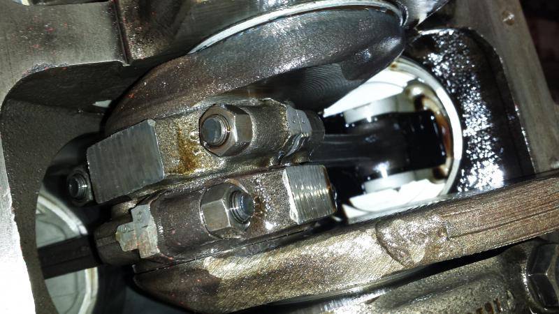

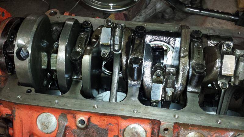

Now, here is a shot of my new to me 318.
Oil change interval between 500 miles to max of 2100 miles. avg 800 miles or 3 months.
sorry no shots of the intake area.. I thought I had some but missed that... it was like new..
These are of the bottom end
Other than cleaning the oil pan gasket off I touched nothing. Didn't even wipe it down...

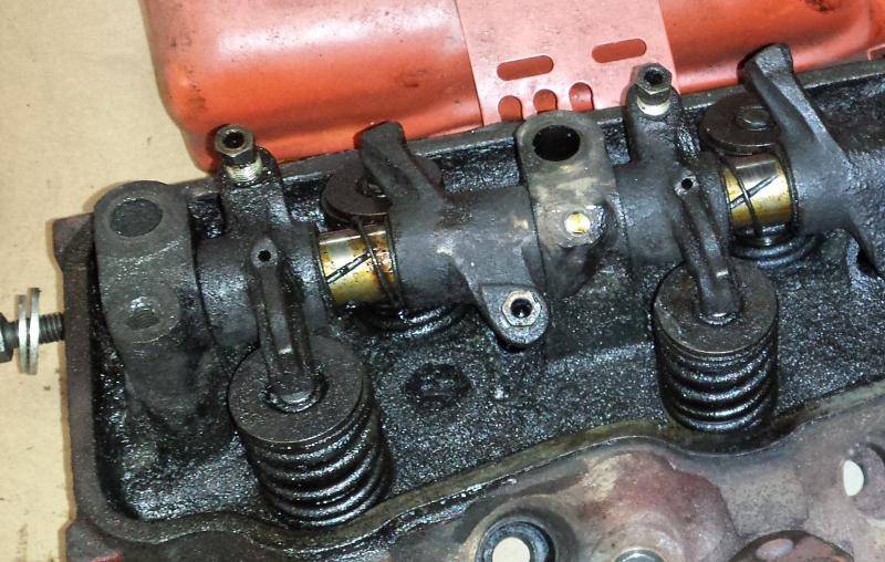

It is sludged up.
Maybe not as bad as some engines but sludged up still the same..
If any of that is disturbed it could end up in the oil pick up reducing oil pressure & starvation.
Sludge in an engine will cause all sorts of issues including hot spots in the guts of the beast which shorten engine life..
the examplt I used was not as bad as some. here is another of my old engine in the rocker arms..
this stuff kills engines and you have to be careful how you remove it.
The engine cleaners can kill the engine as well if you are not prepared to remove th oil pan to clean the oil sump pick up after using them.
This of course is dependent on how much sludge has built up in the engine.
