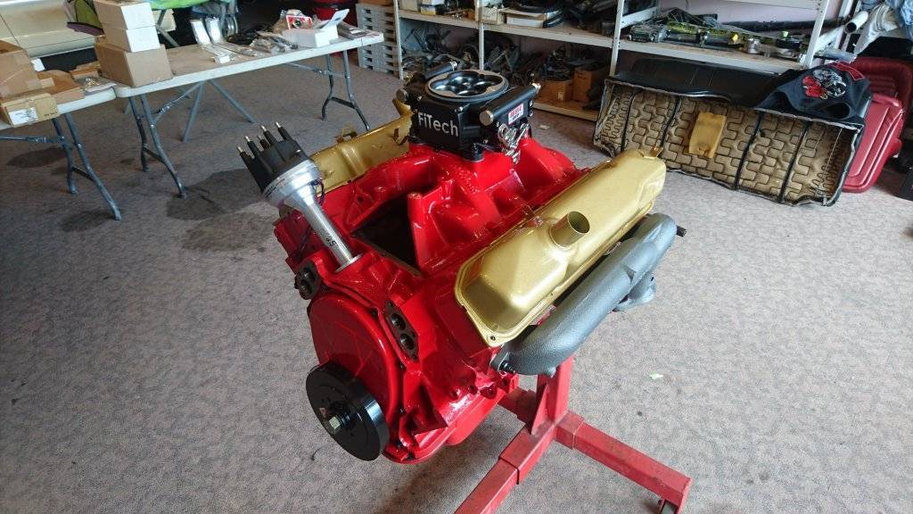

Here is the Fitech mocked up on the 383 I built. Will be dropping it all in this weekend.

Looks great! Are you planning on letting the Fitech control the timing, or another ignition box?
For sure let us know how it turns out!

Yes I am running a locked out MSD distributor and a 6AL box in order for the Fitech to control the timing. Will see how that works.
